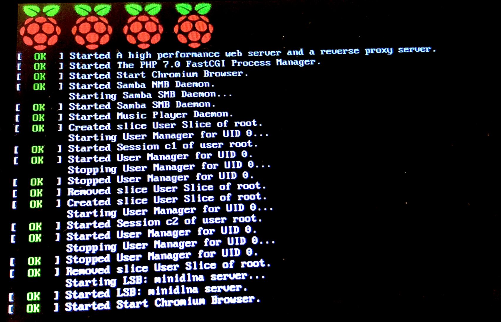

White Screen

Hello Veazer,
my main Problem is, that i didnt have any Ethernet connection on my PI.
It is installed in the CAR and only Wifi must work.
But when no ETH is connected i have two major Problems:
1. longer Boot time, 1min without ETH. With ETH it Boots in 39 sec.
2. When the start Screen from Moode comes UP, it is only white with no Cover Infos or Title Infos. After a manual Refresh everything is back again.
Because of this Problem, i am looking for a solution to make the boot faster and showing the correct Screen without having to press refresh.
In the Car it is not a good idea to press this tiny buttons to refresh the display.
Best Regards, Mirko

Bug is fixed in upcoming moOde 4.1 update.
Great!! Thank you.
Best Regards, Mirko
