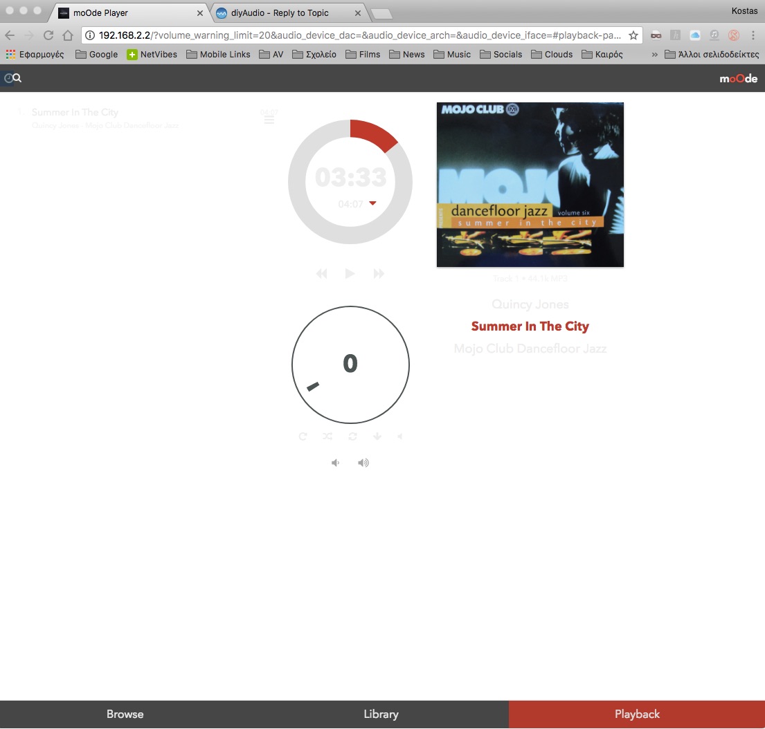

UI crash
Hello
thank again for the great work
I installed version 4 today.
However, it presents me with the following problem I did not have with previous versions. Everything in my browser looks white so I can not choose music. Do you know why this is happening?
Hello
well that's weird because it only happens when I get access to moode via macos or iphone. But when I access from a windows pc it somehow everything seems normal.
Do you have any idea why this is happening?
Clear Browser cache and history.

Clear browser cache, reload. If it still happens reply and we can go from there, but the clock radio indicator is in the wrong place which is a pretty good indication the css file is the wrong version.Hello
