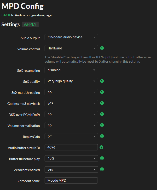

So, after trying to play with the bluetooth dongle and failing, I'm now not able to play anything. I disabled bluetooth and set audio output to the onboard audio device, but no luck. Whatever I do, mpd tries to output to bluetooth. I checked /etc/mpd.conf and I still have audio_output set to bluetooth. If I remove those lines and restart mpd, I get "ERROR: All audio outputs are disabled".
my mpd.conf looks like this:

Also, I attached scrennshots with the settings in the web UI.

How are u able to log in as root since its completely disabled in Raspbian Stretch?
