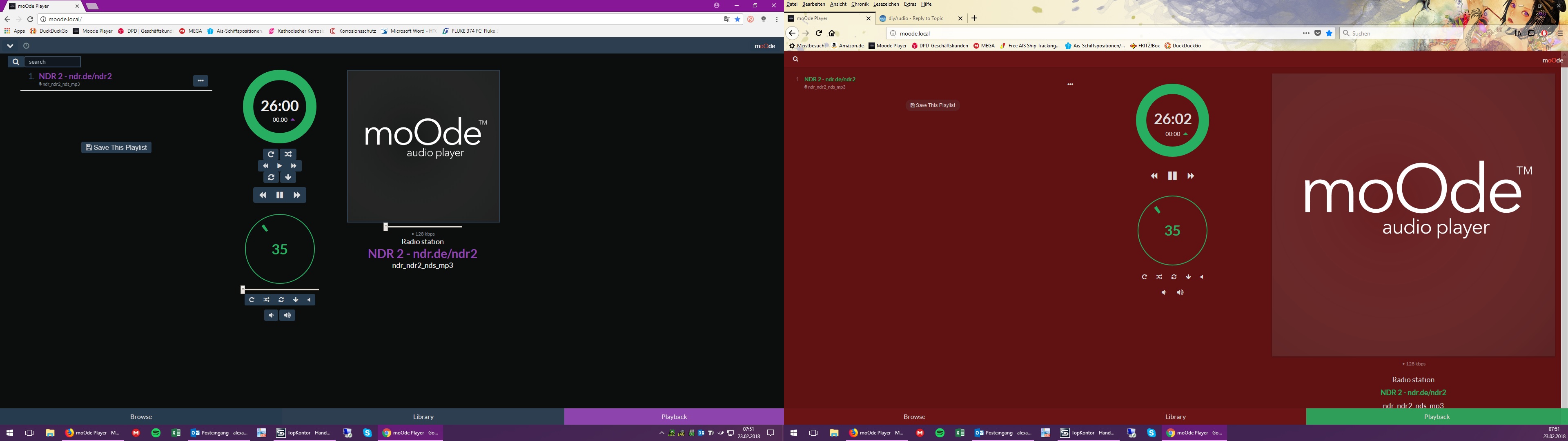

So I finally got it to work, don't know why in the first take it didn't do anything. Had to freshly install twice thoug, the first time the audio quality was absolutetly horrible (Pi2B as office Radio, on board output), but after the second time it now works as good as before. I really love the new look and colour options, but they still seem a bit buggy for me. On Firefox it all works great, except changing the accent colour does nothing, it stays green/emerald. On Chrome it doesn't change colour at all, and the interface does not look quite right. But I will just stick with Firefox for now, and at least we have music here again, so no mad colleagues anymore ^^
Thanks to all that helped :up:
P.S.: attached a picture of Firefox and Chrome using Moode.

After you have made your UI changes are you then refreshing your browser and /or clearing it's cache...😉
The lefthand image is without cache cleared.. 🙂
Clearing the browser cache and reloading should fix both problems. If it stays emerald and that’s not the accent color you have selected switch the accent to emerald, update, refresh, then switch to color of choice, update, then refresh.

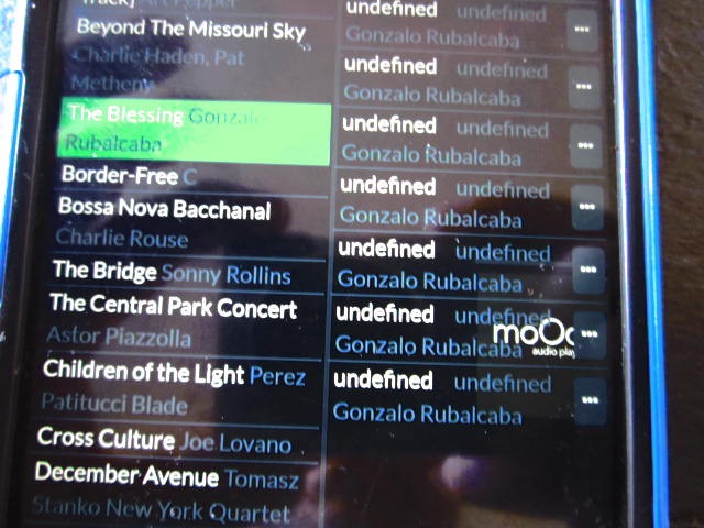

Am curious about the webpage display. I commonly use my smartphone to connect and now when I see the Album name and artist on the left column, on the right all the tracks on seemingly every album are "undefined undefined" and then the correct artist name. The cover art is there but overlaid by the track listing.
Is this in the library view? Can you post a screen? It sounds like the library arrays aren’t getting populated correctly but if they are for your laptop then I’m not sure what’s going on as it uses the same code path, it just uses css, mostly, to make the output more mobile friendly.

Yes it is Library view. In the photo, towards the bottom right you'll see the Moode Audio logo which has been overlaid by an undefined track. This used to be on the bottom of that column. It would normally display album art if that was present. This is on an LG G3 smartphone.
Thing is, in 3.8.4 I would be able to touch the album art image and then select clear/play all (or words to that effect) and it would clear the current playlist and load all album tracks. Since this is being overlaid by a track info, I cannot load a single albums tracks at once. Which is bad news for me. Hoping that the album art frame can be relocated once again to the bottom.

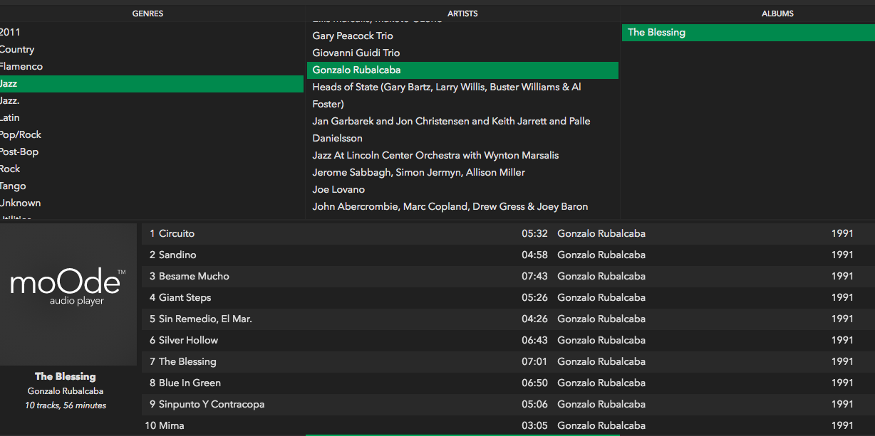

For reference, I have another screen shot from my laptop which shows that the metadata for track name an number are present. I don't know why the are showing as "undefined" in version 4, because they used to appear in version 3.8.4.
Hope that explains sufficiently. Thanks.
Your mobile is showing the old UI which suggests stale Browser cache.
