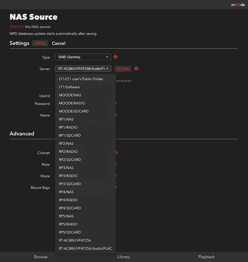

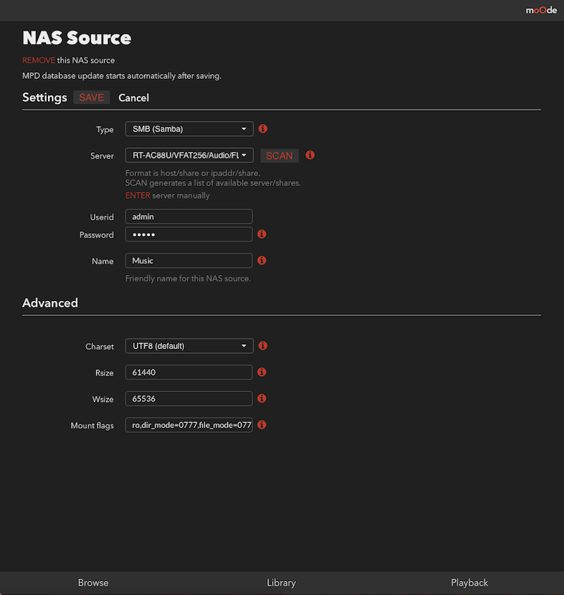

Upcoming moOde 4.1 release includes a newly designed NAS config that provides a Samba scanner for easy NAS connections :)
There is also a companion smbscan utility that can help in troubleshooting Samba networks.
-Tim

pi@rp3:~ $ /var/www/smbscan.php
Scanning Samba network...
Parsing scan results...
host_name: LT1
host_desc: LT1
host_addr: 192.168.1.26
smb_share: LT1 user’s Public Folder - No description
smb_share: Software - No description
host_name: MOODE
host_desc: moOde SMB Server
host_addr: 192.168.1.113
smb_share: NAS - NAS Shares
smb_share: RADIO - RADIO Stations
smb_share: SDCARD - SDCARD Storage
host_name: RP1
host_addr: 192.168.1.170
host_name: RP2
host_addr: 192.168.1.196
host_name: RP3
host_addr: 192.168.1.169
host_name: RP4
host_addr: 192.168.1.155
host_name: RP5
host_addr: 192.168.1.88
host_name: RT-AC88U
host_desc: RT-AC88U
smb_share: VFAT256 - ASMT 2115's VFAT256
pi@rp3:~ $

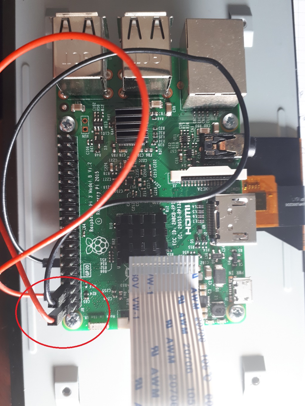

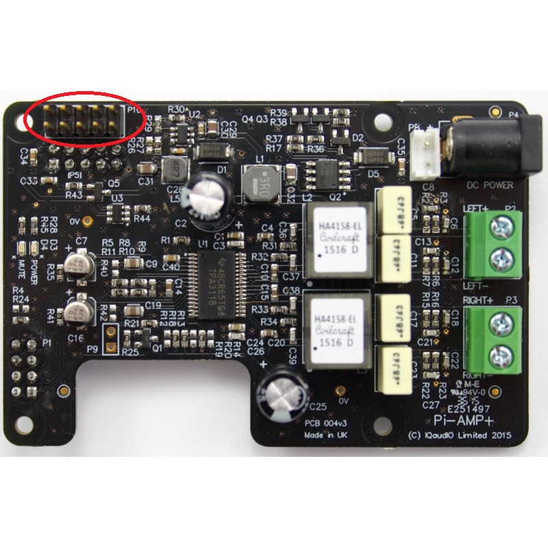

Hi, I need help with powering 7” Touchscreen Display after mounting Pi-DAC+/AMP+ combination on raspberry PI3 and I cannot find anywhere which pin is for power and ground on AMP+. Previously, I connected wire to Raspberry PI 3 GPIO pin 2 for power and the other one to pin 4 for ground.
Kind regards,
nmuzic
-Tim
Tim, this looks terrific.
@everybody else - FYI - This utility will work great as long as your NAS is advertising its IPC$ service. Otherwise, even though it may have mountable shares they won't be discovered by the smb tools which underlie Tim's new function [Don't ask me how I know:rolleyes:].
Thankfully, Tim has included the opportunity to configure such shares manually (just as we can enter an SSID manually in Network config) so you can enjoy the music while you fix permissions in your NAS.
Kent
