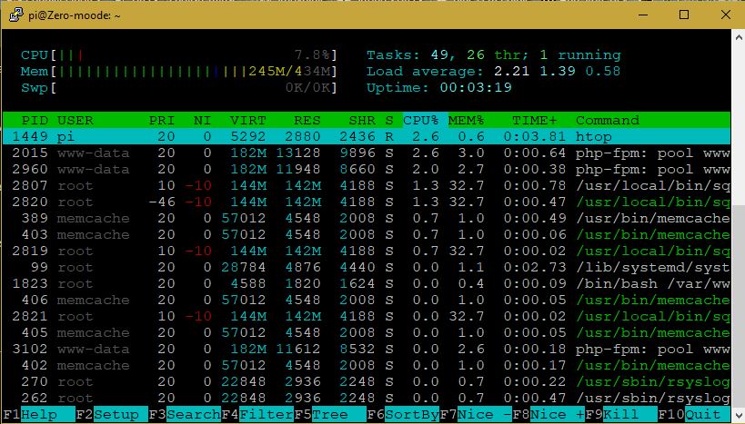

I am surprise to see you have such a low memory usage. This is my Zero W after boot up with all services turned on. If I turn on EQ, it will eat more memory and eventually hangs. But it is still on 4b12 and could be just bad a build. I'll try a new 4.0 build.
