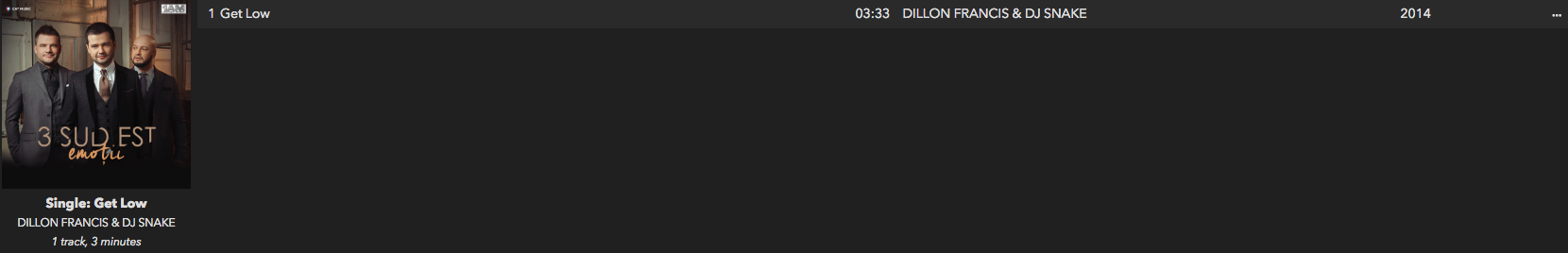

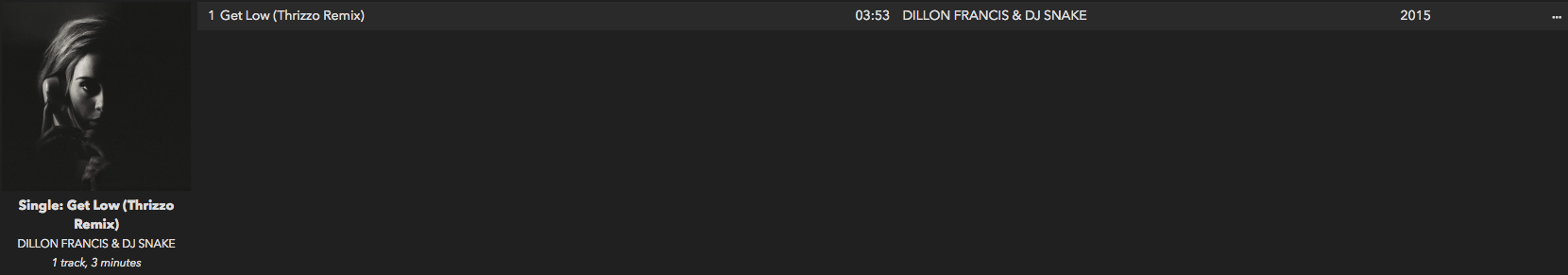

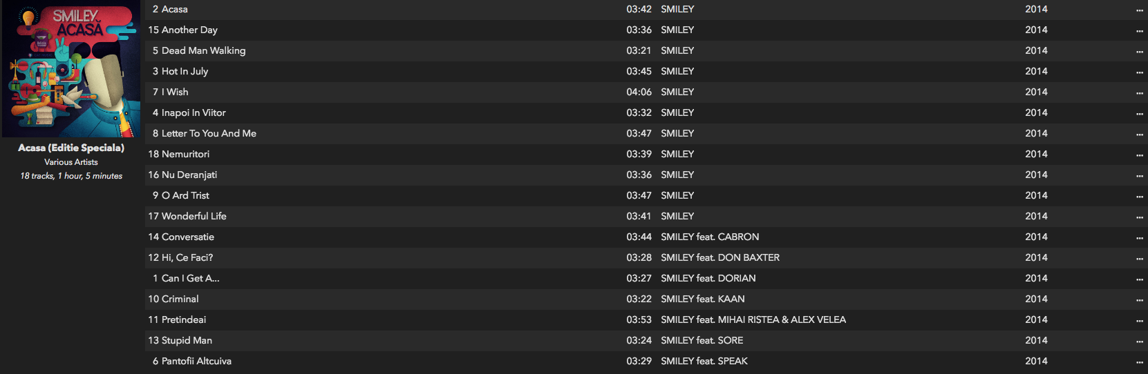

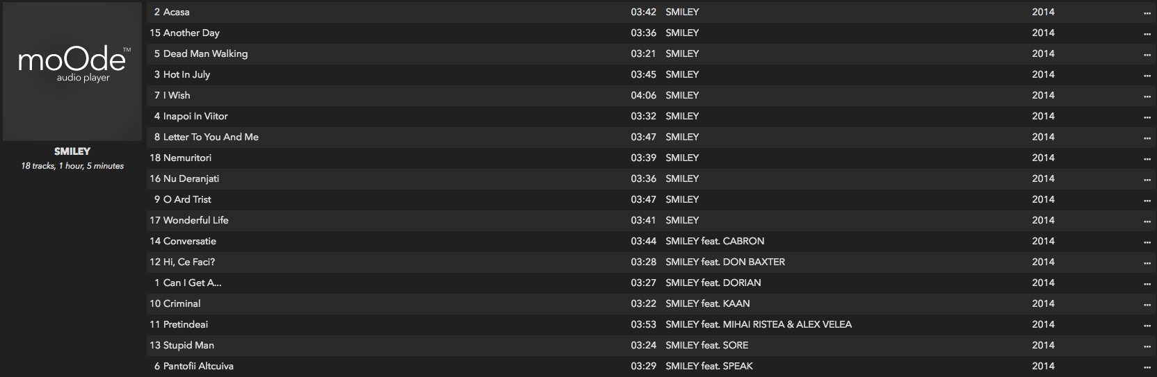

Anybody else has issue with track order and artwork?
1.
(This is displayed hen I select directly the album)
Some albums has wrong track order. The track number is good but the tracks are not in order.
2.
(This is displayed when I select the artist and then the album)
Same wrong track order of the same album, this time without cover art.
I have to mention, all my albums have cover art and track no. in tag and files have the following structured:
+ ARTIST
+ ARTIST
+ Year - Album
+ Year - Album
Playlist.m3u
Audio files
Booklet.pdf
Some other singles like single tracks are stored in a "Year" folders; some of audio files have cover art, some of them doesn't have cover art.
The tracks without embedded cover appears with a cover art "stoled" from the other files in the same folder, even if there is not Folder.jpg file.
3.
Wrong cover art.
4.
Wrong cover art.
I did quick check of my own collection and I'm not able to repro the track order issue. One way to troubleshoot is to navigate the MPD database to the Album and then examine the index order of the song files. You can also zip up one of the Albums and email me a download link. I'll see if I can repro.
telnet localhost 6600
lsinfo "path to the Album"
Example:
pi@rp3:~ $ telnet localhost 6600
Trying ::1...
Trying 127.0.0.1...
Connected to localhost.
Escape character is '^]'.
OK MPD 0.20.0
lsinfo "NAS/Music/Velvet Revolver/Contraband"
file: NAS/Music/Velvet Revolver/Contraband/01 Sucker Train.flac
Last-Modified: 2017-02-01T02:54:38Z
Time: 268
duration: 267.773
Title: Sucker Train
Artist: Velvet Revolver
Album: Contraband
Genre: Rock
AlbumArtist: Velvet Revolver
Track: 1
Disc: 1
Date: 2004
file: NAS/Music/Velvet Revolver/Contraband/02 Do It For The Kids.flac
Last-Modified: 2017-02-01T02:54:42Z
Time: 236
duration: 235.826
Title: Do It For The Kids
Album: Contraband
Genre: Rock
Track: 2
Disc: 1
Date: 2004
file: NAS/Music/Velvet Revolver/Contraband/03 Big Machine.flac
Last-Modified: 2017-02-01T02:54:48Z
Time: 266
duration: 265.533
Title: Big Machine
Album: Contraband
Genre: Rock
Track: 3
Disc: 1
Date: 2004
