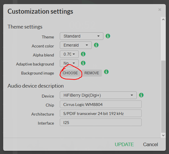

Hey guys, what's the easiest way to get a jpeg as a background in the PI3? I wanna see what moOde looks like with my own BG.

It does not have to be in Pi when you set the background. It will allow you to browse a picture on your PC then upload to Pi. Very convenient.Hey guys, what's the easiest way to get a jpeg as a background in the PI3? I wanna see what moOde looks like with my own BG.
