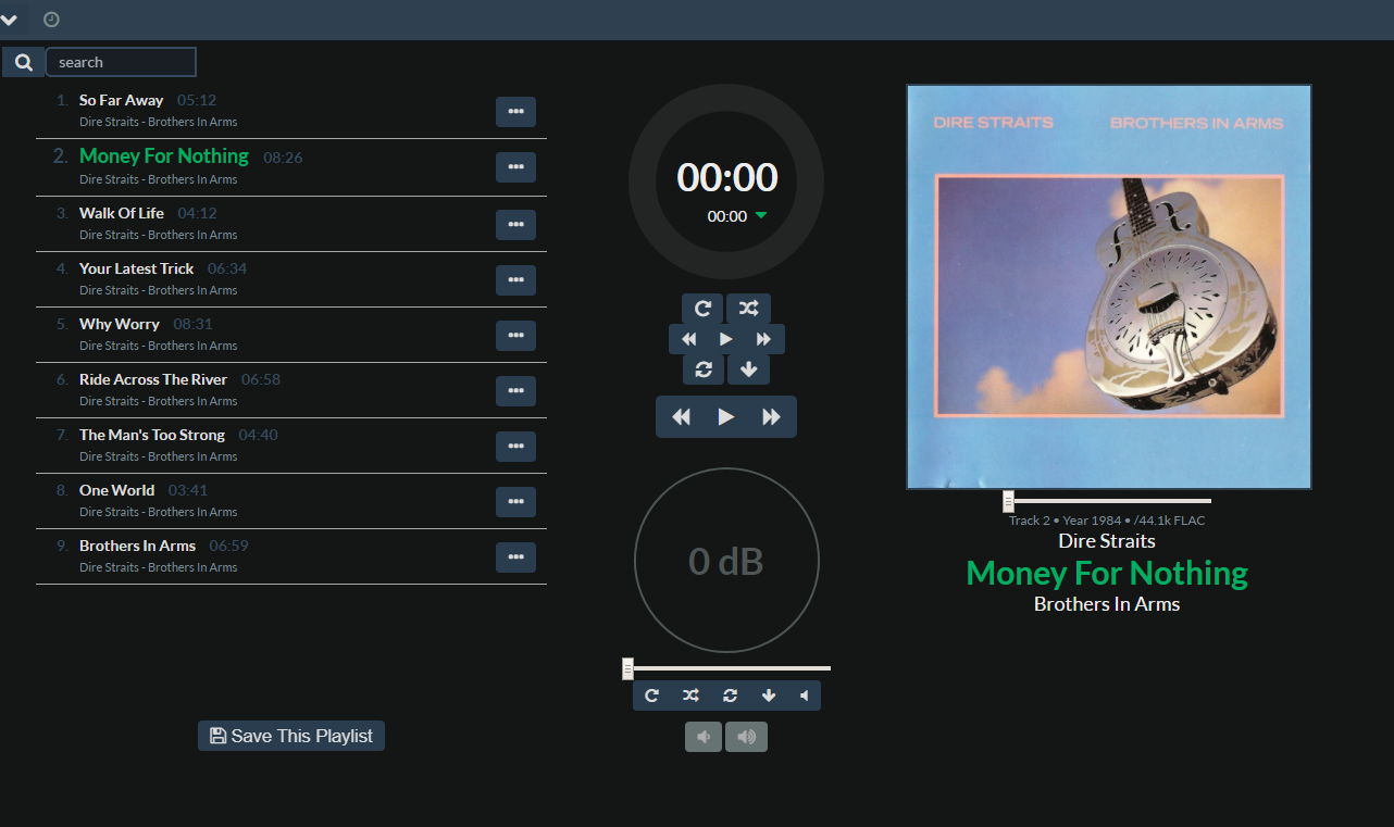

Ahhhh, problem solved. The fact that the system became soooo slow, was due to a bad µSD card. Replaced it with a Sandisk, problem solved.
And now, wooow....this is awesome...Tim, you did it again, what a fantastic job: fast stable, beautiful interface, also on my 7" touchscreen....great job (If you were a woman, I'd kiss ya...)
And yet, I have a beauty issue. Have a look at the picture of the library, and you'll know what I mean ;-)

Am I seeing 3 digit track numbers?
-Tim
Yep, that's the problem...Hi,
-Tim
3 digit track numbers and even 4 digits....
Hi @JST1963,
Does the Album actually have 1000's of tracks or are these bad values in the Track tag?
-Tim
-Tim
What you see here is a collection of songs from the 80's (also have them for the 70's, 90's and 00's). That means there are about 3 to 4000 songs in each collection. And I gave them tag numbers from 1 to xxxx. But as you can see, the result in moOde is not nice. But I have no other way to number them...Hi @JST1963,
