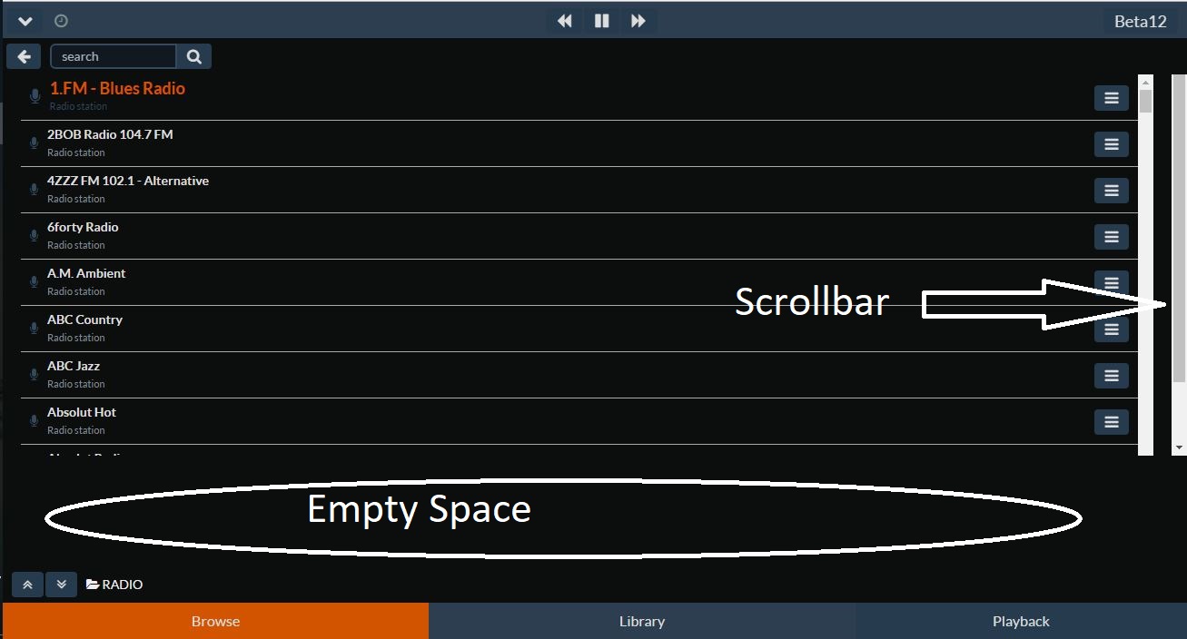

Hi there,
I finally succeeded to installed Moode 4 and I thank Tim and Koda for the works.
Now I am annoyed from a little problem. There is a double scrollbar in the right side as the picture show. Someone have an idea how to remove it and resize automatically the window?

@supertrichi
Interesting. I hadn't noticed this until you brought it up.
It looks like this happens only in the Browse panel and presumably because we have one scrollable window (the RADIO list or a Playlist) embedded inside another (the Browse panel).
I don't see the empty space you see.
Tim?

Provide details on your configuration for example:
What Browser are u using?
What client (Desktop, Mobile, Local Screen, ...)
-Tim

I'm using W10 with browse Chrome visualization 100% but if I zoom out, es. 90% automatically hide the second scrollbar and the empty space. The same thing with Edge.
Is it possible to automatically change the resolution to fit any screen?

Perfect on Android device!

Agreed. I see the artifact with both Google Chrome and Mozilla Firefox browsers on a Linux Mint 18.2 desktop but not with either the Chrome or the Firefox browser on my Android tablet. (Which is why I hadn't noticed before; I usually use my tablet for moOde.)
