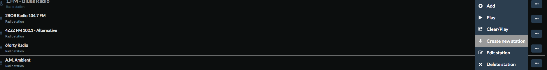

I have just built moode on a raspi3b using 4 beta 12 and the Moosimbu script (got it working on 3rd attempt - 1st time around I was probably too impatient and started config'ing too soon, 2nd time around the local.rc failed to run correctly).
I think i'm all up and running now but have not yet connected the IQaudio Digi+ to my DAC and heard any music out of it yet.
I believe that you can add radio stations - I have found all the stream feed details but I don't see where I should enter them - how do I get to the radio station maintenance screen?
There may be an alternative method but this works for me. Go to browse, click on RADIO and on the far right you will see . . . click on the three ... to get pop with options. Click on create and you enter in the address for your new station.
Hope this helps.
