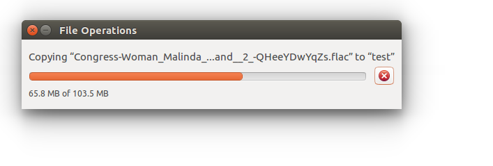

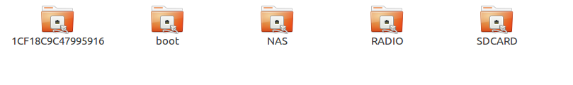

Well...I accept you have a problem...though I think it is of your setup and not MoOde's
Attached screenshots show usb drive visible in Samba on Ubuntu and transfer of file.
What filesystem is your usb drive using ?, are you plugging it in before starting MoOde ?, does it show in the Samba shares ?

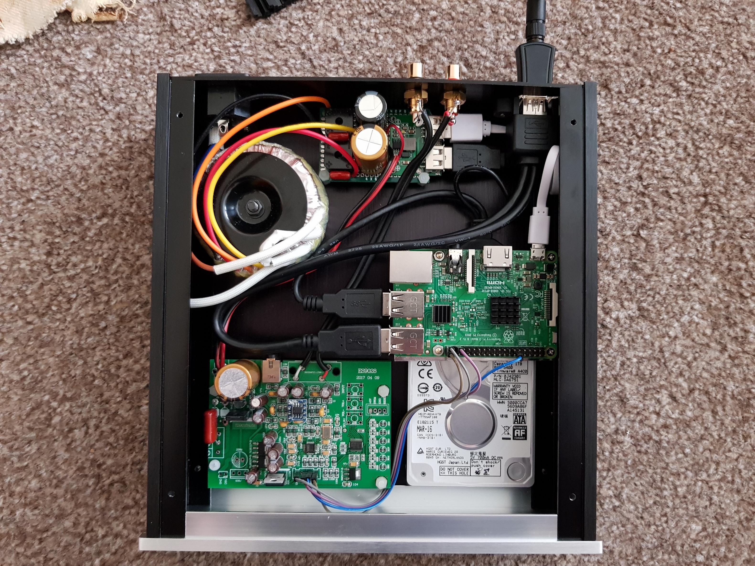

I do have all the shares you listed just fine every time, no problems with accessing them at all, even rebuilt the sd card image 3 times to make sure there is no glitch. The hdd (hdd is NTFS and using a sata to usb adapter which has Y split one for data and one for power) is powering same time with the raspberry pi every time; all is powered by a linear power supply with separate lines for the compute-ring part and dac analog part. Sounds like I am part of the unlucky ones with this build.

I have my small Western Digital 1TB usb drive plugged into the Pi - with the power to the USB drive split off and connected to a dedicated 5V supply so it's not powered by the Pi.
Mine does not have the USB/SATA adapter though like in your setup.
Nice case setup BTW.
My prototype setup "guts" shown below

Thanks - re the display I know exactly what you mean. It's the hardest part of the build! Luckily I have access at work to some very good machinists - it's a Parmetal 1U black anodized case (not shown) that will (eventually) have a 40x2 display
On the sata adapter - not the same I know - but I've definitely had "funny" issues with usb drives connecting (read but not write) in misc computers. Even too long of a usb usb cable on a USB3 drive has caused to be able to only read but not write. Might be some sort of timing ?? issue with the sata / usb in the loop (?)
