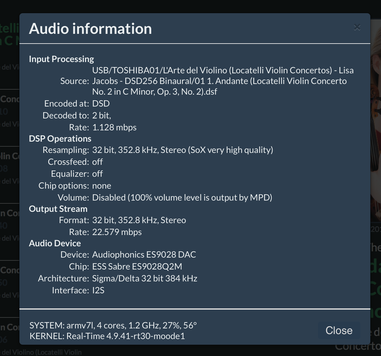

Hi @terry22,
Interesting. Send me email and include a screen shot of Audio info and the output of System info. I'd like to verify that my coding for DSD bitrates etc is correct.
Thanks!
-Tim
Here they are:
attachment.php

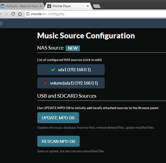

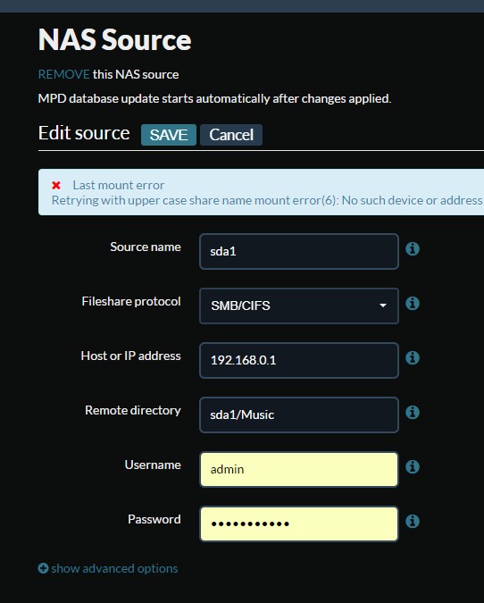

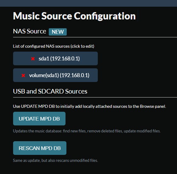

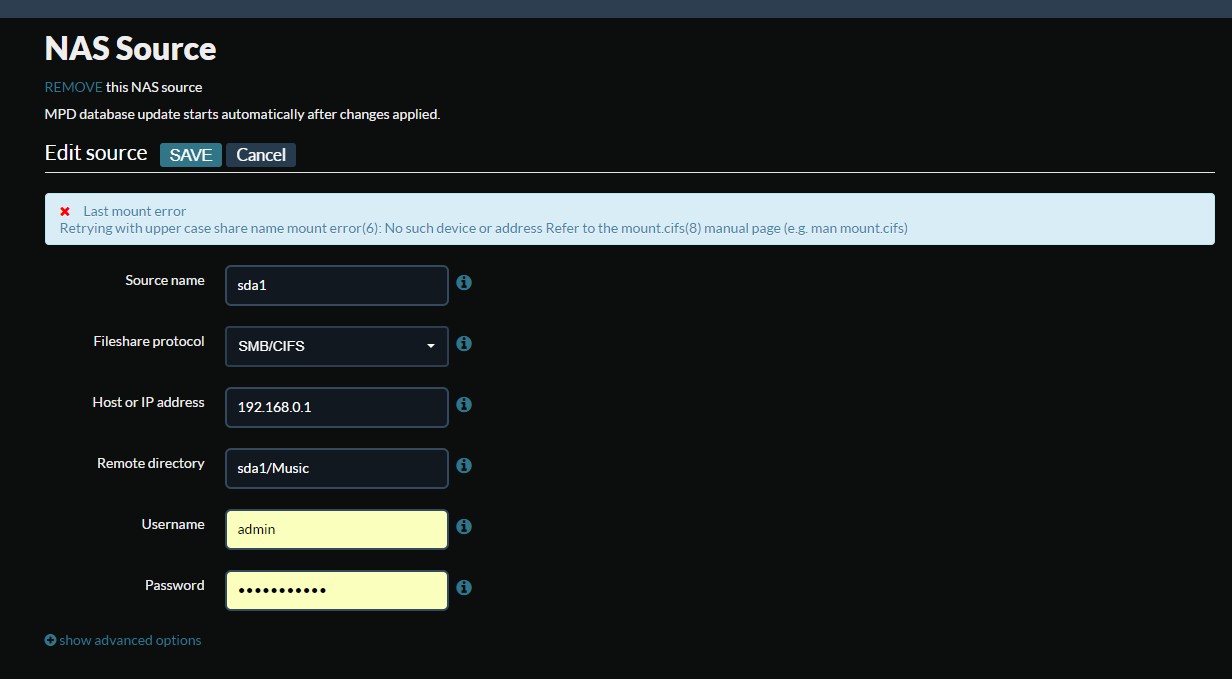

I've been running my MoodePi (3.7) as an AP for a couple of months, and I'm liking it a lot. I got a new router with USB port and a 2TB USB hdd plugged into it. It's working as a NAS in Windows. I can't get the MoodePi to access the NAS drive. I'm sure it's my lack of Linux skills. So, at the risk of further ridicule and shaming, I'm asking for a little help getting this going.
My problem, I think, is knowing exactly what to enter in the Moode > Configuration > Sources > NAS Source > NEW screen.

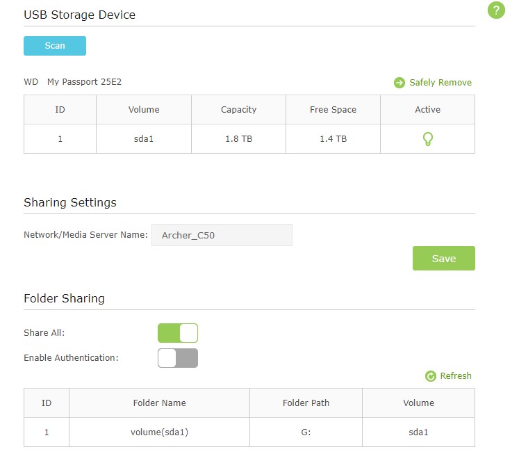

In Windows (fwiw), the path to the folder with the music on my NAS is Network/ARCHER_C50/volume(sda1)/Music. Under that, I have a bunch of different folders with music files in them.
1) Do all the music files have to be in the same single folder? (I don't think so, but just for clarity). I have lots of subdirectories under the /Music directory. What if I have a bunch of CD ISO files in there that Moode can't read? Can those cause MPD to lock up? (That has been happening.)
2) In the NAS Source > Source name field, can that be any name of my choosing, or does it have to be the name of the drive/volume? If the name of the drive/volume, does it need to be entered in that field the same as it appears in Windows > Network, as (volume)sda1 ? Or should it be simply sda1 ? Or can I call it MusicDrive or similar?
3) For the Host or IP address, that should be the LAN IP of my router, correct? (E.g., 192.168.0.1)
4) For the Remote directory field, I think this is where I'm failing. I copied what I see in the Windows File Explorer path. The full path is Network > ARCHER_C50 > volume(sda1) > Music . I changed that to ARCHER_C50/volume(sda1)/Music and entered that in the Remote directory field. The result is that I get a 'waiting for Moode' floating notice in the lower left of the Moode UI screen, and when I go to Configure > Sources > Audio to Update MPD, Moode becomes unresponsive and I can't open anything from the Configuration screen, although it will still play music or switch between the tabs. I then have to reboot the Pi.
I also tried volume(sda1)/Music, ARCHER_C50/sda1/Music, and simply sda1/Music, but always exactly the same failure. The NAS Source page displays an error message stating that the resource wasn't successfully mounted.
It takes a long time to fail, reboot the Pi, try/fail again, reboot the Pi again, over and over.
What the heck am I doing wrong this time?
PS - I rebooted and went into Configure > System > Maintenance > Clear system logs, switched that to YES, and clicked SET. Now Moode is doing nothing, with the notice in the lower left stating "Waiting for moode...". I need to reboot the Pi (again) to be able to change any settings under Configuration. Very frustrating.

A little more info...
In the router's USB Storage (NAS) page, I think I see some info that should help. It appears I'm misunderstanding what a 'folder' is, etc. My brain is full of DOS and Windows terminology. Please forgive me.
It looks like the Media Server name is Archer_C50, the Volume is sda1, and the Directory name is volume(sda1). Is that correct? Is the Directory name in the router USB config page the same as the Folder asked for in the Moode's NAS source NEW page?
Unfortunately, I can't try those in the NAS Source NEW because...
In the Moode > Configure > Music Source Configuration > NAS Source, I have two NAS sources listed that I'd like to delete. The problem is that if I click on a source and go into the NAS Source screen, and if I click REMOVE this NAS source, I get that infernal "Waiting for moode..." message, nothing happens, and then I can't get back into any Configuration options until I shutdown, unplug, and reboot the Pi (again).
I can't Update MPD DB or Rescan MPD DB. Either choice brings up the "Waiting for moode..." notice and I can't get into any Configuration screens until I reboot the Pi (again).
According to your second pic, your smb share is working - remove the second NAS entry.
You should be able to edit after using the cache reset option.
Thanks. Unfortunately, the problem is that when I click Remove this NAS source, Moode freezes with the message "Waiting for moode..." and after that I can't access anything within the Configuration screen until after a shutdown/power off/reboot sequence.
Is that the way it's supposed to work?

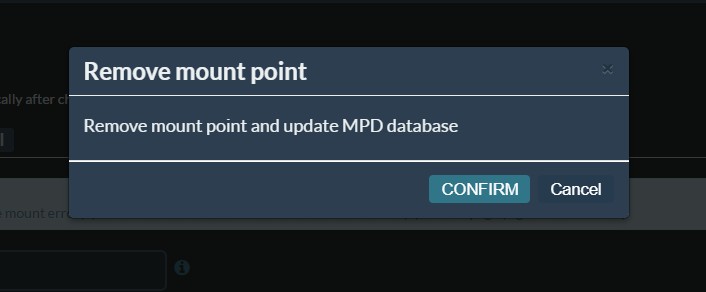

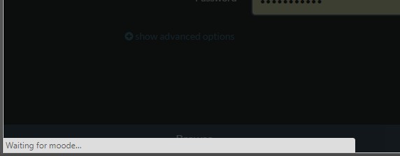

Here's what's happening:
1) From the Configuration screen, I chose Audio > Source, then Music Source Configuration (see 00_MusicSourceConfig_2toRemove.jpg, attached). You can see the two NAS source items I want to remove. I clicked the first one (sda1(192.168.0.1).
2) That takes me to the relevant NAS Source from where I click REMOVE this NAS source (01_NAS-Source_REMOVE_this_NAS_source.jpg).
3) Now I see the modal dialog Remove mount point. I clicked CONFIRM (02_Remove_mount_point.jpg).
4) Nothing seems to be happening. It's been over 5 minutes and the only change brought by clicking CONFIRM was the appearance of the "Waiting for moode..." notice at the bottom left of the screen (03_Waiting_for_moode.jpg).
How long should I wait for this process to complete?
If I go to add a new NAS source, I get to the same situation, Waiting for moode...
In addition, setting the SSID in the Network Config screen to blank failed to enable the AP, even after two reboots. Neither of my two Android devices see the Moode SSID available.

The tp-link Archer series are easy to set up. I have a VR400 which I use as a NAS.
In my case, I created two folders, music and podcasts and shared with those names on the router.
Then created NAS mounts in Moode using the router's IP address and share name.
Tp-link does have a document on setting up a NAS on their website.
Phil
