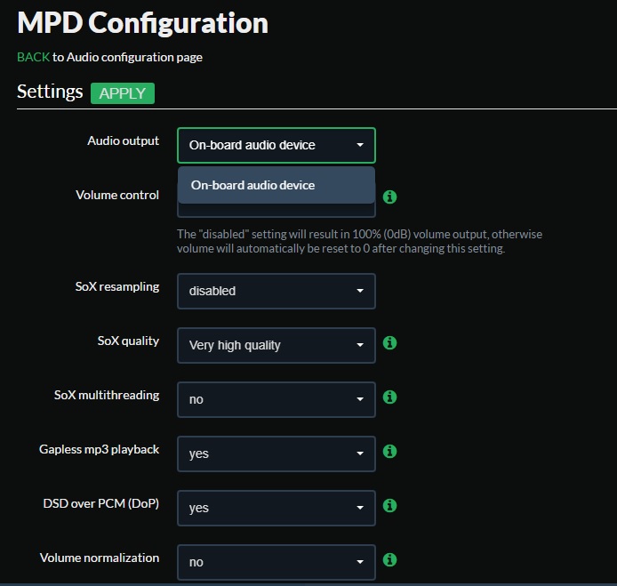

Hello Tim,
I just installed the version 3.8.4 on a RPi3. I intend to use Minidsp 2x4HD as the USB DAC.
Under Configure -> Audio -> MPD Settings -> Audio output - I only see onboard audio device option. I do not have option to select USB Device. Can you please help how I can fix this.
Also is there a way to make Moode read windows media player playlist?

In the setup guide:
2. AUDIO DEVICE SETUP
- USB DEVICE
a) Menu, Configure, Audio, MPD options: EDIT SETTINGS
b) leave Volume control set to "Software"
c) set Audio output to "USB audio device" then APPLY
No, Moode won't read a WMP playlist but you can create an m3u playlist from WMP.
Better than that is to setup a share to your music content and point Moode to that share via the configure>sources option.

In the setup guide:
I tried exactly like in the instructions in Set-up guide. But I don't have any other option in the Audio Output. The only option I see is On-board Audio Device.
Edit: Never mind, when I connected the device it showed up.
