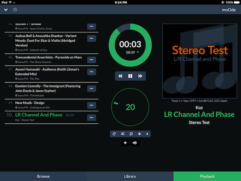

moOde release 3.8.4 is available at moodeaudio.org and via in-place Software update for any of the 3.8 series releases.
This release contains a new version of MPD that fixes the AIFF tag issue 🙂 There are also other important bug fixes and updates. Refer to the release notes below for details
3.8.4 Release 2017-08-28
Updates
- UPD: Bump to MPD version 0.20.10
- UPD: When MPD vol set to disabled display 0 dB in volume knob
Bug fixes
- FIX: Adv driver options not set correctly when std kernel
- FIX: AIFF tags not being parsed by MPD (mpd fix)
Enjoy!
-Tim
