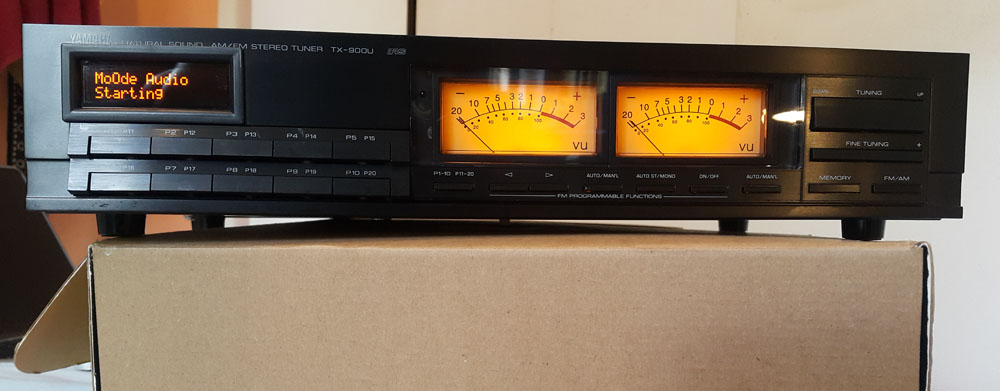

I have about 15 hardware buttons on my moode player. I want to assign some of them to my favorite radio stations. Here is a series of commands i use to get to one of my favorite radio station (the jazz groove):
Code:
pi@moode:~ $ mpc stop
volume: 26% repeat: off random: off single: off consume: off
pi@moode:~ $ mpc clear
pi@moode:~ $ mpc load "Default Playlist"
loading: Default Playlist
pi@moode:~ $ mpc play 5
[url]http://aac-64.streamthejazzgroove.com:80/stream[/url]
[playing] #5/53 0:00/0:00 (0%)
By combining: mpc stop; mpc clear; mpc load "Default Playlist"; mpc play 5; i should be able to select my favorite radio station? or is it better to just write the http of the stream directly in the script? how do i do that and how do i integrate it in my hardware buttons script?

Hi, Remy.
First, let me apologize for my half answer. As Tim immediately pointed out, I overlooked the obvious. At least I got the syntax right.
Second, let me take a moment to admire your project. I love seeing vintage HiFi gear being re-purposed.
Third, to your question, I have only a superficial understanding of mpd/mpc but it looks like you are on the right track attacking your problem by creating a multi-entry playlist consisting of all your favorite radio stations. [ed: deleted my restatement of what you've already done.]
I'm not in range of my moOde Player at the moment, but I can write and test a Python segment to implement this play selection later today if you want.
Kent

Hi Kent,
I am patiently waiting... you already helped put my project on the right track twice. Sort of i am now addicted to your help.
Remy

Found the display, seems it is hd44780 compatible.
14 pins instead of 16 but being vfd it doesn't need a backlight control so 15&16 not used.
Other pins appear to be standard as per the hd44780 and the parallel cable is only plugged. I will remove that and use dupont cables to the Pi.
So off to find the pin configuration to use then back to finding a setup and config. Keep the suggestions coming 🙂
That link I posted has the pinout down the page.
Unless you can source an i2c to parallel converter, you're probably S.O.O.L.
Cheaper and easier to source a compatible display.
Of course you may be able to bypass the parallel interface and talk directly to the display, but you will need the display data sheet.
This may help: I/O Ports Uncensored Part 2 - Controlling LCDs (Liquid Crystal Displays) and VFDs (Vacuum Fluorescent Displays) with Parallel Port - CodeProject
Or offload the task to an Arduino, perhaps? Arduino - HelloWorld
Kent
Hi Kent,
Remy
Hi, Remy.
I see there are 10 channel selector buttons. For this exercise I assume you aren't using the additional "P1-10/P11-20" button (I'll call it the range selector button) as it was originally intended.
The most straight-forward solution is to continue the if/elif pattern you have already used.
Here, I assume you have mapped the 10 buttons to ten variables of the same name (P1-P10), that you have already saved a playlist named FavoriteStations, and that it has at least 10 entries:
Code:
if P1==False:
subprocess.call(['mpc','clear'])
subprocess.call(['mpc','load','FavoriteStations'])
subprocess.call(['mpc','play','1'])
elif P2==False:
subprocess.call(['mpc','play','2'])
elif P3==False:
subprocess.call(['mpc','play','3'])
elif P4==False:
subprocess.call(['mpc','play','4'])
elif P5==False:
subprocess.call(['mpc','play','5'])
elif P6==False:
subprocess.call(['mpc','play','6'])
elif P7==False:
subprocess.call(['mpc','play','7'])
elif P8==False:
subprocess.call(['mpc','play','8'])
elif P9==False:
subprocess.call(['mpc','play','9'])
elif P10==False:
subprocess.call(['mpc','play','10'])
Note that telling mpc to clear the playlist implies 'stop'.
This "brute force" solution works but it is not defensive coding. There's no check that FavoriteStations exists, that it contains valid entries, and that the number of entries equals or exceeds the number of buttons. Also, the constant repetition of code suggests using a function to deal with the subprocess calls. As an aside, some folks hate that Python doesn't have a case statement and hate the explicit chaining of if/elif statements. The interweb (tm) is rife with suggested alternatives using Python dictionaries, etc. I chose it keep it simple for you.
As for the mapping of buttons, I don't know whether you are using one GPIO line per button (10 buttons = 10 pins) or multiplexing/Charlieplexing the inputs (10 buttons = 4 pins). The former is easy; the latter takes some diodes to prevent ghosting/masking and requires more complicated code to detect button presses. Google is your friend.
As for the P1-10/P11-20 button, using it requires some thought and more code. Would you go with simultaneous presses of it and a channel selector button or would you replicate the way my receiver works---first press the range selector button and then press the channel selector button. The latter gets complicated. Does the range selection revert to P1-10 after a few seconds or does it flip-flop each time the button is pressed?
Kent
