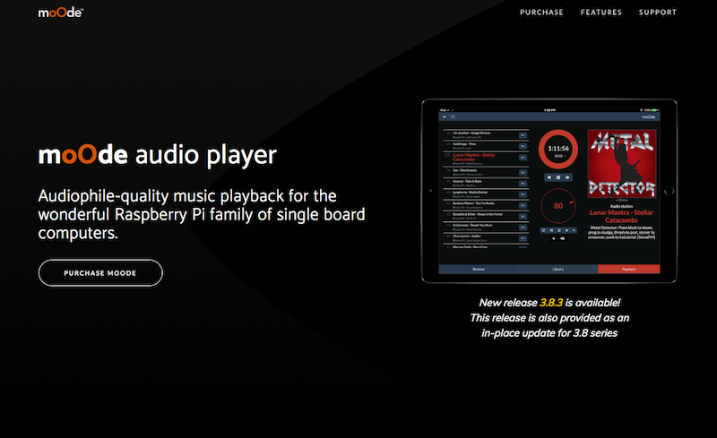

moOde release 3.8.3 is available at moodeaudio.org and via in-place Software update for any of the 3.8 series releases :)
This release contains important bug fixes and updates that help increase the robustness and reliability of moOde and improve the interface to certain audio devices. Refer to the release notes below for details
3.8.3 Release 2017-08-23
Updates
- UPD: Allow only RR and FIFO policies for Real-time kernel
- UPD: Deprecate bclk_ratio_int_div setting for adv kernels
Bug fixes
- FIX: Extra delay in click logic for currently playing Playlist item
- FIX: Re-Mount not handling stale file handle condition
- FIX: Piano 2.1 main vol not initialized at startup if MPD vol disabled
Enjoy!
-Tim
