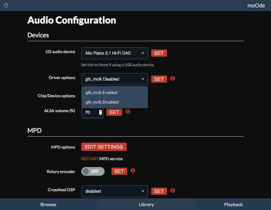

how does one enable gab_mclk
/QUOTE]
In the Driver options, Audio Config - Devices.
Is that via editing a config file using ssh login, if so what file and where as I don't see that option anywhere in the web interface.
more info pleeeese

Not ssh, it's in the settings where you configured things when you set up: Moode symbol top right, Audio Config.
It may be that you need to be using one of the Advanced Kernels for it to show up.
Im already using the advanced kernels. maybe its not an option on the ti 5242 chipset in my dac. however thinking about it when I first built my dac I scoped the kali clk signals and the clocks maxed out at 50mhz (192khz) going above 192k still gave me sound but the kali must of been dropping every other sample. so I stuck at 192k 32bit. without kali i can go to 384k but sound is much better with kali in place.

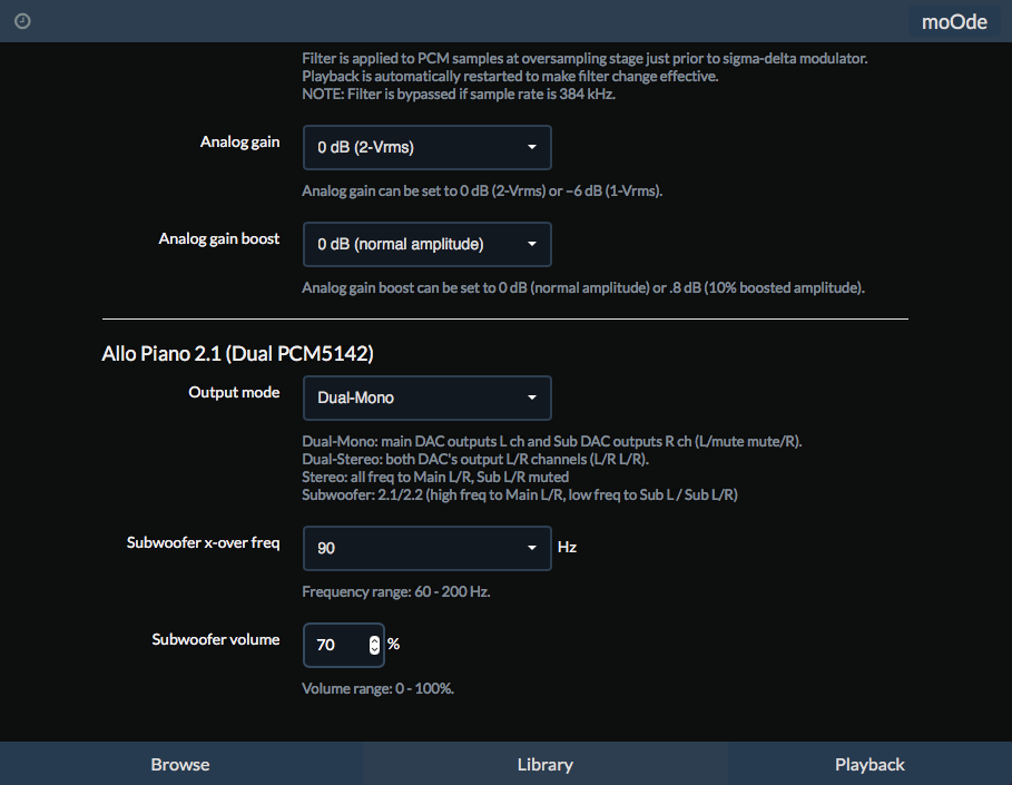

I'm not able to repro the issue: "Piano 2.1 Dual-Mono and only one channel".
Below are some troubleshooting steps. I've also included screen shots of the Piano 2.1 Driver and Device options.
1) moOde System info screen:
- Verify you are running release 3.8.2
- Verify you are running one of the 4.9.41 Linux kernels
- Verify that Mixer name = Master
2) Remove the Kali re-clocker and connect just the Piano 2.1
3) Reboot
4) Open the Audio config screen
- Verify that I2S audio device = Allo Piano 2.1 Hi-Fi DAC
- Verify that Driver options = glb_mclk Disabled
a) Click EDIT SETTINGS for Chip/Device options
- Change Piano 2.1 Output mode to Subwoofer 2.1
- Click APPLY
- Reboot
- Change Piano 2.1 Output mode to Dual-Mono
- Click APPLY
- Reboot
b) Click EDIT SETTINGS for MPD options
- Set SoX resampling = disabled
- Click the APPLY button
5) From an ssh session:
- ssh pi@moode (pwd = moodeaudio)
- ./piano.sh

The three volumes will either initially be 0% if MPD set to Hardware volume, or 100% if MPD set to Software or disabled.
6) Play some music and verify that Dual-Mono mode functions correctly and the channels are L/mute mute/R when looking at the RCA jacks.
7) Shutdown, add the Kali re-clocker and then verify both channels are outputting correctly
-Tim
