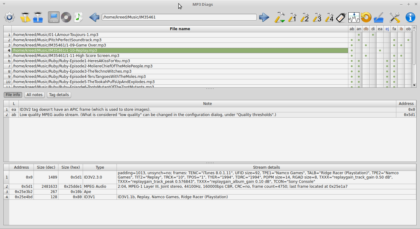

Hi @IM35461
I analyzed the three files you sent and the Mediainfo dump looks ok but for some reason MPD is not parsing the Genre tag in the first two files. I have no clue why this is the case.
The ? in ?/44.1 will appear for song files encoded using lossy compression since there is no concept of bit depth in lossy compression.
Btw, these are AWESOME tracks 🙂

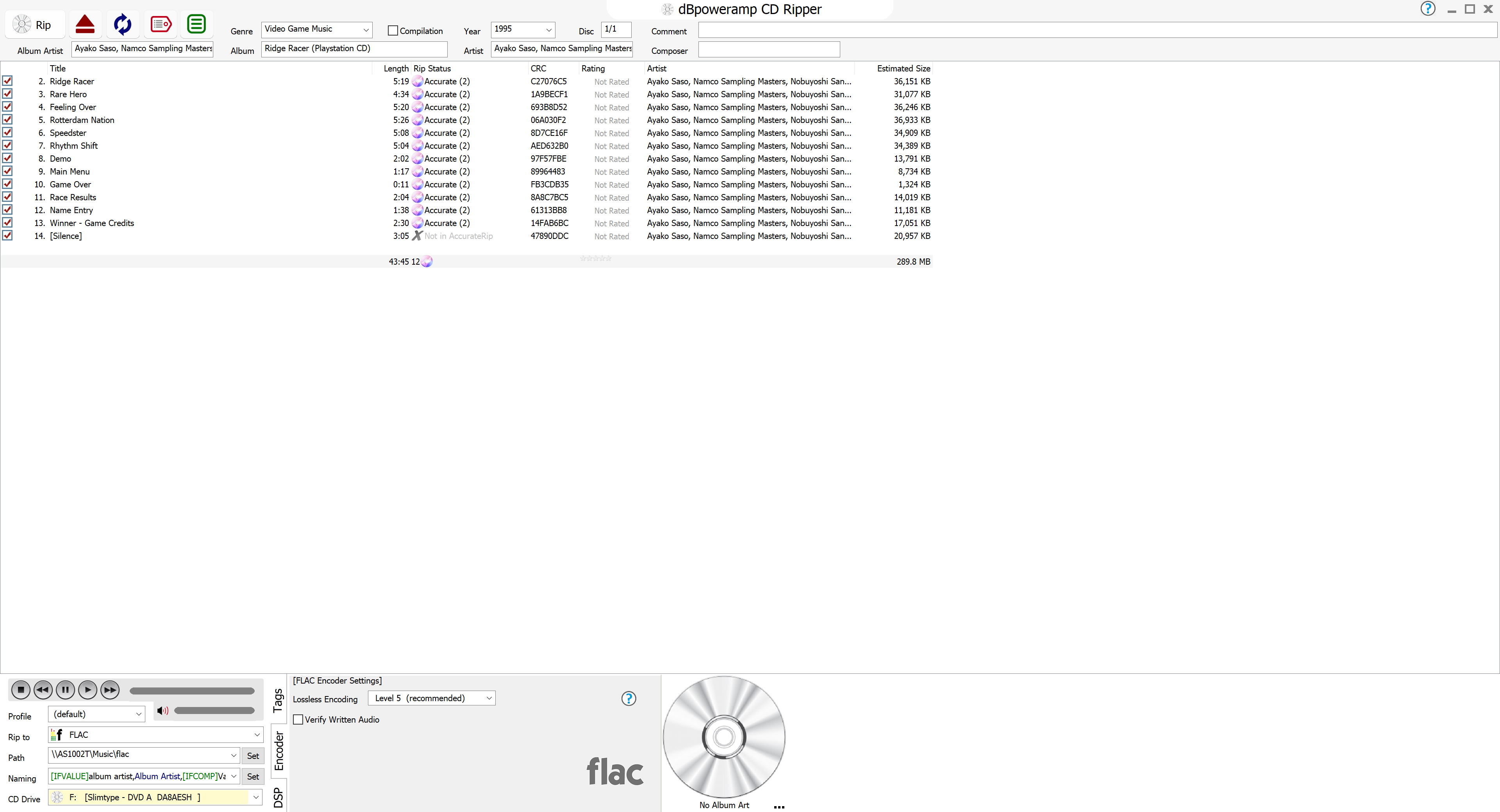

Tim,
Thanks for taking the time to investigate.
Anyway, I have found a solution, climbing up into the loft / attic to get the original PlayStation Games Discs.
I have now ripped them, this time of course in flac format and the genre and other tag information works as expected.
Kent, also thanks for investigating the problem.

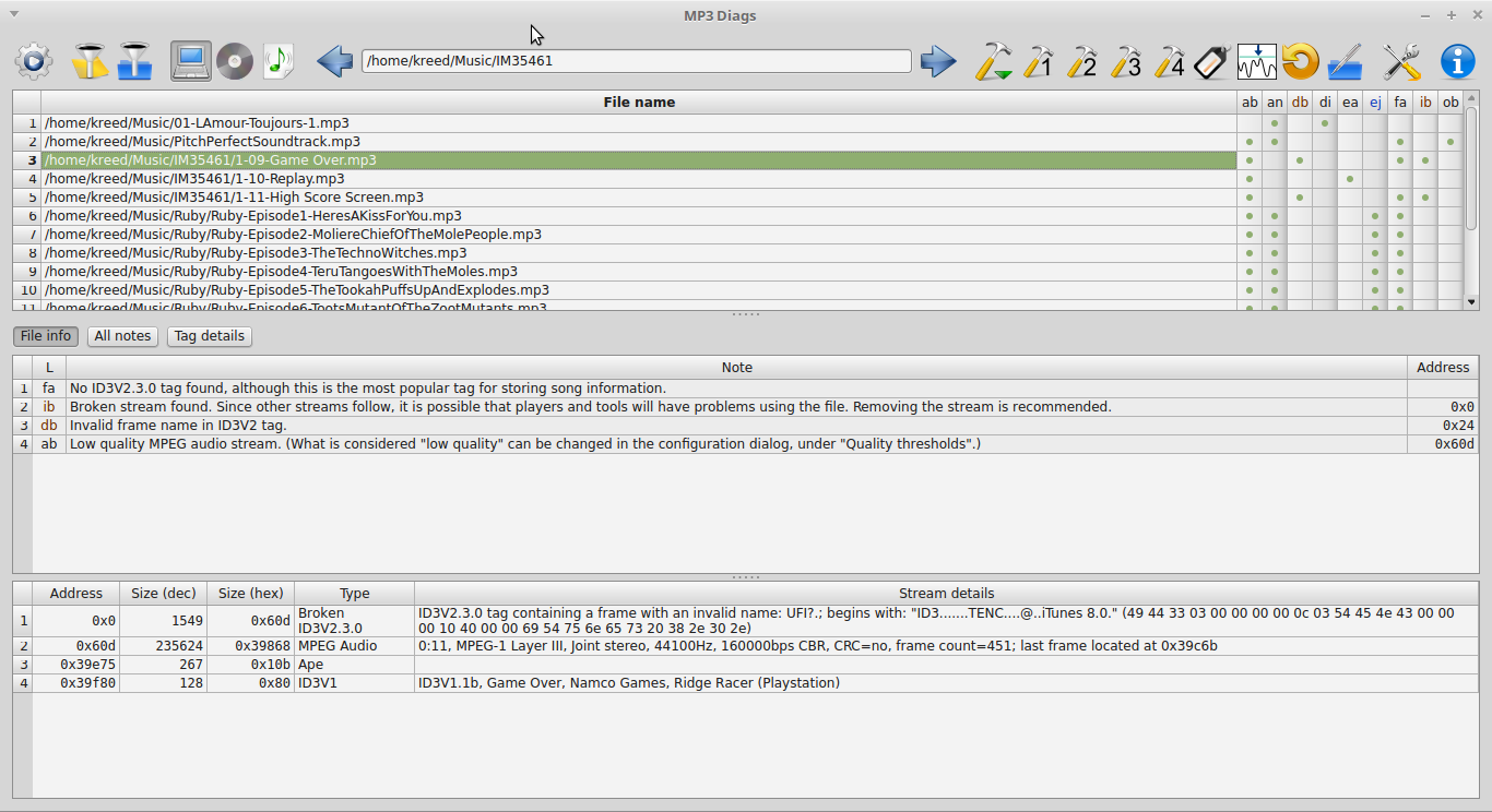

I looked at the same three files Tim did. The swiss-army knife tool known as exiftool showed a low-level difference in the metadata of track 10 versus tracks 9 and 11 which I thought might be the smoking gun but I wasn't sure how to test my hypothesis without serious binary editing of the files.
Fortunately, I also tried mp3diags. It put my thoughts into English. Compare the two attached screenshots, the first for track 9 and the second for track 10.
The broken stream reported for track 9 likely is the culprit.
Other points:
1. All of the files have multiple tagging schemes applied, ID3v1, ID3v2, and APEv2 (these are separate blocks). In each file, the ID3v1 Genre tag is empty. Had it been filled in, you might never have seen your problem.
2. There is no tag "Tool Name" or "Tool Version" in these files so mediainfo was mapping something else into those names, probably because of the broken stream problem. Actually, these string names don't appear in the lists I found of standard ID3 codes. Apparently, jRiver Media Center generates comment tags with these string names so maybe the faulty metadata convinced mediainfo that's what it was seeing. Each of your files has comment tags.
3) I'm using the word "tag" very loosely here, but I don't want to get into the nomenclature.
Anyway, glad you got clear rips. Music like this deserves preservation😎
