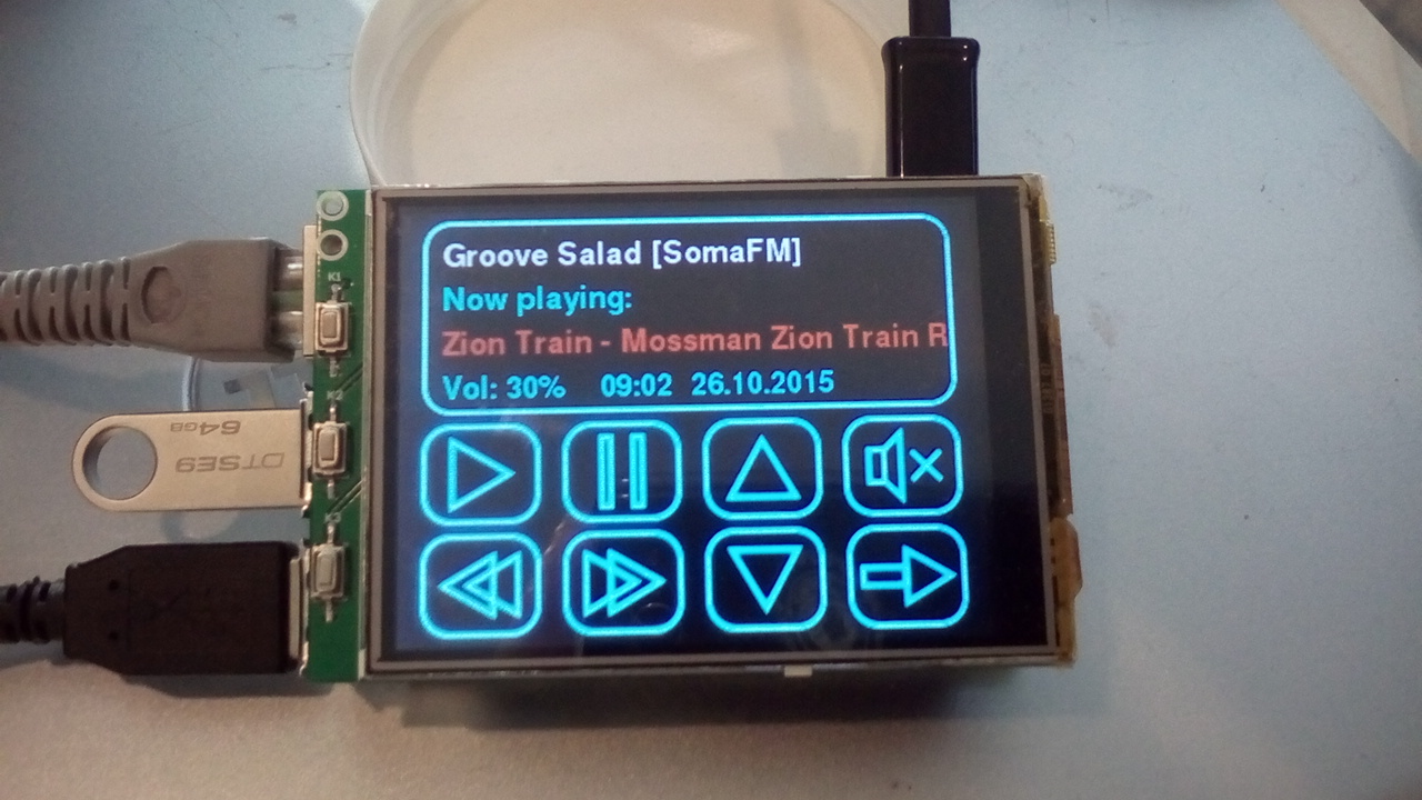

Wow! Thank you very much for this great piece of software.
I am really amazed how good a raspberry pi together with a hifiberry dac+ running moOde can sound.
I love the way i am rediscovering my music collection and the world of internet radio stations.
It even inspired me to start my first raspberry project.
I bought a cheap little touchscreen (waveshare spotpear 3.2, 320x240)
to fit on top of a raspberry pi 2B.
The goal is to make a little radio running moOdeaudio, but also can be controlled on the touchscreen so my kids can use it without the need to get a phone or tablet.
Ofcourse the webinterface of moOde audio is not suitable for such a small screen so i am making a pygame program to run as a local small screen MPD client on top of a moOde audio system.
I started with the beautifull program RPi-Tron-Radio (https://github.com/5Volt-Junkie/RPi-Tron-Radio)
and changed the script to my needs.
This is how it looks:
I changed the volume control so it uses knob.sh instead of calls directly to MPC so it stayes in sync with the moOdeaudio webclient.
Now i would like to also include a cover art image on the little screen. But i don't know how to do that.
Would it be possible to create a script like knob.sh to get the url of the cover art picture displayed in the moOde web client?
I think the information i need is located in the file /var/www/js/player_lib.js in the var MPDCS.coverurl. But i have no clue on how to read that information and get it into my python script.
I am new to raspberry's and python scripting (this is my very first attempt at it) so maybe i am missing something obvious. But any help would be much appreciated
