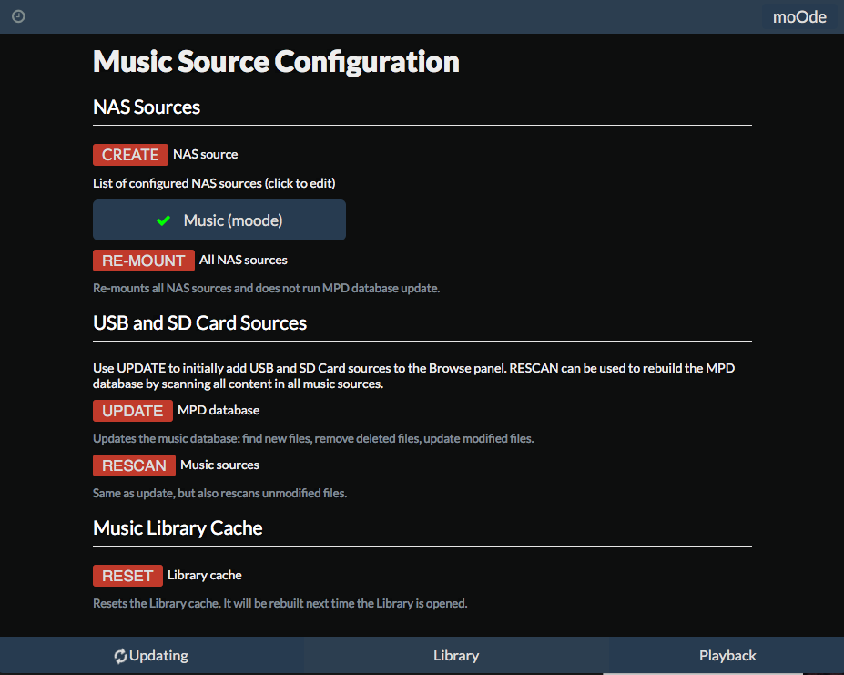

Some improvements to Source Config coming in moOde 3.8 ncluding quick Re-mount and Reset library cache.
The Re-mount function is useful in cases where NAS sources are offline when Pi is rebooted. Resetting the Library cache resolves the issue where the Library was opened before MPD update completed thus leaving the Library incomplete.
-Tim

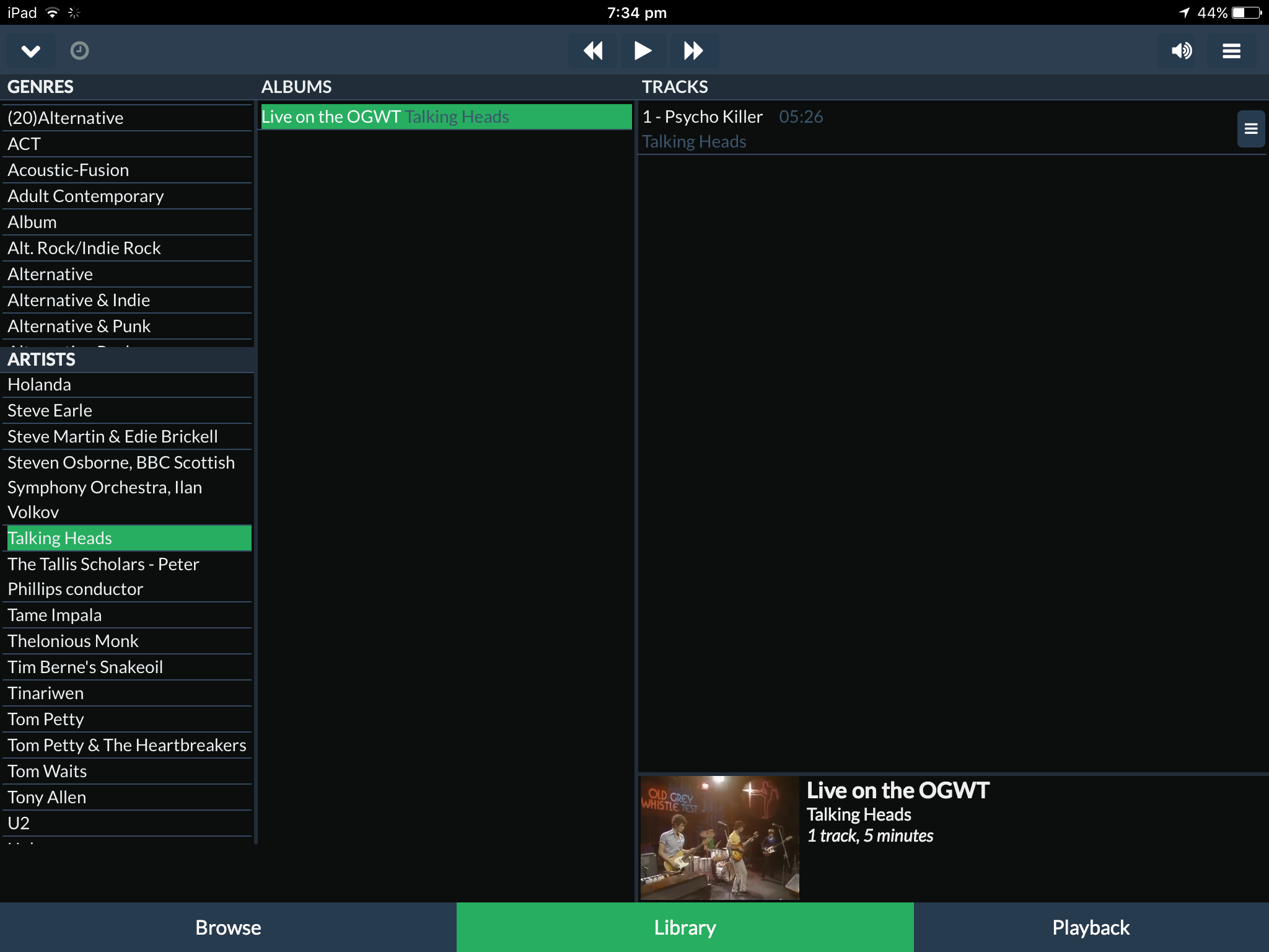

Missing metadata / tracks
Moode sounds amazing and remains the best piece of freeware I've paid for, but the library view appears to be dropping artists / albums that MPAD "sees" so I guess the tagging is Ok, I have >15000 tracks can that be an issue?
I'm quite happy using MPAD except I think the next IOS update will kill it off.

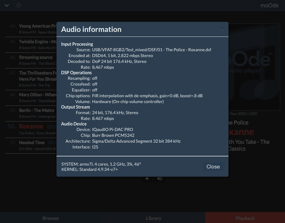

Hi Rafa,
I tested a DSD64 file with MPD set to DoP=yes and ALSA output was the expected 24/176.4K Note that the DAC I'm using is an I2S DAC that doesn't support DoP. Also I'm using a moOde 3.8 build that has MPD 0.20.9 compiled with only FFMPEG codecs.
You could try setting MPD logging to verbose and then look at the log to see if it shows in detail how the particular DSF file is processed.
-Tim

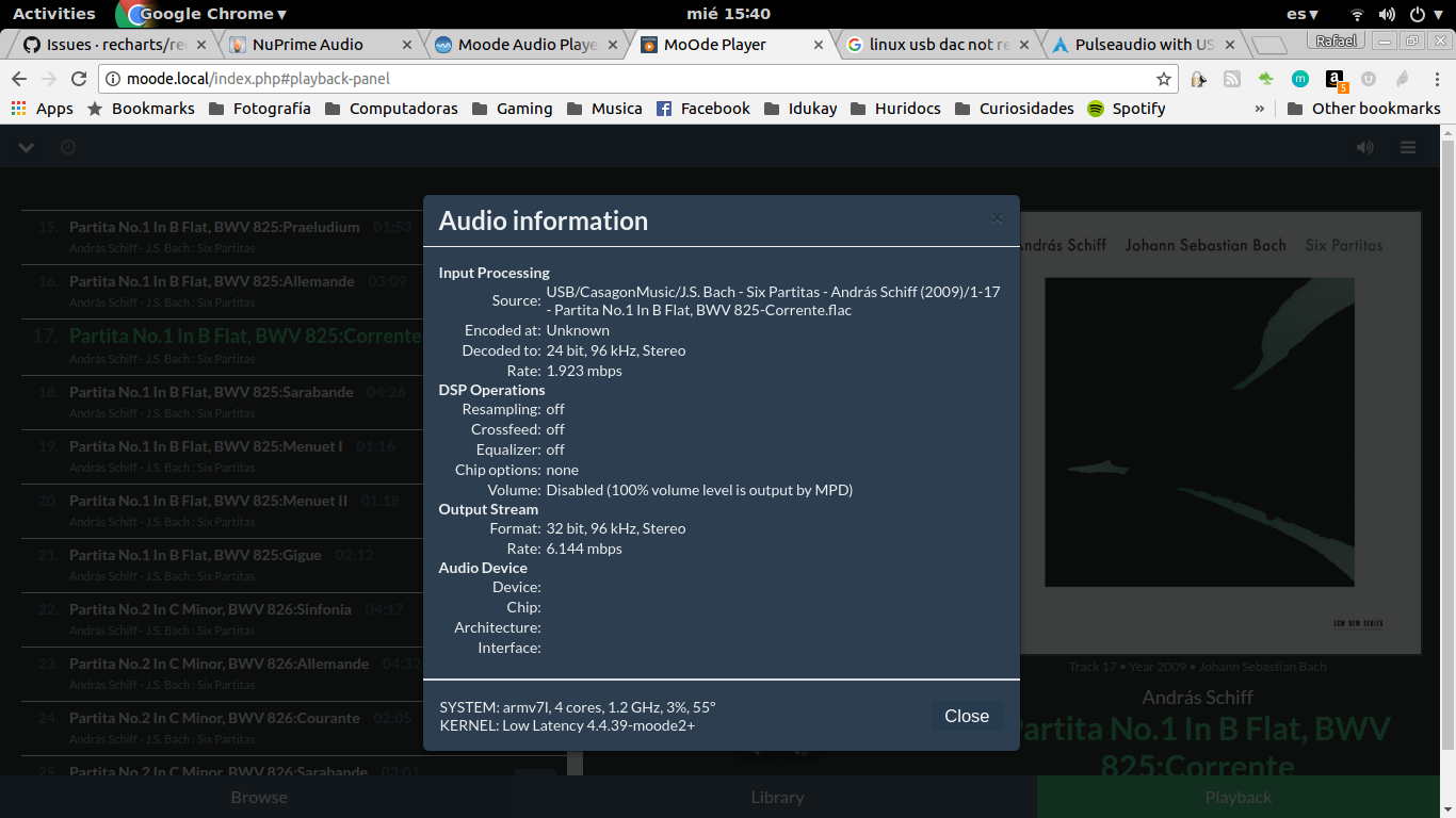

Thanks! I was afraid my post would be useless, as I explained myself very poorly.
Let me rephrase:
The OS returns from: `cat /proc/asound/card1/stream0` only S32_LE and S16_LE.
But there are no traces of the S24_LE or S24_3LE that would allow outputing native 24bits.
So for EVERY FILE (not only DSDs) that has a bit rate higher than 16, MPD is playing at 32bits (obviously!).
My question was: I'm sure that my DAC actually supports 24 bits. So, is there a way to 'force' the OS to detect and / or output 24 bit audio and not 'upsample' to 32 bits?
If not, who is doing the 'upsampling' when playing a 24 bit file (again, not DSD)? Because in audio info the resampling reads 'no', yet the origin file is 24 bits but the output stream is 32 bits.
Hope I made myself clearer this time around, sorry for the confussion.
Best regards,
Rafa.

Hi Rafa,
Possibly ALSA thinks your DAC's USB receiver wants only 16 or 32 bit word length so 24 bit is zero-padded to 32-bit. This bit-padding does not change the original quantized value in the 24 bit word and the sample rate remains unchanged so no "resampling" is happening.
I'm not sure which component does the bit-padding but MPD verbose log might show something.
You can try forcing 24 bit word length by selecting "24 bit / * kHz" item in SoX resampling.
-Tim

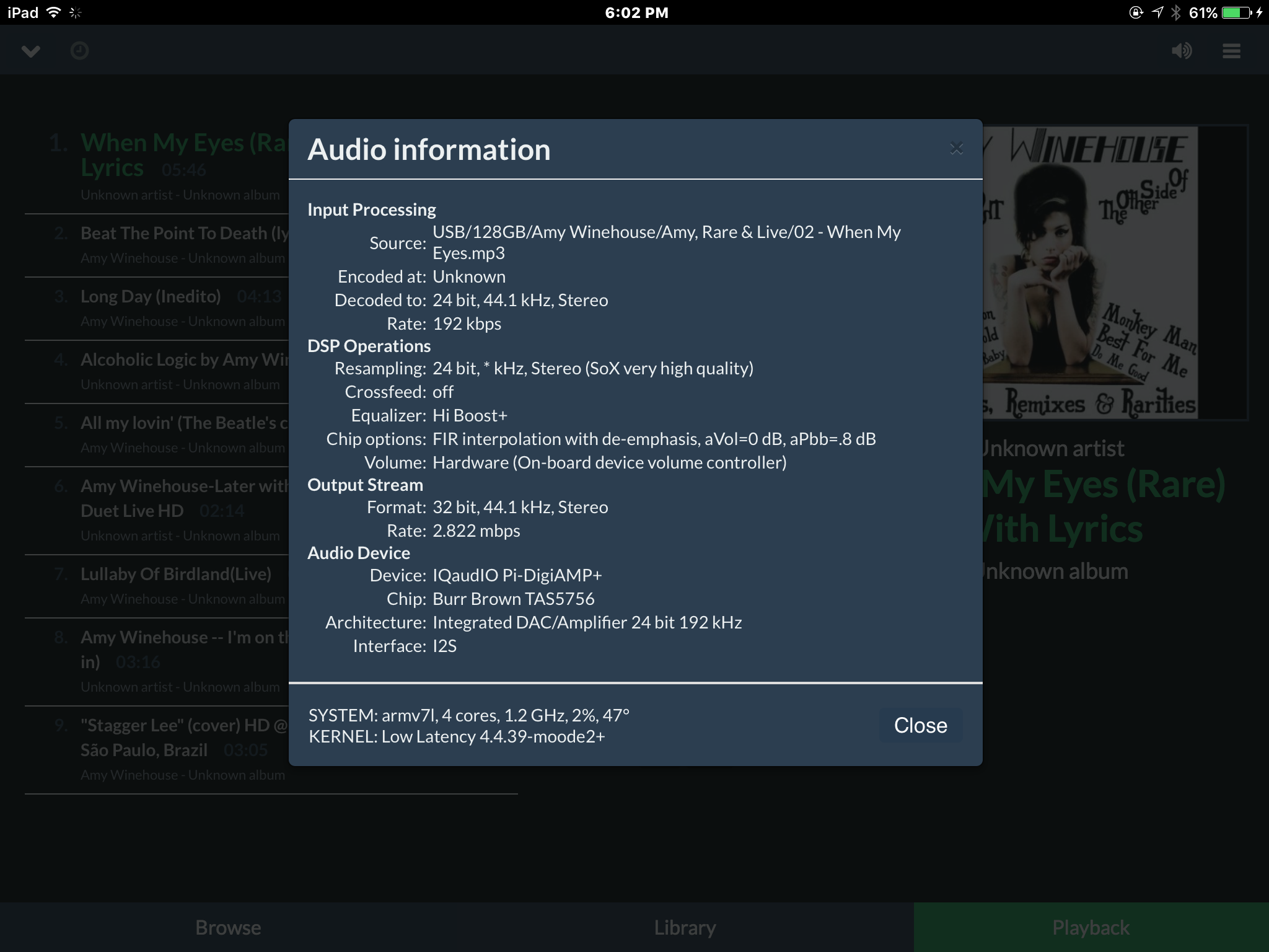

Just muckin about... I changed my sox resampling to 24/*, but when I checked the audio status it said it was decoding to 32-bit, something my IQ Audio digi-Amp+ doesn't handle - sounded fine, but I wonder if there's some calculation amiss?

Yes, it appears the S24_LE and S24_3LE formats are rare within the DACs. I did find some mention of the zero-padding that Tim mentions (although not widely spread).
If that is the case, all is fine! DACs probably understand the zero padded words and everything is OK. I just wanted to make sure that all the effort to do bit-perfect was not being wasted on upsamling within ALSA and bypassing SoX. Otherwise,I would prefer to force everything to 32/*. But if it gets zero-padded, I prefer bit perfect and let the DAC do its thing! :)
Thanks!
Rafa.
