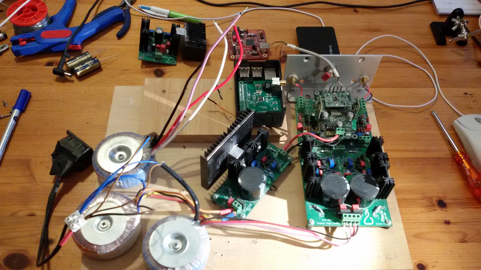

I'm looking to build a Pi-DAC-Moode inside a pre-amp, where I'll have other boards so space is limited. I had not intended to include it but now the idea is growing. The zero-w looks like a good option because of it's size and the built-in wi-fi. I didn't see many folk choosing the zero, presumably because why should they if not space constrained.
Do I give anything up in choosing the zero-w over the larger Pi boards if the goal is to use it 'only' as a music server, e.g. for Spotify and possibly a NAS. Does the zero-w have the performance it needs to give a good user experience with Moode ?
When my chassis arrives (slow boat from China) I may find space for a larger Pi, but don't know yet.
I am currently running MoOde 3.6 on a Pi Zero W with a JustBoom pHAT AMP over WiFi without any issues. I can reliably stream FLAC files that are encoded 24bit 96kHz from a NAS on my network. I am using this set up with a pair of modified Radio Shack Minimus 7's as a streaming BoomBox for porable music around the house and yard.
As others pointed out, putting the Pi Zero W into a metal chassis will severely impede the WiFi signal.
Good luck with your project.
