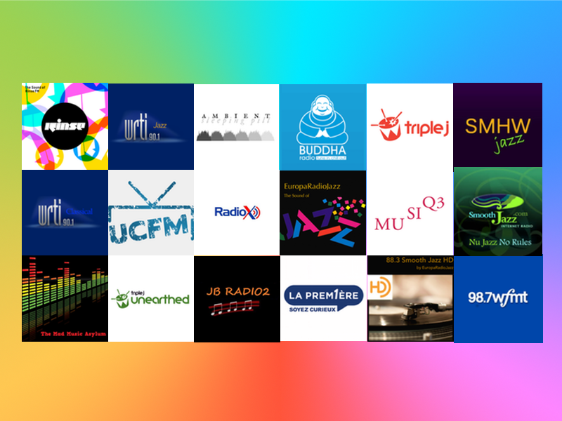

Thanks to Elmar and Kent for the Radio Station link fixes 🙂
JB Radio2 is a newly added Rock station streaming at 320K. EuropaRadioJazz - 88.3 also at 320K. Nice to see more high bitrate broadcasters.
-Tim
