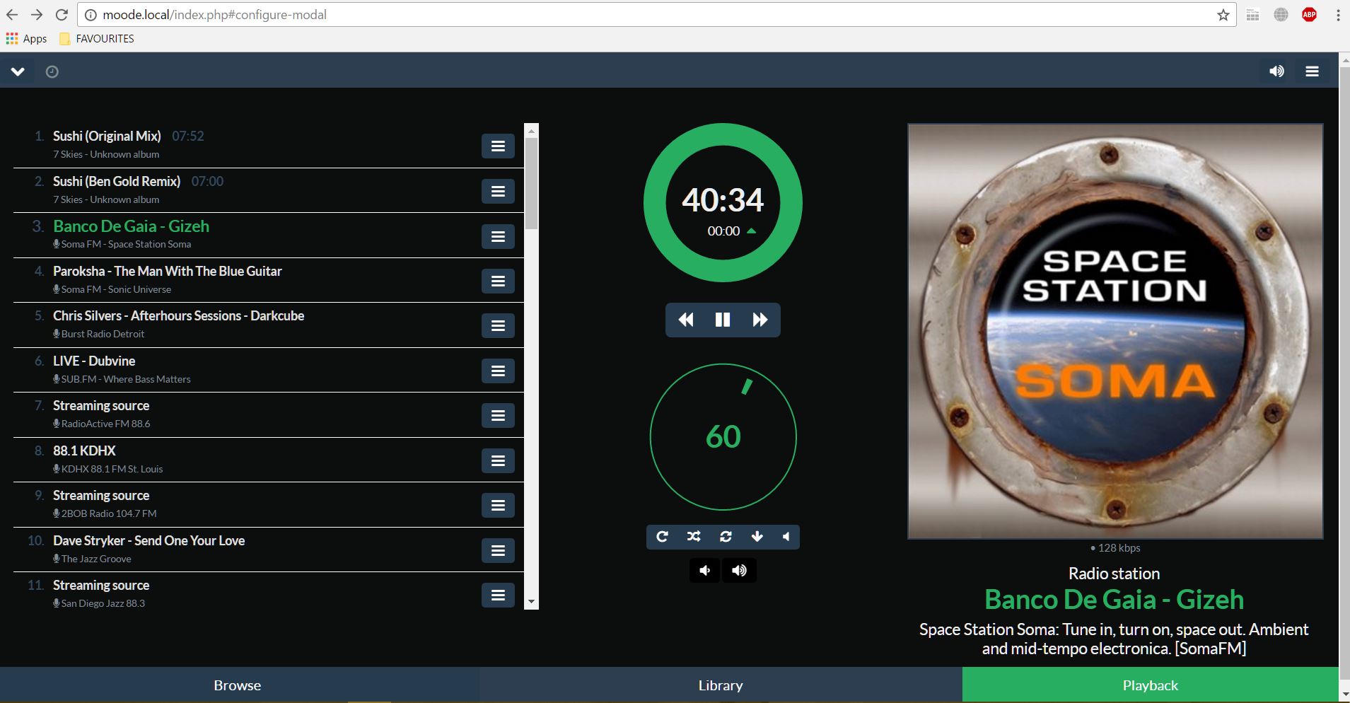

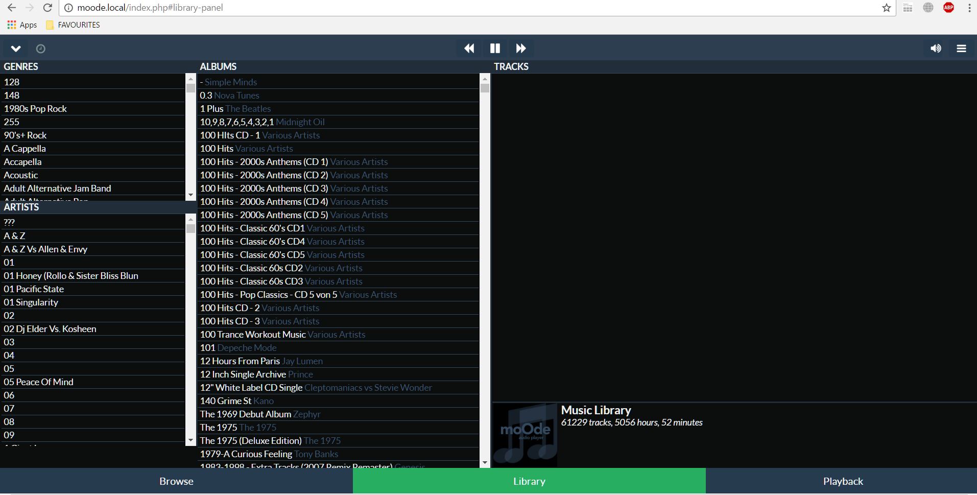

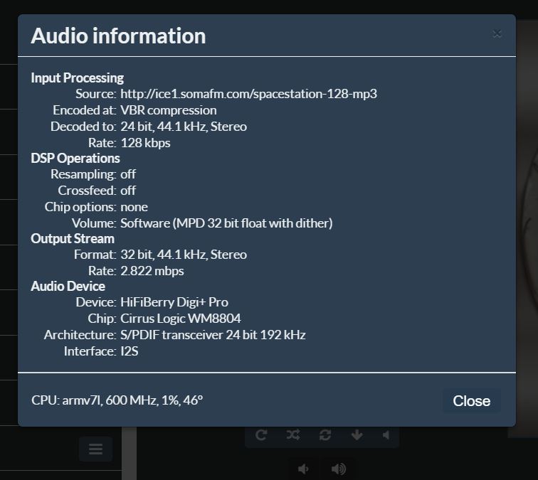

Thanks for your suggestion for sorting my audio problem which didn't make any discernible difference. Perhaps I have an Ethernet problem. I've reset everything and completely reinstalled MoOde precisely as per the setup instructions. Still no audio on PC browser. All the MoOde UI visuals on PC browser perform as expected but no audio. Listening directly to the Pi output through the coax and the AVR the audio is quite impressive, but nothing through the PC browser. You obviously know all there is to know about the MoOde program but can you offer any further help?

Moode and the HiFiBerry are working perfectly. The GUI is just that - graphical. Sorry if you misunderstood Moodes functionality, but there is no sound output from the PC. Moode is not designed to provide such output, only to provide an I2S output for processing by a DAC or I2S to SPDIF conversion as in the HiFiberry Digi.

As @BackinBlack mentioned, audio is only output by Pi. The Browser just renders the User Interface.
