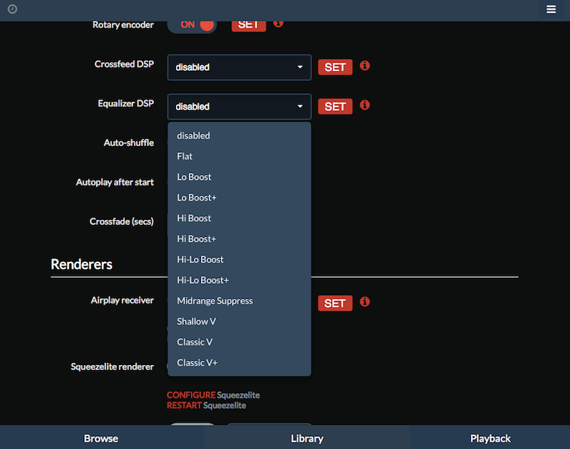

Hi Tim, in post #6745, the Audio Configuration screenshot, could you tell us a bit more about the Equalizer DSP item? or maybe link to a post? My search-fu has failed.
I'm hoping for a connection to BruteFIR or something similar. THAT would be cool.
Thanks a bunch
Michael
Thanks a bunch
Michael
Hi Michael,
The EQ is an implementation of alsaequal that was created by user @YvonL. It includes a list of preset curves and is meant for providing a basic set of adjustments, mainly for headphone use I would imagine.
Something like BruteFIR is possible but would require a substantial work effort.
-Tim

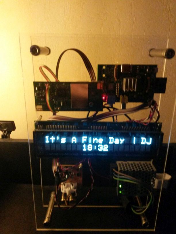

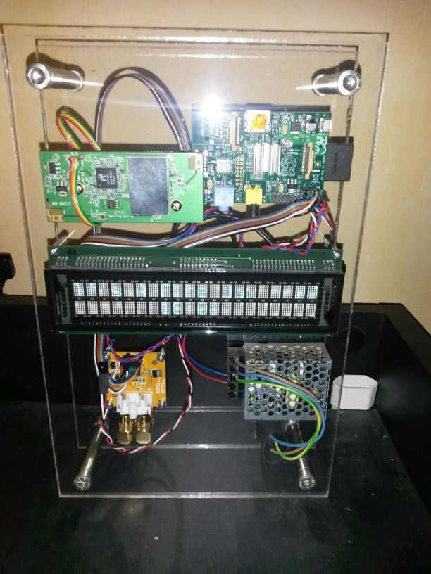

Adding 20x4 LCD
I have seen some examples on the web (not moode) where the LCD has been added to Pi. Moode outputs the song information which I would like to display on the LCD. I am not good at programming and would like to know what exactly needs to be done to incorporate the display?
thanks,
Dinesh

Re: Adding 20x4 LCD
An easy way to get the LCD running is to use the combination of mpdlcd and lcdproc.
Here you can find a manual by andypi.
Another way is to read the /var/www/currentsong.txt and writing it to the LCD by python. There are several python scripts depending on your kind of Display (HD44780, etc) on the internet.
I have experience with the first way and took this solution with a serial connected VFD.
