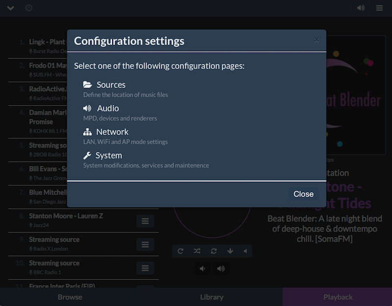

Hi Tim,
Yes, you can use Access Point mode. Just connect tablet to SSID Moode, pwd=moodeaudio and then from Browser http: //moode.local or http:// 172.24.1.1 and you will get the UI. Follow Moode Setup Guide.

Thanks Tim for this answer. And thanks Tim for the question. I had no idea this was possible, and it is exactly what I was looking for to control a Moode Audio box remotely without a wifi signal or ethernet wire.
Just to reiterate for anyone else like me, in Configuration settings, Network, leave SSID blank. Then Moode Audio will send out a wifi signal which you can connect to with the SSID and pwd show above. After wifi connection, direct your browser to either address Tim provided above. My Android phone asked to confirm the wifi connection because there was no internet connectivity. Just accepted that and you have a direct connection between phone (or tablet, laptop, whatever) to Moode Audio.

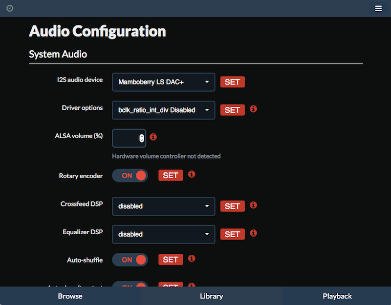

Added Driver options for I2S devices and made a first pass at streamlining Audio config to make it a bit easier to use. Thanks to inmate SC for some nice ideas 🙂 The driver options are only available under the Advanced Audio Kernels and provide Enable/Disable for the two dtoverlay params below.
1) bclk_ratio_int_div
Integer balk divider for ES9023 48/96 kHz rates.
2) slave
Slave mode for Allo Boss DAC enabling it to work with Allo Kali reclocker
-Tim

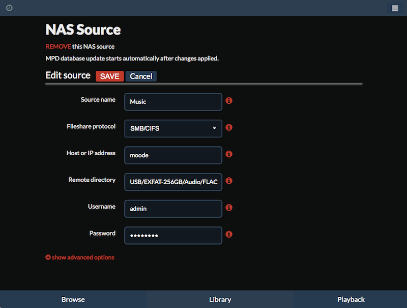

I hope someone can help.
I've messed up adding a NAS source so now the the Moode UI hangs when I try to remove it. How can I remove this source via the CLI through SSH? I'd rather not reinstall from scratch again.
View contents of table
sudo sqlite3 /var/www/db/player.db "select * from cfg_source"
Delete contents
sudo sqlite3 /var/www/db/player.db "delete * from cfg_source"
Btw, what do you mean "messed up adding a NAS source"? Maybe I can add or modify code to handle this scenario.
-Tim

Hi Tim,
I'm afraid you're going to have to walk me through. Do I just type in those commands?
Okay, that's the output from the first command:
1|Moode|cifs|10.0.0.69||||utf8|61440|65536|cache=strict,ro,dir_mode=0777,file_mode=0777|username specified with no parameter
From the second I get this:
Error: near "*": syntax error
My mistake... try it without the splat (*)
sudo sqlite3 /var/www/db/player.db "delete from cfg_source"
I think issue is blank username param. I'll have to look at the code to see whether it handles this condition.
If your CIFS share is not password protected try just specifying a bogus userid and password when you create the NAS source. I use "admin" and "password".
-Tim

Thanks for your prompt help Tim. That's done the trick.
I have two moode boxes, and I was trying to share the files on USB sticks in each of them, between them. (If that makes sense!).
I've always found setting up NAS sources a trial and error process using that config tool. It's my lack of understanding how it works. I would rather it searched for samba/NFS shares on the network, but I know that would require lots more coding on your part.
In the meantime I'm happy just to listen to music off my usb stick.
I use a Pi3 that runs my moode reference image as a Samba NAS. It has a USB SSD attached and works just fine.
When u set up your NAS source enter a dummy userid and password and it should work.
