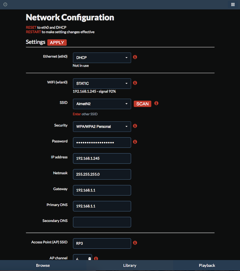

I ran a quick test and no issues with static address assignment for wlan0. The cmd below shows there is only one ip address assigned to wlan0, the static address. Access via http: //192.168.1.245 or http: //rp3.local works perfectly.
pi@rp3:~ $ ip addr show wlan0
3: wlan0: <BROADCAST,MULTICAST,UP,LOWER_UP> mtu 1500 qdisc mq state UP group default qlen 1000
link/ether 74:da:38:0a:1b:78 brd ff:ff:ff:ff:ff:ff
inet 192.168.1.245/24 brd 192.168.1.255 scope global wlan0
valid_lft forever preferred_lft forever
inet6 fe80::76da:38ff:fe0a:1b78/64 scope link
pi@rp3:~ $
Note: If u are running a Hifiberry DAC+ Pro, the oscillators on the board emit RF that kills WiFi on Pi3. Contact Hifiberry for support. https://github.com/raspberrypi/linux/issues/1588
-Tim
