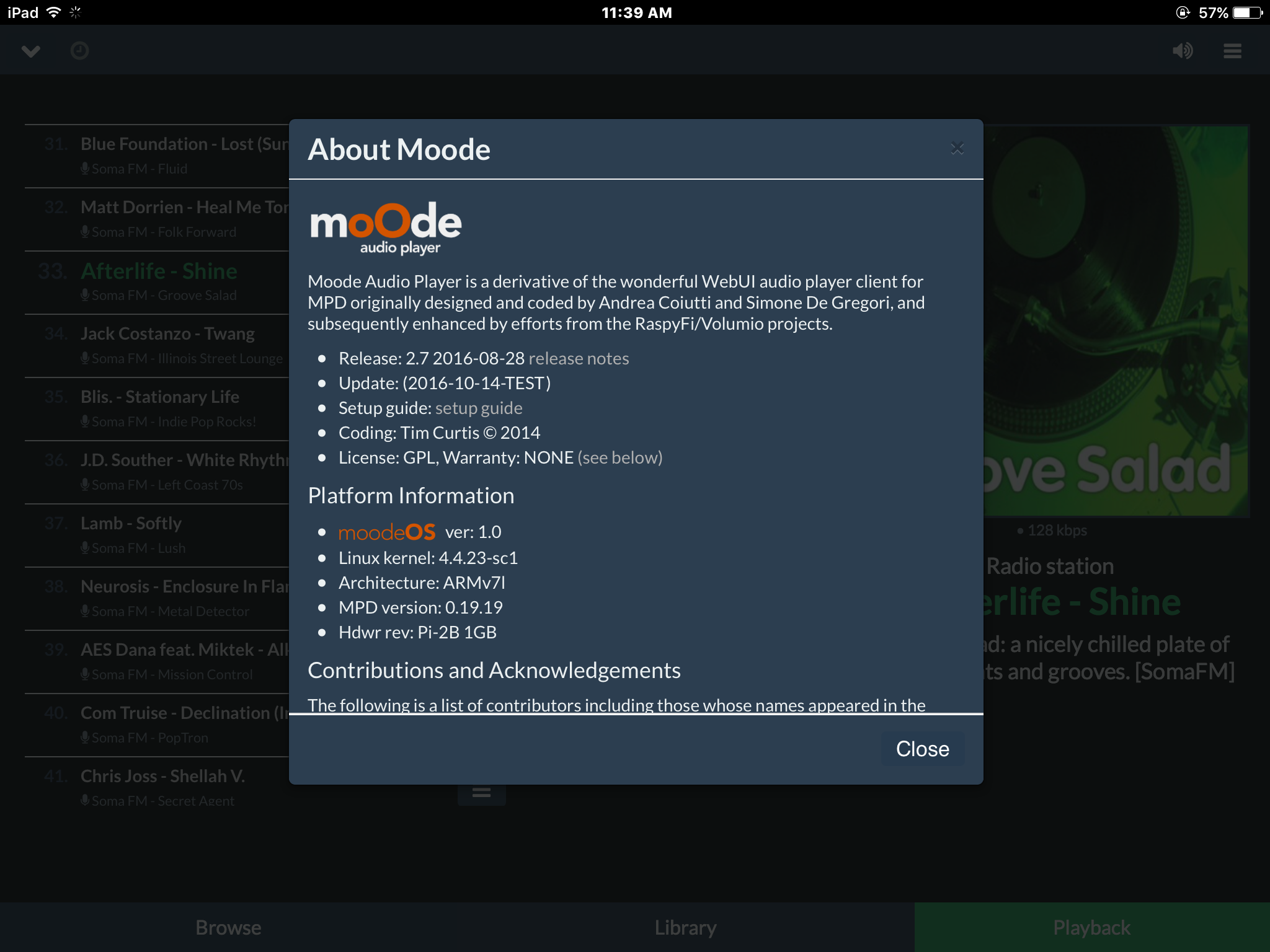

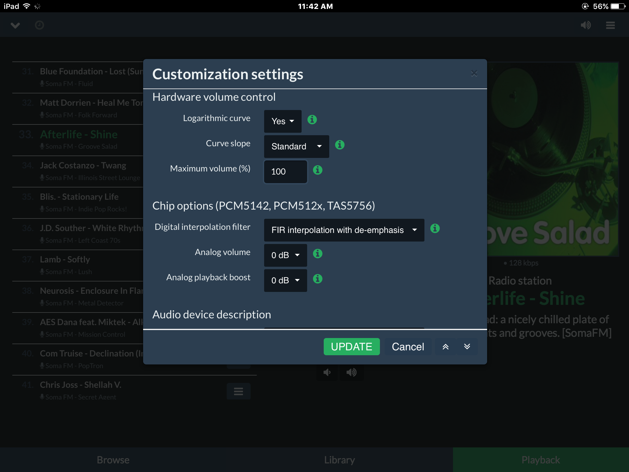

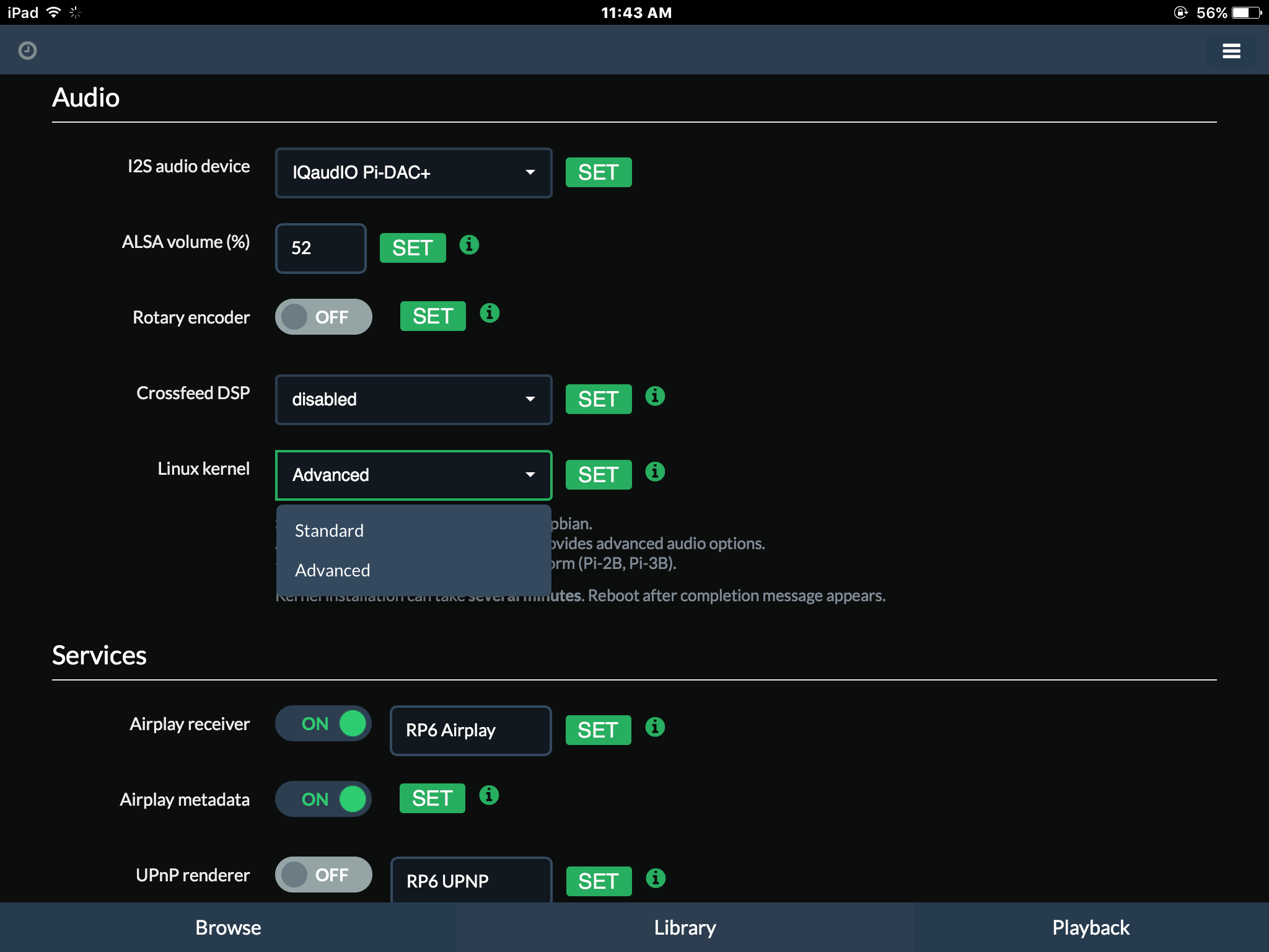

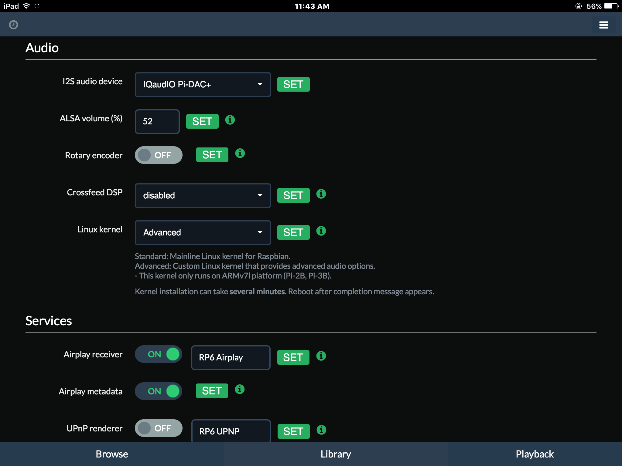

I was able to include the Advance Audio Kernel in the upcoming Moode 2.7 update by implementing a Kernel select feature on System config 🙂 Screenshots attached.
There are two kernels, Standard and Advanced. The standard kernel is a mainline Raspbian kernel which in this case is 4.4.23. The advanced kernel is based on 4.4.23 and custom built by the inmates to make 4.4.23-sc1. This kernel provide important audio capabilities as listed below. These capabilities are not available in mainline kernels.

The other new feature shown in the screen shots is improved handling of chip options for the Burr Brown family of chips including PCM514x, PCM512x and TAS5756.

Zowie! No wonder you've been quiet in the forum, Tim. Full props to you.
