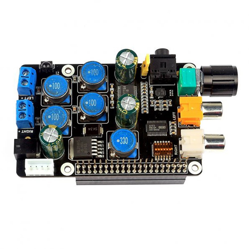

correct l2S configuration for X400 expansion board
This is DAC+amplifier combo, reportedly works in moodeaudio.
Installed on RPi2 but no sound.
A. what should be the correct l2S configuration?
B. should be hardware volume?
ordered here: https://www.amazon.com/gp/product/B0140P8PF2/ref=oh_aui_detailpage_o04_s00?ie=UTF8&psc=1
appreciate any help.

Are you using Moode 2.7, and have you tried the I2S setting for Suptronics x400? It's the same board, I think.
John
