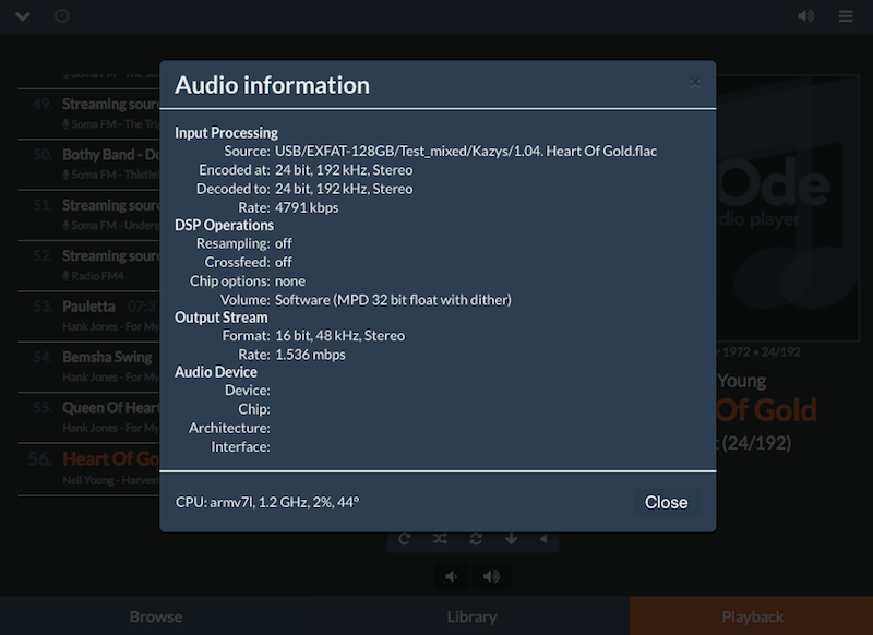

Hi Tim,
Great player, love it. But is there any chance you add such a nice feature like crossfade? https://en.wikipedia.org/wiki/Fade_(audio_engineering)#Crossfading
I use it with Kodi @random and it's great for parties and background music - no gaps like virtual DJ. 🙂
Bugs:
Found that DTS audio is only noise and DSD plays with no audio. 24bit flacs are converted to 16bit. I use rPi2 - > HDMI -> Marantz receiver
Possibly 🙂 MPD has a crossfade <secs> command. When u use crossfade with Kodi do u just set num secs for fade then toggle it on/off as desired?
Wrt issues
1) DTS audio is only noise
AFAIK MPD can't decode DTS audio format.
2) DSD plays with no audio
Try turning DoP off in MPD config screen
3) 24bit flacs are converted to 16bit using HDMI
I recall HDMI driver is capable of up to 24/192 rate but ships with only 16/48 rate enabled.
-Tim

2) That did the trick! Thanks!
3) Kodi and Raspbian have no problem of 24/192 playback. I connected to 24/192 capable receiver through HDMI
https://www.raspberrypi.org/forums/viewtopic.php?t=25810

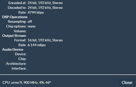

When u say Kodi and Raspbian, did u verify 24/192 over HDMI on a stock Raspbian Jessie OS?
I tested with my Yamaha RX-V661 AVR which supports 24/192 and I see ALSA resampling to 16/48 which suggests the stock HDMI audio driver in kernel 4.4.13 that I'm running w/Moode uses does not have the updates that enable up to 24/192.
To support 24/192 over HDMI the Kodi devs must make their own custom kernel.
When u try 24/192 HDMI on your Marantz, what is output from the command below?
cat /proc/asound/card0/pcm0p/sub0/hw_params
-Tim

pi@moode:~ $ cat /proc/asound/card0/pcm0p/sub0/hw_paramsWhen u try 24/192 HDMI on your Marantz, what is output from the command below?
-Tim
access: RW_INTERLEAVED
format: S16_LE
subformat: STD
channels: 2
rate: 192000 (192000/1)
period_size: 4096
buffer_size: 16384
Tried now Jessie OS and vlc without success, only 16/48. With Kodi I use audio passthrough, can't find this in Moode/Jessie.Hi,
format: S16_LE
subformat: STD
channels: 2
period_size: 4096
buffer_size: 16384
Interesting. The result suggests:
1) updated HDMI driver that supports 24/192 is part of Jessie
2) ALSA not happy with 24 bit to your AVR
3) In my case ALSA only allows 16/48 to my AVR
It could be bug in ALSA when it queries the EDID from the HDMI device to see what capabilities it supports.
If I run cmd below it shows 24/192 PCM capability for my AVR, yet only 16/48 from ALSA. Very odd.
pi@rp5:~ $ tvservice -a
PCM supported: Max channels: 8, Max samplerate: 192kHz, Max samplesize 24 bits.
AC3 supported: Max channels: 6, Max samplerate: 48kHz, Max rate 640 kb/s.
DTS supported: Max channels: 7, Max samplerate: 96kHz, Max rate 1536 kb/s.
-Tim
