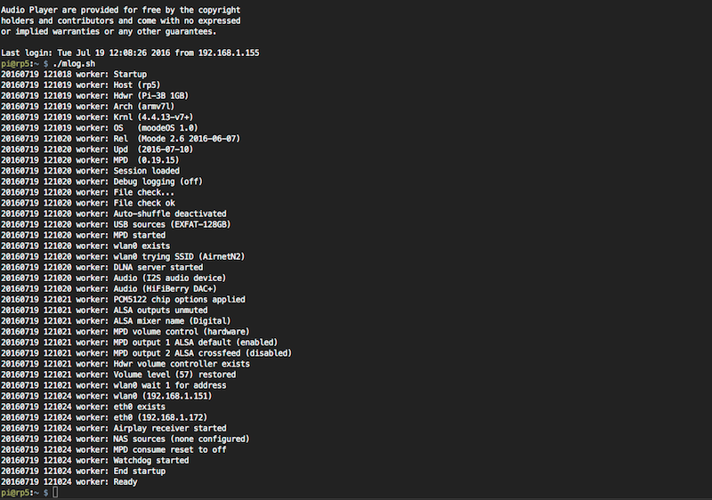

I have an RPI3 with HiFiBerry Dac+. (moodeaudio 2.6 Image + latest update yesterday + latest kernel update). All Functions with eth0 are ok. My Problem is using the wlan0. It's not possible to connect with wlan0 static or dhcp to an AP. Additional Problem is, when eth0 is also connected (same Network) - the eth0 receive only an ip over dhcp but is not connectable. Only running in a external wlan (outside from the defined SSID - the eth0 is running ok. Same RPI3 with other Image (exampl. volumio or Jessie Image) and use the wlan0 are ok. On booting moodeaudio the wlan0 is visible, up but without ip-address. Command "iwlist wlan scan" brings no result. Only "if-down wlan0" and following "if-up wlan0" brings the visible SSID's. When boot without eth0 connected, the wlan0 send to the dhcpd-server (pfsense) receive an dhcp-discover message with hardcoded ip "192.168.1.x". Do you have some Information for using moode with RP3+wlan0.
see also last "dmesg" Infos:
bcm2708_i2c 3f804000.i2c: BSC1 Controller at 0x3f804000 (irq 83) (baudrate 100000)
[ 16.434405] snd-rpi-hifiberry-dacplus soc:sound: ASoC: CODEC DAI pcm512x-hifi not registered
[ 16.434431] snd-rpi-hifiberry-dacplus soc:sound: snd_soc_register_card() failed: -517
[ 16.500205] sd 0:0:0:0: Attached scsi generic sg0 type 0
[ 16.606747] snd-rpi-hifiberry-dacplus soc:sound: ASoC: CODEC DAI pcm512x-hifi not registered
[ 16.606774] snd-rpi-hifiberry-dacplus soc:sound: snd_soc_register_card() failed: -517

Thanks for any comment.
Best Regards
Siegbert

Hi Siegbert,
I'm not able to repro the "no wlan0 address assigned" issue using Pi3 with HiFiberry DAC+ and both eth0 and wlan0 interfaces connected. The DAC+ and DAC+Pro use the same I2S driver.
What I'm not seeing in Moode log are the lines below which suggest an incomplete configuration following the 2016-07-10 update.
20160719 121724 worker: MPD output 1 ALSA default (enabled)
20160719 121724 worker: MPD output 2 ALSA crossfeed (disabled)
The update instructions are available via the VIEW button on System config or in the diyAudio post referenced in my Update announcement on Twitter.
"After reboot APPLY MPD config then toggle Crossfeed setting on System config to establish Crossfeed/MPD outputs. Verify by "mpc outputs" which should show ALSA default enabled and ALSA crossfeed disabled."
The way I would troubleshoot is:
1) Test with fresh Moode 2.6 image
2) Test after installing Updater.sh and the 2016-07-10 update, and make all post-reboot configuration steps
3) Test after updating to 4.4.15 kernel
-Tim
