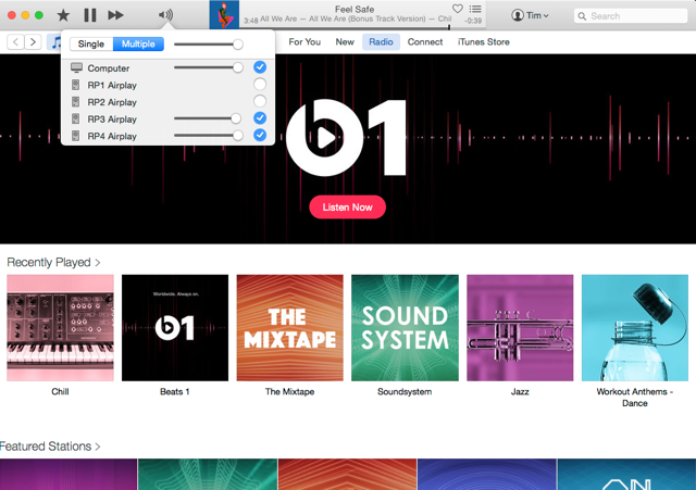

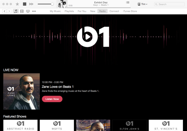

I've been testing Mike Brady's excellent shairport-sync Airplay receiver and it looks solid for Moode release 2.2
Here's something odd though with Apple music and Airplay.
When playing Beats 1 the multi-select volume control with the list of Airplay receivers is replaced by a single volume slider. Airplay has to be selected from the OS X system volume control via Option-click, and only one Airplay receiver can be selected.
This only occurs with Beats 1 and does not happen with the other Apple Music radio stations or with song file playback. See attached screen shots of Beats 1 playing vs the Chill station.
TC

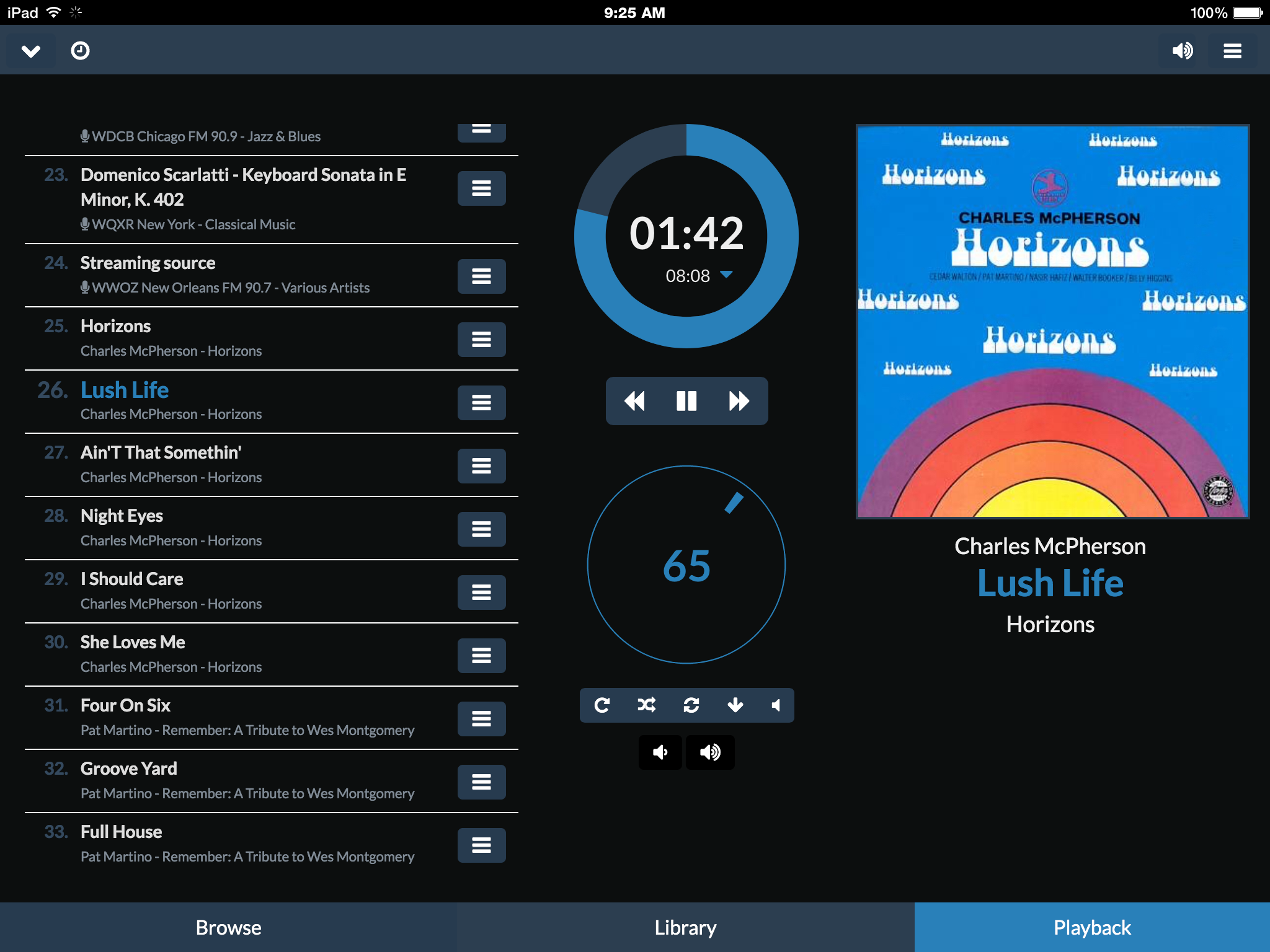

Hi Tim,
I need to write here to say thank you! I'm proud owner of an IQAudio DigiAMP+ connected to Raspi B+. After spending hours with runeaudio, Gordon from IQ suggested Moode. To make it short: wherever I got stuck in rune (which is basically everywhere), Moode simply works. EXCELLENT!
A couple of points seemed odd and I'm listing those below, but none of those are showstoppers. Listing in no particular order, if not of interest to be fixed feel free to ignore.
1. After I had used Configure/System to set I2S device to digiamp. After doing so (as far as I remember including reboot), Customize->Audio device description still didn't show digiamp. I'm unsure if this is just fyi, but it would be nice to adjust this when system config changes.
2. First time I used "Turn off" Moode immediately rebooted before I could even click the button. Also, web ui did not reconnect after the reboot but kept sitting at the reboot screen (this page will reconnect.... but it doesn't).
3. While MPD settings have a convenient "Apply" button, system settings have a "Set" per individual setting. This is confusing and inconvenient.
4. Listening to web radio and connecting to Moode via MPoD or MPaD on iPhone/iPad, the radio station name is not shown. Also, always "Unknown Artist" is shown.
5. Browse->Web Radio offers Add/Add and play/Add replace and play. Imho it would be nice to have Add replace and play as the default option that is triggered when clicking the radio station (not the small menu), similar to switching radio stations on a normal radio.
6. On iPad, the Playback ui is sometimes corruped: playing time is shown double and volume control vanishes. Can provide screenshots if helpful.
7. Not sure how to make MPoD show album covers. Could you advice which URL need be used?
8. Airplay- working fine from iPad but not visible on iPhone. As both are on iOS9 beta this may not really be an issue. When device is airplaying to Moode, track and cover are not visible. Also, Playback does not allow to "Play" library content before AirPlay is being stopped from device. It would be nice if Moode ui was allowed to take precence over running airplay.
9. I have quite an extensive library which is scanned from SMB and shows up in MPoD. It does not however show any contents (=0 tracks) in the Library window. It does load a while but then comes back without results. Potentially PHP timeout? Local caching in browser possible? Would be happy to diagnose, e.g. from the ajax requests being executed.
10. SMB shares. Opposed to rune they simply work. Great stuff!
11. Would be interested in root pw and how to upgrade a running Moode image to latest (dev) version without re-imaging.
I would be happy to help improving Moode- anything I can do please let me know.
