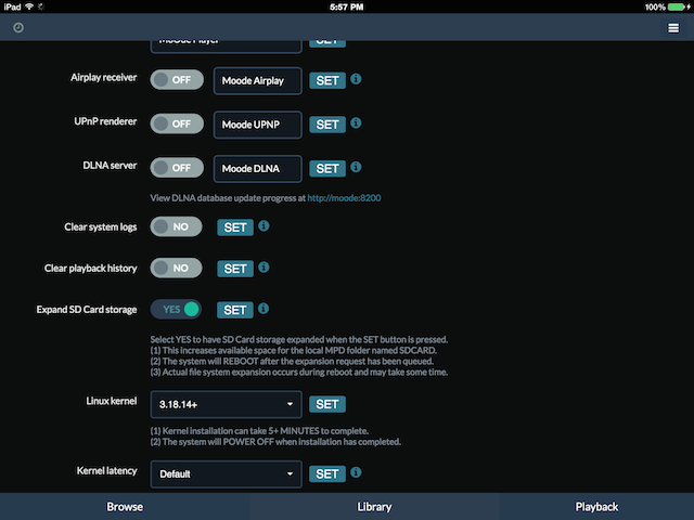

Moode 2.1 Test Release #1 is available for download at moodeaudio.org via the Test Code button.
This test release includes the following:
(1) Expand SD Card Storage
(2) SDCARD folder on Browse panel
(3) SDCARD, USB2/3/4 samba share names
(4) Disable volume knob when MPD volume control set to disabled
Refer to attached screen shots. Enjoy!

Works great! Thanks for all the work. Once the SD expansion is set up it shows up automatically in Windows explorer under Network, which makes it easy to transfer over files. Once files are on the SD card (transfer rate is a bit slow), you just have to update the mpd database. This will also be good for adding other stuff on top of Moode. When I tried to recompile MPD I previously ran out of space, but hoping this should make it work.

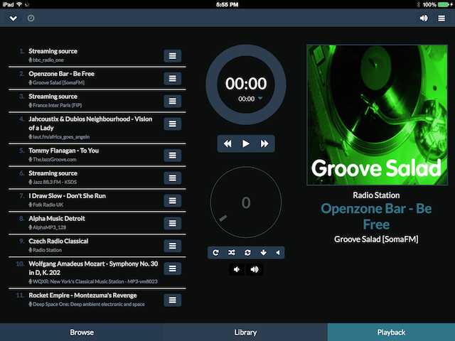

Very odd.
My music collection is mostly CD rips to ALAC using iTunes prior to version 12 but it also includes some iTunes AAC downloads, a few other formats for example FLAC and AIFF, and CD's ripped to ALAC using latest version 12.x
Please zip up a few of the files and either email me the zip or a download link to the zip and I'll test them out. Email to tim at tcmods dot org.
Tim
I reported the same thing a few pages back... remember when I said it was reporting all my tracks as radio stations?

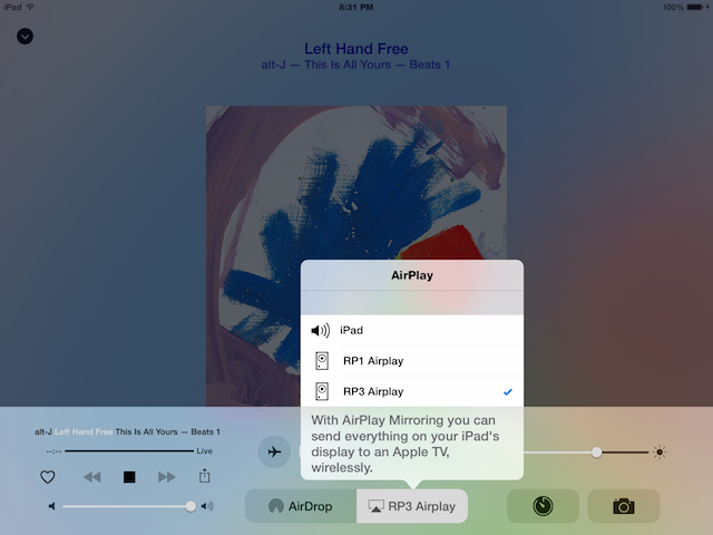

Just one small annoyance with Moode 2.0
Airplay receiver is on in Moode but iPad is having difficulty seeing Moode in Airplay to play Apple Music.
Only way to get it working is to turn off Airplay in Moode, reboot then turn it back on and reboot. Then Moode appears in Airplay. Tried going into aeroplane mode and off but this doesn't help.

I just tested using iPad mini and iPod touch (latest IOS version) and did not experience any issues. I'm running Moode 2.1 test release 1 and not 2.0, but there have not been any changes whatsoever in Airplay (Shairport) since 1.0 !
Send email to tim at moodeaudio dot org and I'll help troubleshoot 🙂

Airplay worked ok for me in Moode 2.0, 2.1 as well as the prior version using an iPad mini. From fresh install, I just turned on airplay and then rebooted.
