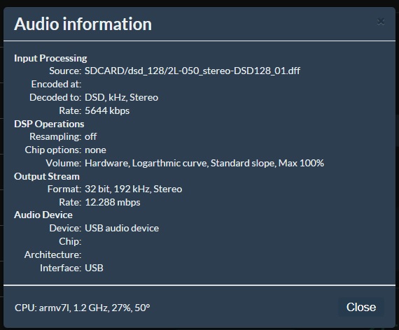

Hi Tim,
I'm playing dsd files with external DAC (Fiio X5 gen II) on moode tr3, so far so good but; is there anything wrong with output stream? and anyway for me to update audio device info?
BR

Hi Tim,
BR
I don't have any DFF in my test collection but if u zip up one of the files and send me a download link I'll analyze it. Looks like the "Decoded to" field is missing a value for "kHz" on the Audio Info screen, and I'd like to understand what component in the audio pipeline is resampling to 32/192.
If u are familiar with SQLiteStudio util then you could add your audio device to the cfg_audiodev table in database /var/www/db/player.db.
I'll plan to include Fiio X5 gen II in 2.6.
