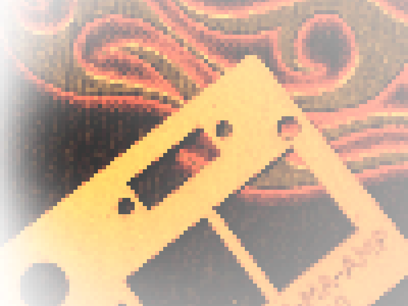

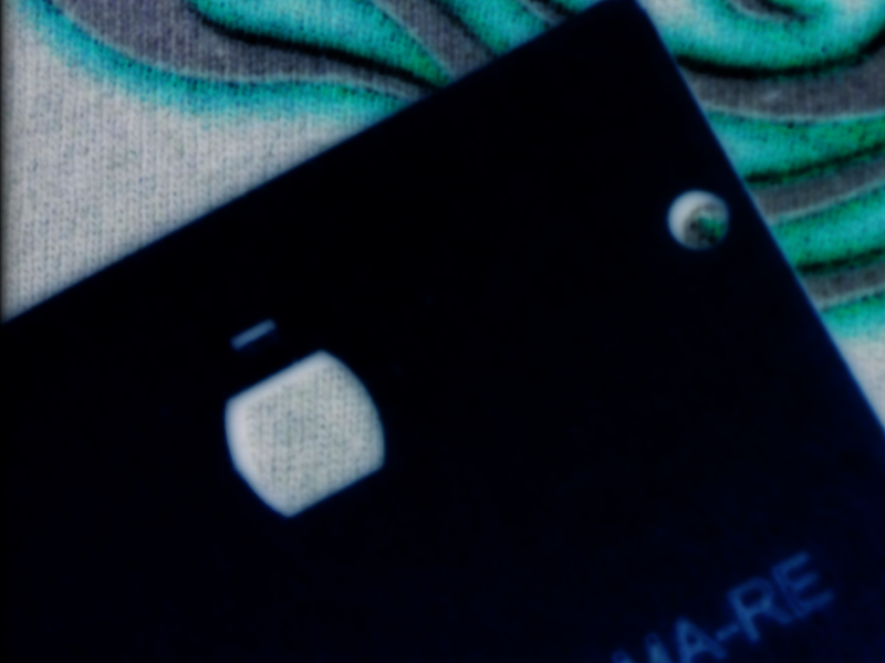

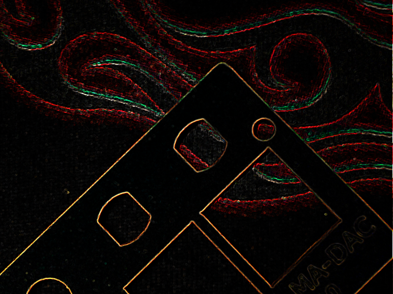

Here's a few MoodeCase panel shots :) Perfectly machined for precise enclosure and component fit.
Front panel configurations include with and w/o RE, materials include powder coat Metal, clear or dark gray transparent Acrylic. Rear panels are powder coat metal and come in DAC, AMP and DIY layouts.
