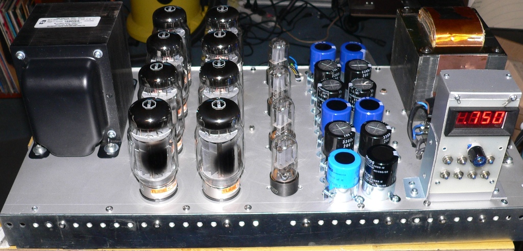

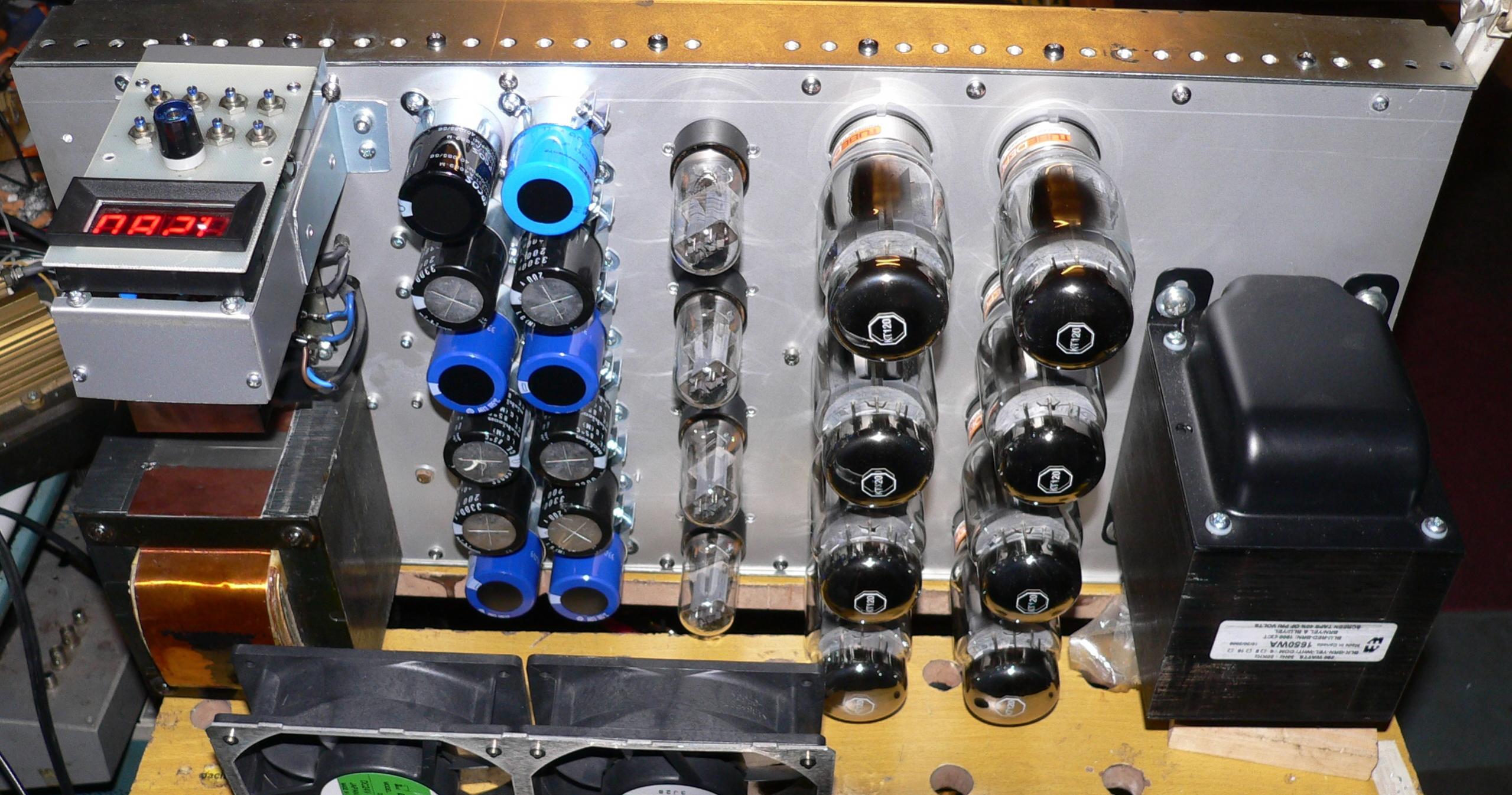

This was a project that I started about 10 years ago. I'm not sure how much power it makes but it is at least 500 watts. On the 10x probe the waveforms were going off-screen on my scope that I was using at the time to view the waveform. Its an OTL, and makes its greatest output power into about a 3 ohm load.
You can test the power tubes on the fly. It has a built-in AC line voltage regulator, so if the line sags to 100V it will still make full power. There are plenty of meters, you can see the line voltage, the corrected line voltage, the output of the amp, any DC it may have and also the results from the tube tester. The whole amp is wired point to point. Bias and DC offset (the output of the amp is direct-coupled) are automatic.

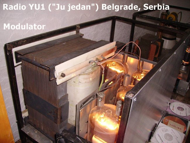

Hi Satelitis !
Here is some older pictures of my friend - chika Dule ( Yu1 ) - MW ( Midlle Wave 1,6 -1,8 MHz ) pirate DIY tube transmitter equipment :
Modulator ( B-class AF amplifier ) consist from four Russian GU81M power tubes , running at 3,5KV UBa , there on that chassis is some other smaller AF input/driver tubes to .
Transmitter output power tube is some Russian middle power coaxial ceramic tetrode running in C class , plate /G2 modulation , with scaling UBa from 4 up to 7,5KV , producing up to 5KW of pure carrier signal power , driver tube is GK71 , buffer tube is GU50 , and basic VFO oscillator is EL84 tube .
Inside of this small radio pirate studio neon light tubes lighting without to be wired , started to light being excited from transmitter huge electromagnetic field .
This tube transmitter signal and program is heard loud and clear on Japan ,which distance is about 12ooo miles far away .
Best Regards !
