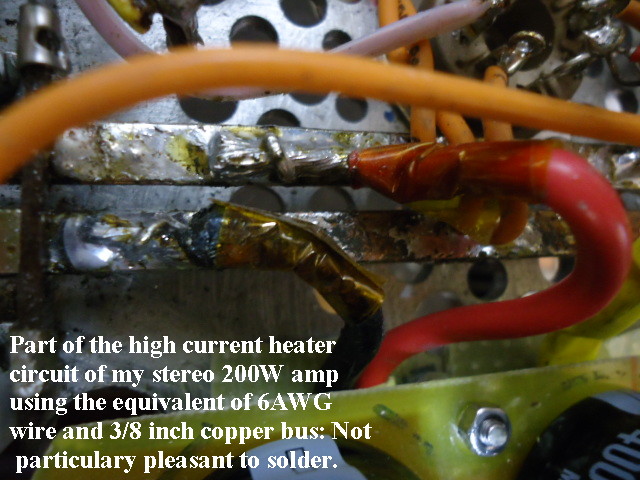

Correct. A bit of a distraction since I get carried away working late at night.....The bit that troubles me about using large numbers of tubes is a welding sized winding required for the heater supplies unless one puts sets of tubes in series and ramps up on the volts to reduce the CSA. A long time ago I did a 16 tube amp using 6550's not realising this tube is mighty sensitive to heater volts variations and learn't my lesson from it. Eventually it was near impossible to rewire it so I busted it up.
Appropo heater windings. It's the easiest way to annoy a transformer winder; to specify a high current low voltage winding with a pretty precise figure; in which the wiring run resistance losses should to be put into the equation. However, we all learn, so I adopted the similiar busbar method for my parallel 4's using EH KT90's which are far less critical to heater voltage variations.
The lower working Z of a multiple tetrodes configured as triodes is a tempter; but I've found with a good design I've fooled many in believing a well designed parallel p-p UL stage can sound just as good as triode, the bonus is far more power and fewer tubes, so I've stayed with the concept.

^yup that is why i added a second power traffo, 4 24v secondaries rated at 4 amps each is more than enough......the input/driver tubes also got their own 12.6 volt center tapped heater supplies....
all heaters are dc lifted to just below 1/4 B+......
these measures along with a generous filtering using 12 x 3inch 1000/450vdc filter filter caps in a CRCRC config and forward biased diodes separating both channels, made for a dead quiet amplifier.......
