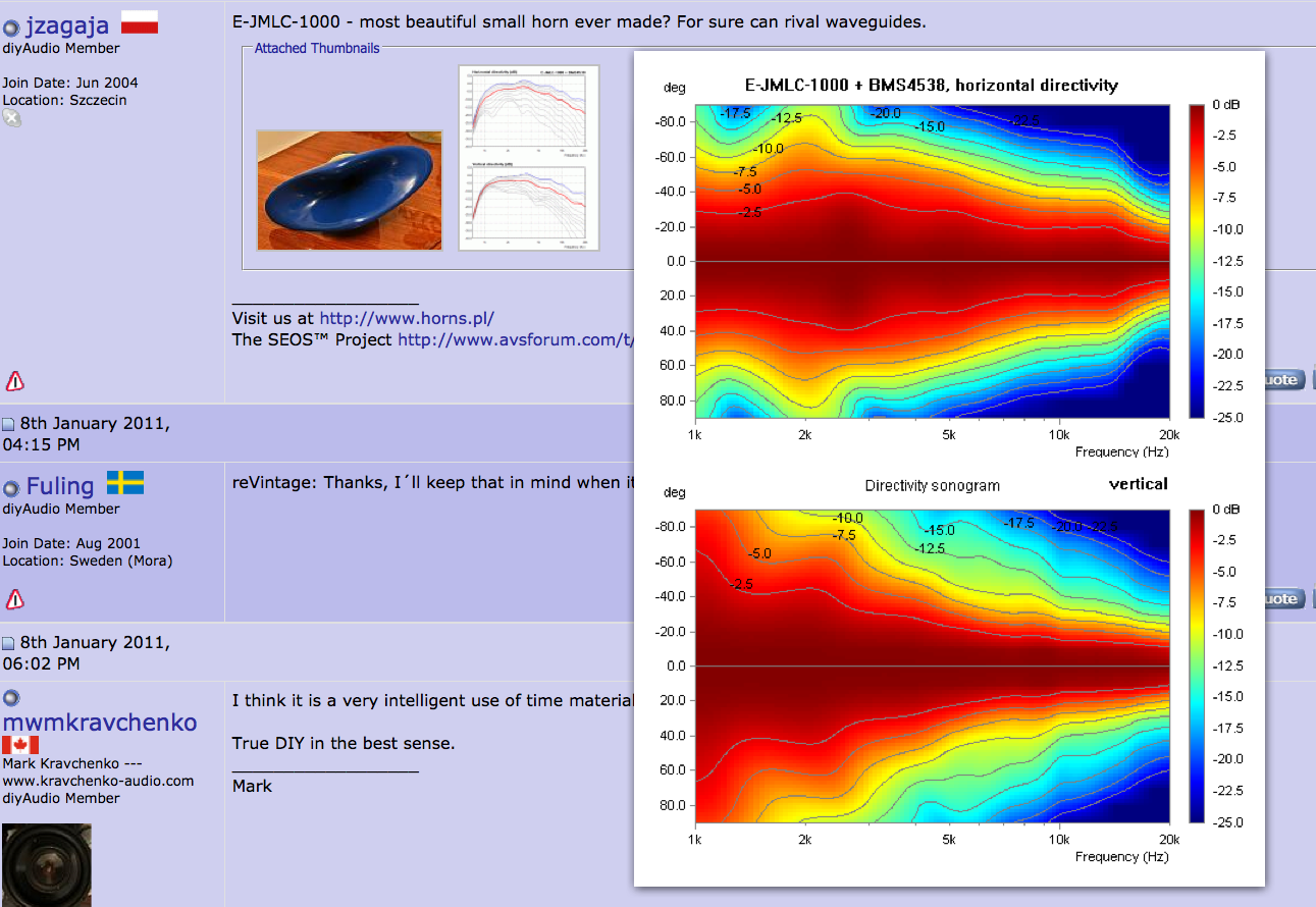

In all the "real life" measurements I have seen, the HF follows the initial throat angle, unless the throat is pinched below a wavelength wide and then diffracted, generally avoided for Hi-Fi use.
A large roundover will reduce diffraction effects, but won't change the HF dispersion.
By increasing the mouth dimension, it may provide pattern control to a lower frequency.
Take a look at the E-JMLC-1000 ( the first one I happened to find), goes from a -6 beamwidth of around 20 degrees vertical at 10,000 Hz to 80 degrees at 2000 Hz. At 20 kHz, you tell me, 8 degrees?
Even horizontally, looks like about 30 degrees at 16 kHz, 40 at 10 kHz.

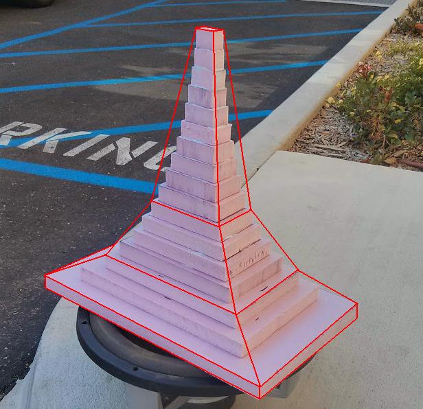

Initially I was going to 'approximate' the shape of a LeCleach curve, by combining a conical horn with a humongous roundover.
Cosmetically, it looked like crap. I don't have a table saw, and trying to do the angles for a conical horn with a bandsaw didn't work out so hot.
So I went back to the method that has always worked well for me:
I'm making a mold.
I'm using seventeen 1" layers of foamular.
The height and width of the horn follow the golden ratio.
If you look at the mold, it has stair steps like a flower pot in a Devo video.
I had to use a rasp, a file, and some sandpaper to make it match the curve we see in Hornresp.
Here's a pic showing the size of the horn in comparison to my Vandersteen 2Cs.
I plan on orienting the horn vertically, similar to what JBL does with their Synthesis 1400 array.
