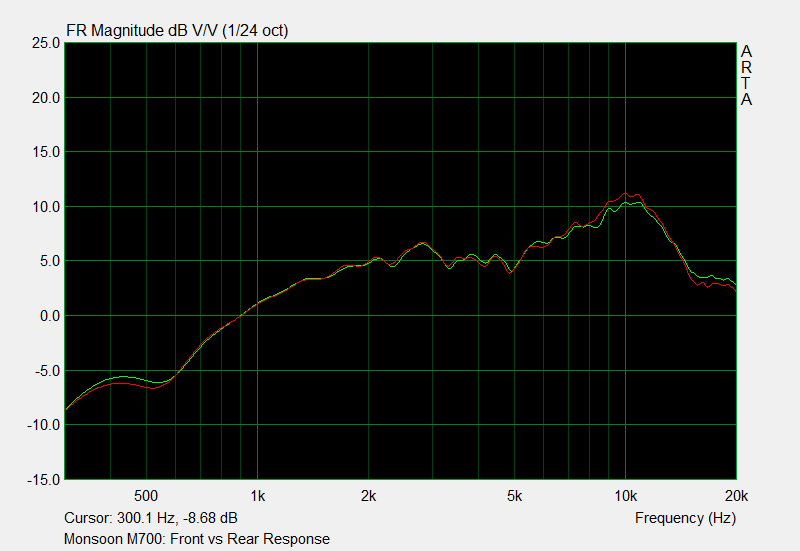

I bought a lot of them years ago when Monsoon went out of business and the remaining stock started turning up at surplus dealers…When you measured the MM700 was the driver out of the Plastic grill/stand? Also was the felt damping on the back of the driver in place?
Nice acquisition! :up:
Measurements were made with the “naked” driver mounted to a slender stick.
I did this for my own selfish reasons to make comparison with BTM diffraction theory easier.
The only felt damping I noticed was a thin layer mounted to the rear magnets. Is that what you were talking about?
Or, do some versions have some additional felt between the driver and the rear grill.
The thin felt made surprisingly little difference to the HF response as the front .vs. rear response comparison plot shows.

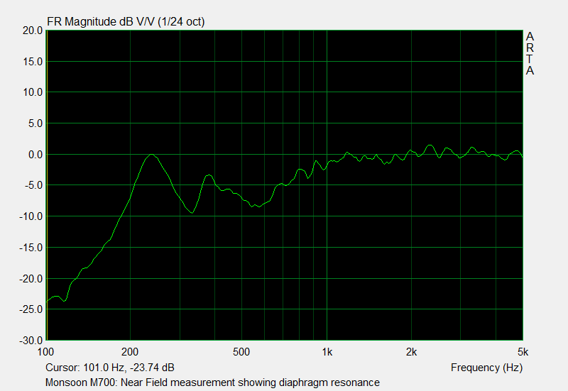

I also attached a near field measurement showing two diaphragm resonance modes that I thought you might find interesting.

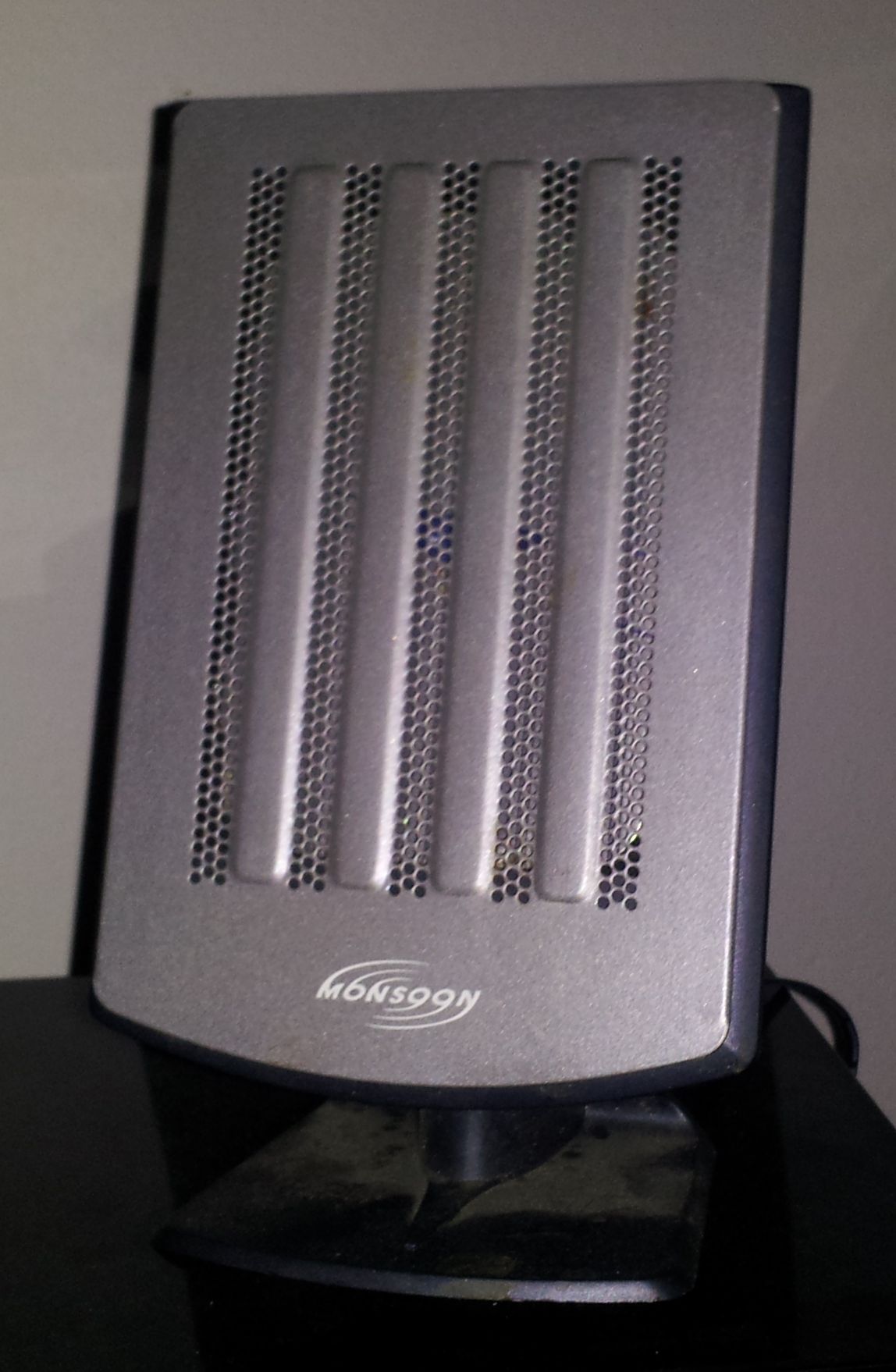

Just so everyone knows there a three different types of Monsoon driver in this general configuration. The first generation is in the MM-1000 , the second in the MM-700 ( straight sides) and the third in the MM-702 (wavy sides) this is the version that VMPS used in their speakers.
Andrew

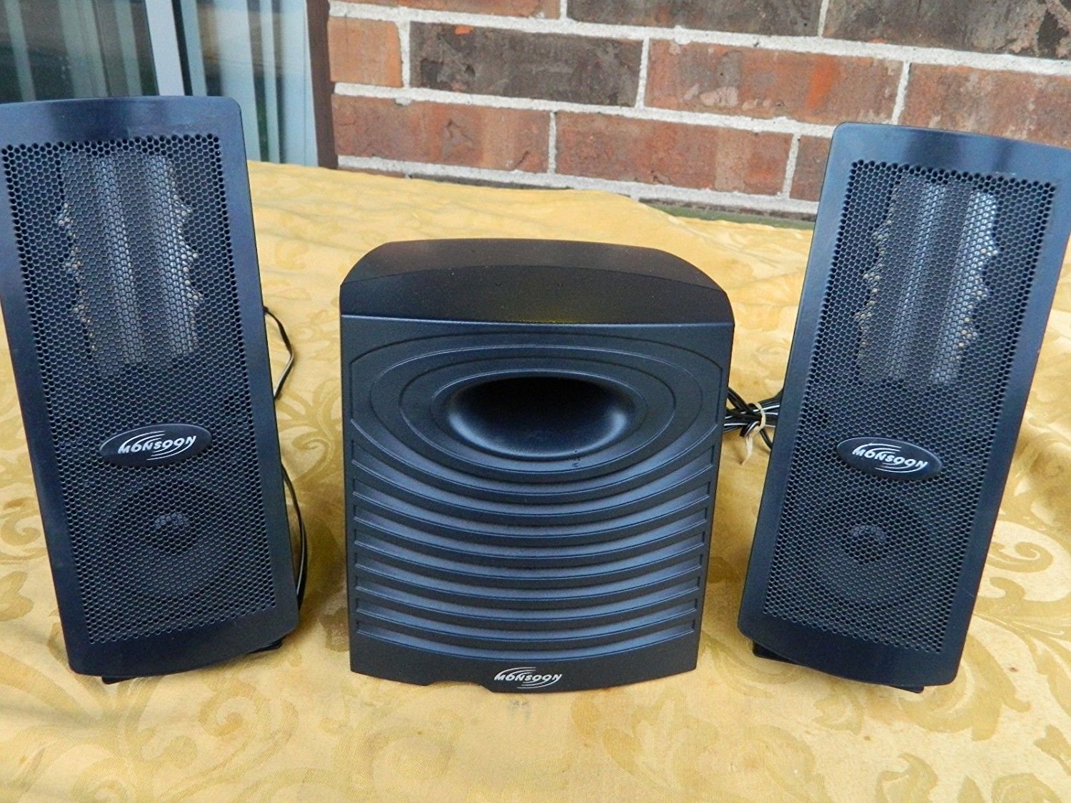

Add the MH-502 and the PM-9, and that makes 5 versions.
I think both of these use non-plated magnets, so should not have a problem with corrosion of plating leading to buzzing. PM-9 is also held together with screws for simple disassembly if needed.
I have recently acquired a pair of PM-9 and looking at redesigning the accompanying bass section for them.
