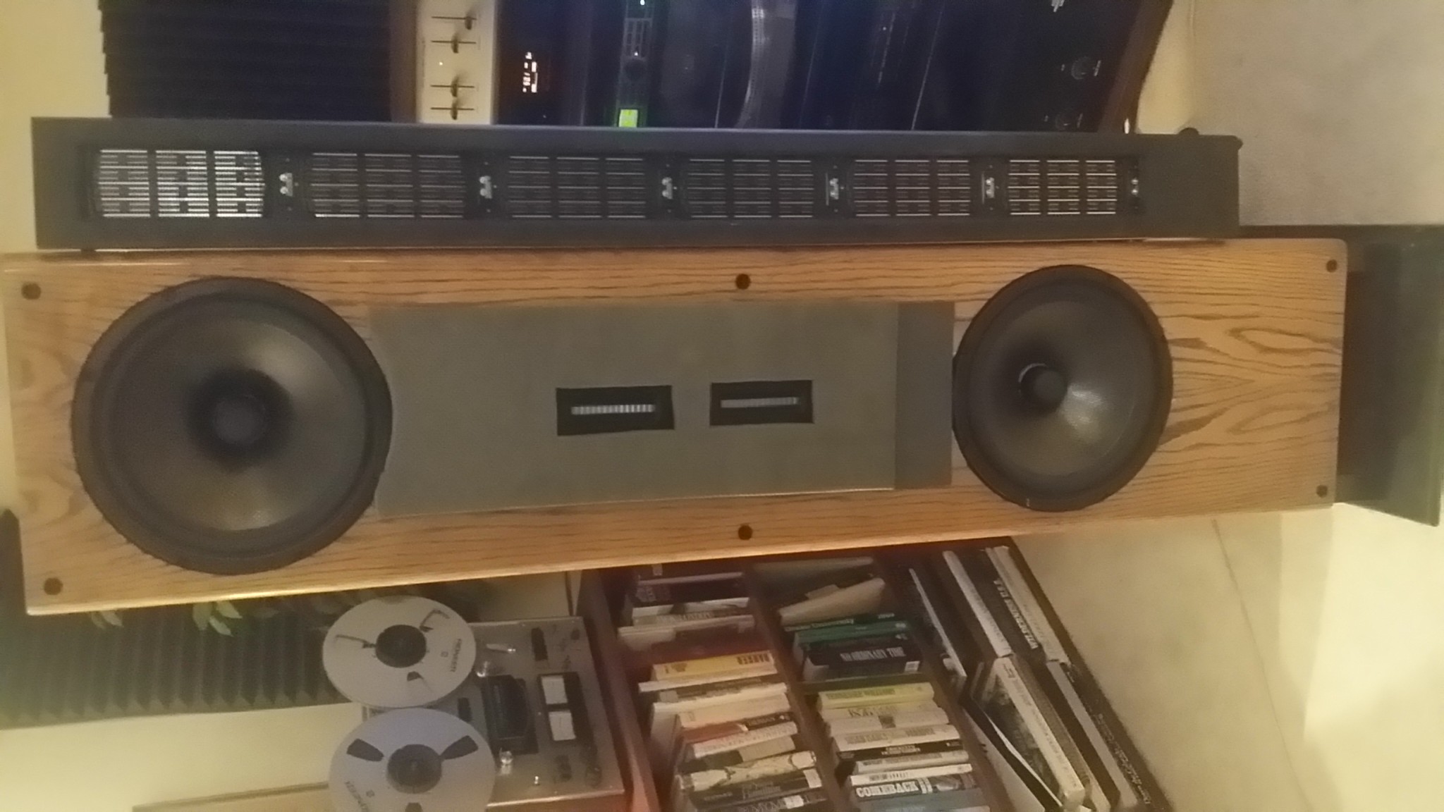

Have been using the 700 planars as mids for about a year now. Lovely for mids active minidsp
My Monsoon-midded monsters sound terrific! They're only doing 238 to 1,980Hz (LR4 with a DCX 2496) so they're not asked to do too much.

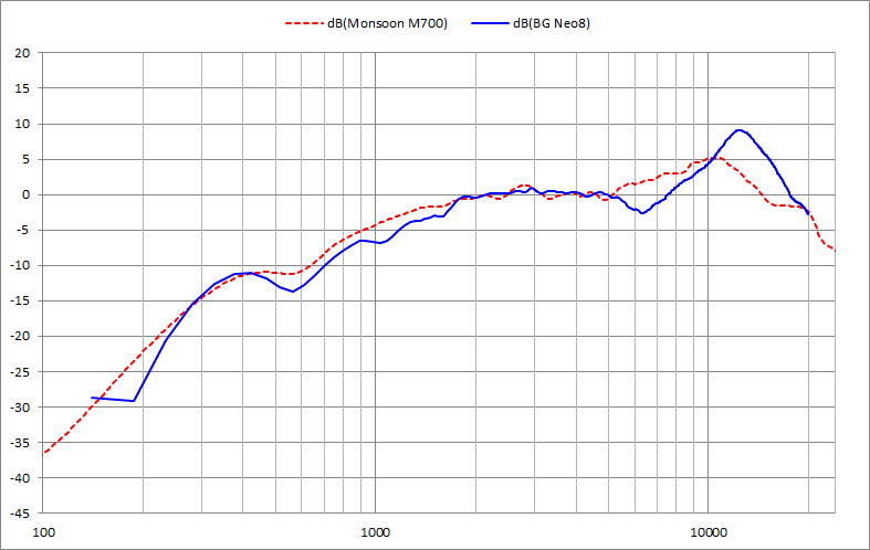

I'm still a bit puzzled by the CSD... looks quite different from the BG Neo8, which decays quite rapidly.
I am surprised to see no hint of a cavity resonance which is pretty much a "feature" of all push-pull magnetic planars. Is the 5dB EQ you mention hiding it perhaps?
I’d be interested to see a near field and/or 1m measurement without the EQ in place if you have the time and interest.

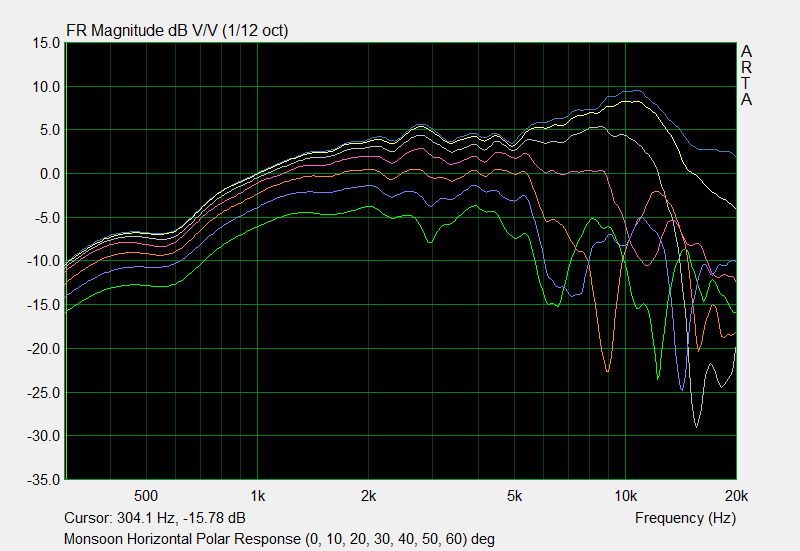

Attachment #1: Polar response data was measured @ 1.5m with a 4mS window. You can see that the M700 does have a cavity resonance like most push-pull magnetic planars.
Attachment #2: Compared to the BG Neo8, the cavity resonance isn’t as pronounced(due to the higher %open area of the plates) but is a bit lower in frequency
Attachment #3: The 30deg off-axis data seems to line up pretty well with response data posted at the beginning of this thread. Perhaps that is why the cavity resonance wasn’t noticeable.
Attachment #4: CSD plots for on-axis and 30deg off-axis looks very similar to what I had seen with the Ne08. Not sure what the cause of the hashy CSDs posted at the beginning of this thread.

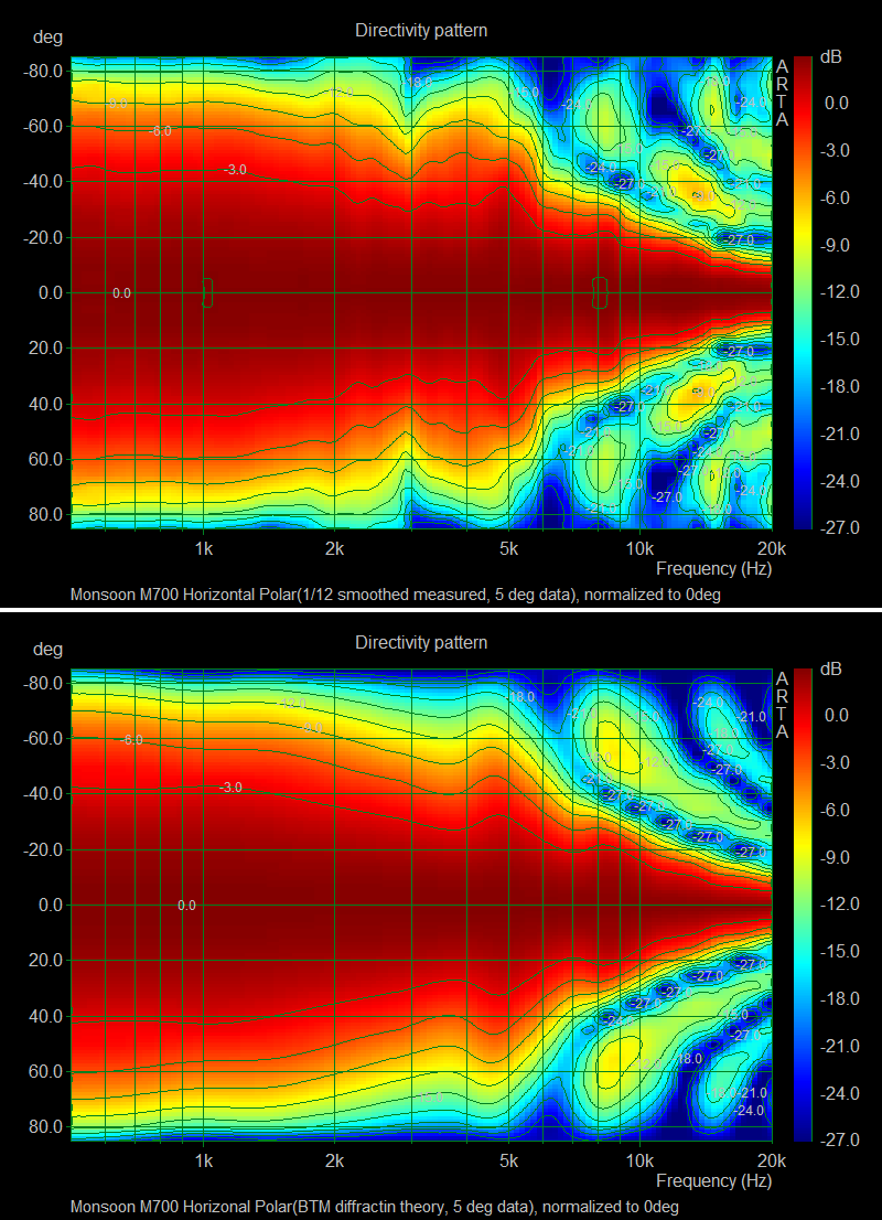

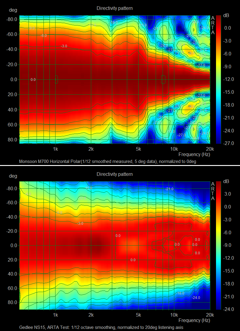

Attachment #5: Polar map using data measured every 5deg, compared with theoretical polar response for an ideal rectangular piston.
If interested in theory, see:

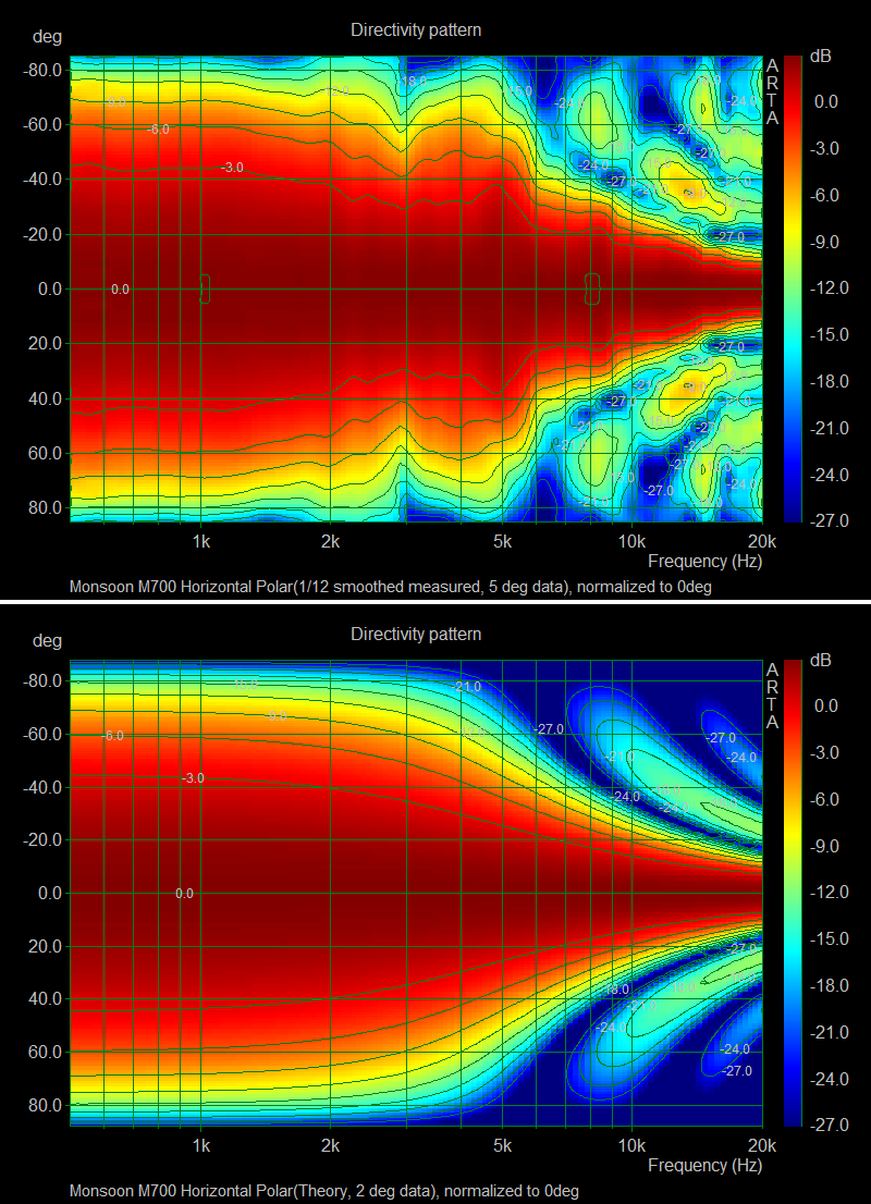

Attachment #6: Polar map using data measured every 5deg, compared with theoretical polar response for an ideal rectangular piston adding diffraction from the metal frame using BTM diffraction method. Including the diffraction calculations does a surprisingly good job of matching the features of the measured polar map.
If interested in BTM diffraction method, see:
Baffle edge diffraction with dipole radiation

The polar plot displays at a glance the response at all radiation angles relative to each other. This allows better understanding of the tonal balance of the sound getting to your seat directly, and via room reflections. If the source has non-uniform coverage or uneven response off-axis(and you aren’t listening in an anechoic chamber) it will affect what you hear at your seat in a negative way. You might consider revisiting Part 2 of the Toole book. Also, as we’ve discussed in other threads, if the beaming is excessive like with 12” wide ESLs, you will also have to deal with the issue of small head movements changing the tonal balance. I don’t think the M700s fall in that category, although they would need to be aimed at the listening position and would not be good for sharing a movie soundtrack with the family on a couch.…I'm not sure how to understand polar plots. You can't hear beaming. You hear what gets to your seat…
Beaming from large, flat, uniformly driven radiators result in directivity increasing progressively with increasing frequency. This is not controlling the direct sound in the manner that Geddes recommends. In fact when I have shared data for ESLs with polar maps like this his response has been …”why would anybody design a loudspeaker like that?” Attached is a comparison with the Geddes NS15(New Summa). You can see that the NS15 has nearly uniform coverage over the +/-45deg wave guide angle. Beyond that, the frequency response continues to stay flat, just reducing in level.If you follow the Geddes argument, you'd want stringent control of the direct sound propagation (like using his waveguide treble).
