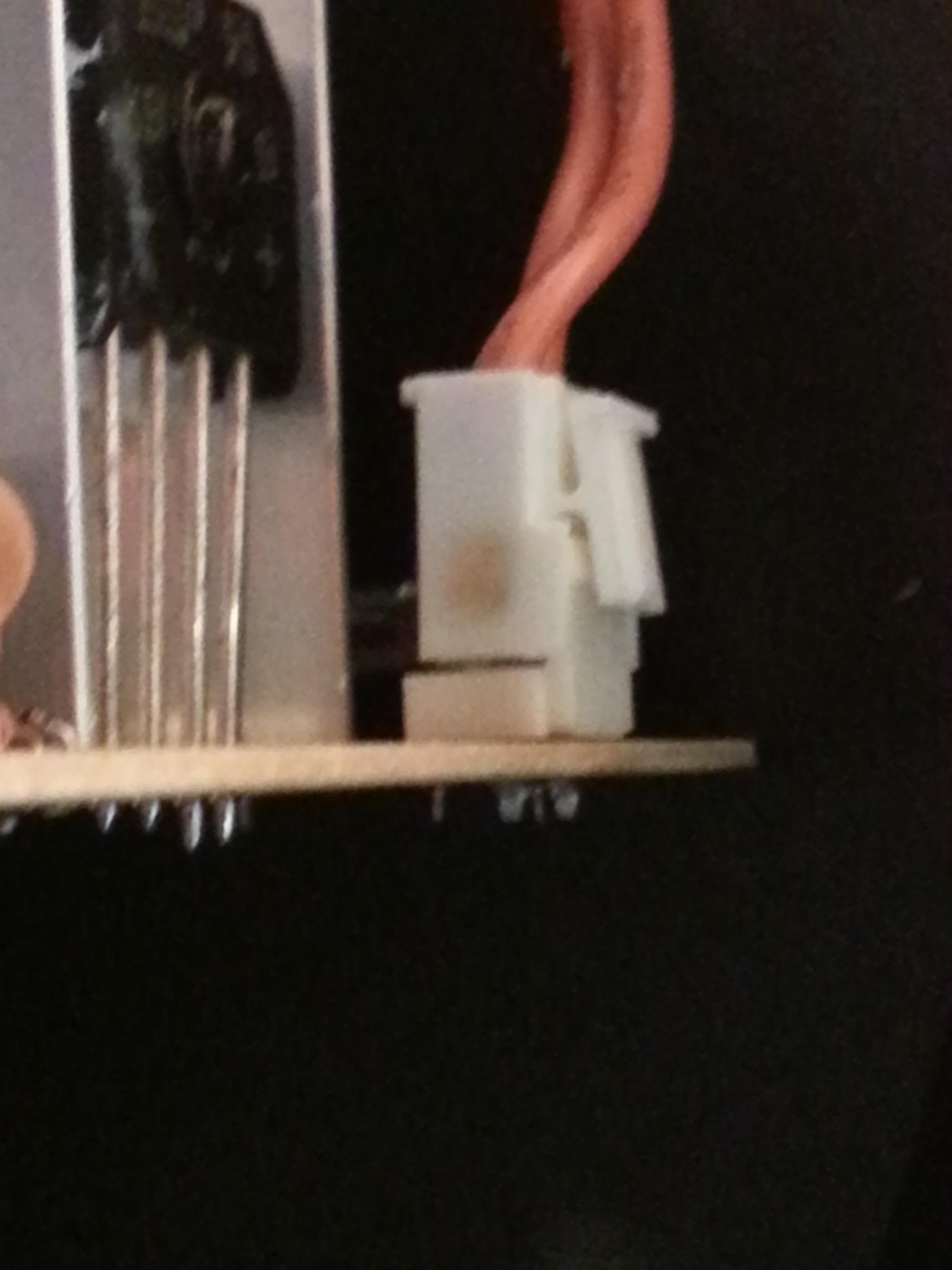

I too have the Monsoon Planar Media 9 system and the problem I'm having is as follows: When I power them on, after a minute or so the power and power LED starts to fade away until the unit is off. By accident, I discovered that if I bump the sub-woofer, or lift it 1/2 inch or so and drop it flat, the power returns for a bit. Then the issue starts all over again and eventually they never power on again until a few hours later. I opened the system to see if there was anything obvious and the only thing I found strange is that the white plastic plug from the transformer has a small burn mark on the side closest to the center. The fuse is OK and everything else seems normal. So, could anyone please give me ANY idea as to why/how bumping or dropping the enclosure could bring it back to life? What component could be sensitive to vibration? Any help would be appreciated, thank you in advance.
PS: I attached a pic of the plug and you can see the burn mark

Is it a burn mark, or is it discolouration due to dirt/pollutant attraction to the white plastic. Hard in a picture to get the "full picture".
If its burning then the plug should be snipped off, the socket removed and the leads safely hard wired to the PCB.
