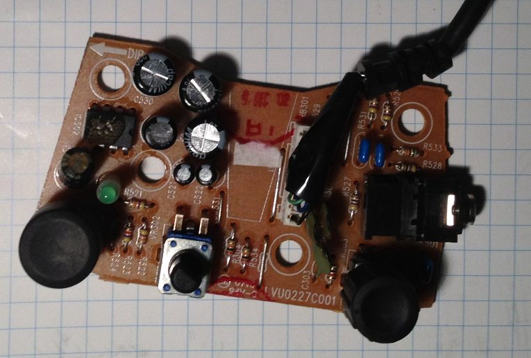

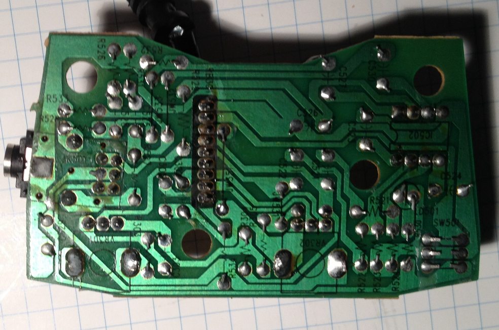

Yup - took mine apart last night and there's a lot more in there than I expected. Lots of passives and an 8pin IC (dual op amp?)understand; hopefully planet10 can hook me up🙂
Photos later
Top and bottom of puck

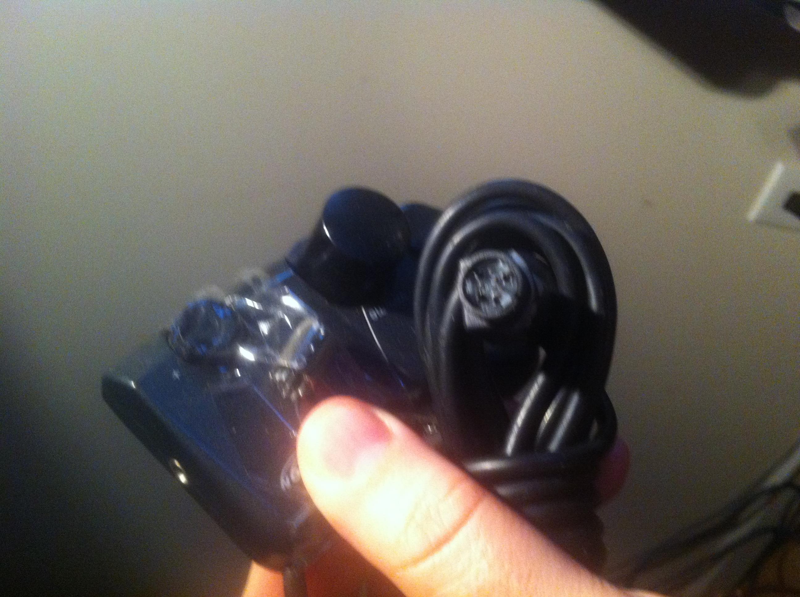

the puck I have is fine it is the other end which plugs into the sub is destroyed
Jesus, Mary and Joseph!
Ah, well, that'll be the problem then!
The connectors are a dime a dozen MMSC 8-pin Mini–DIN Connector. If yours is completely banjax I can buzz out mine from the connector on the PCB to the mini-DIN
