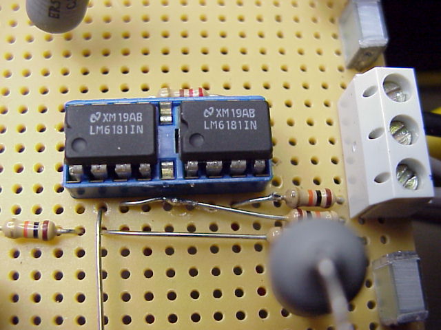

Netlist said:
I'll try the breedboard one of these days with MJ15024/25.
I populated a breedboard with 2 MJE15030/31, 2 LM6181.
Connected everything properly, but just to let you know:
doesn't work:bawling:
The whole setup takes a huge amount of current, at +/-5V
it eats about 6A.
/Hugo - not giving up, yet.

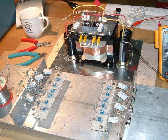

Progress 5
Now the Monolithic SuperSymmetry amp is fully ready for the experiment. 🙂
I have one dummy load of 8-ohm 80W (10-ohm||40-ohm), one oscillator (sine and square curves) and one oscilloscope. Honestly, however, I have never used these tools before. Therefore, your help or advice would much appreciate. First of all, what should I check...? (I am reading Pass articles, The 40W Power Amplifier and The MOSFET Citation 12, to get some ideas.)
JH
PS. I do not recommend you to make the amp open to unprotected space as shown in the photo. It could be a dangerous lethal weapon. :darkside:

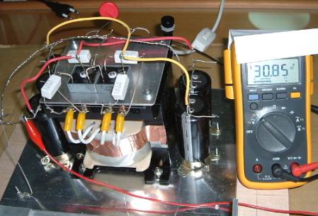

Measurement 1
PSU works fine. Both channels are measured. Transformer is EI type of 300VA with 2x12V 50/60Hz. I hear no transformer noise--surprisingly good quality compared with its price of about USD 25. Bridge diodes are of 25A 400V. Between the transformer secondary output and the bridge diodes, I arranged 0.3R 5W resistors. Four PSU electrolytic capacitors are of 22,000uF 35V 85degC.
JH
PS. Thanks for the info, Rookie. Since the 741 is already soldered into, I will see what happens from it. Later, I might have chance to replace it with others.

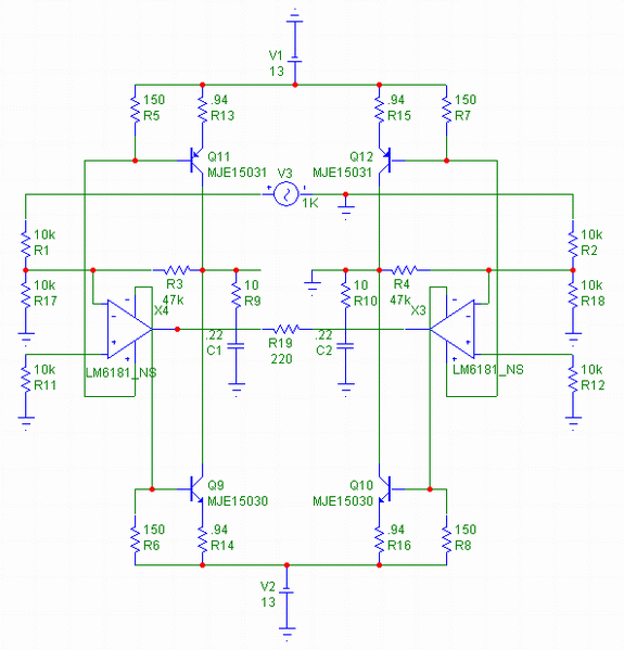

jh6you said:
I would try the reduced R5, R6, R7 and R8 from 2K to about 100. I presume this would reduce the idling current across the power transistors and accordingly reduce the heat.
JH
IT WORKS!!!!!
:nod: :nod: :nod:
I will let you know how the (semi final) setup is done in a moment.
If you succeed we will have 2 different new amps born in 1 day.
/Hugo - very happy now! Donald Fagen playing on a Mono Monolithic SuperSymmetry( tm) amp with Current Feedback (MMSCF) :happy1:

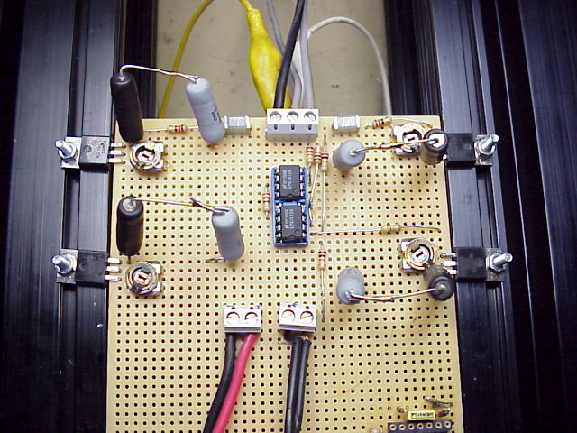

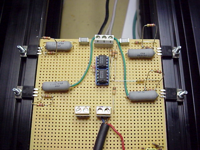

So, here's what I’ve done:
Replaced R5, R6, R7, R8 with trimpots.
All are set between 120-150ohm. (Thanks JH)
R13, R14, R15, R16 are now 0.94ohm (2 x 0.47 in series)
Connected the negative input to ground, as well as 1 speaker terminal. (R10 & C2 are out of duty now)
Without the speaker terminal connected to ground the gain is very low.:scratch: (don't know if we still have the originally intended amp here?)
Removed the 2 100ohm resistors to ground at the outputs.
Still got 0.4V DC over the output terminals (with or without resistors).That's the lowest value I can get for the moment.
For 2VAC sinewave in I get 9,2VAC Out at 8ohm before clipping.
The total current draw is about 1.8A.
The first impression when listening is good, but not as good as the ZenV4. The ZenV4 really spits out the music. A feeling I haven't with this amp. Still very detailed, but with less deep bass then ZenV4.
All feedback highly appreciated.
Thanks everyone, and of course, once again, Mr. Pass.
