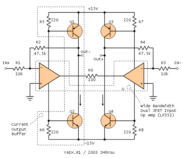

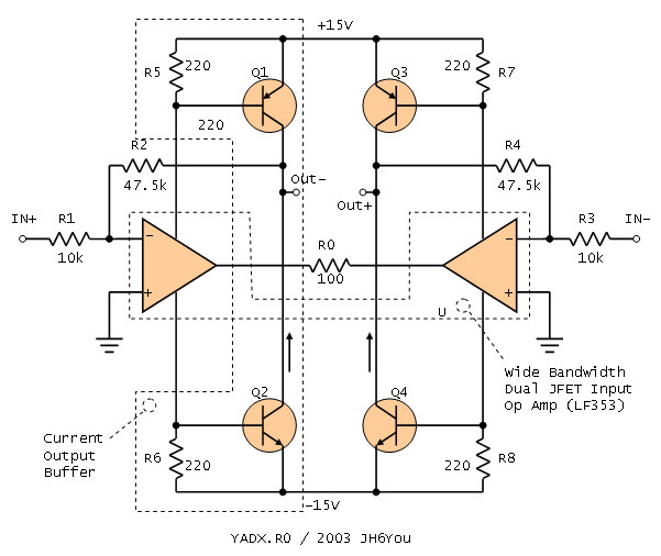

Here is my struggling to the puzzle. I like to use LF353 (wide bandwidth dual JFET input op amp). Since it is a low power op amp, I need external current output buffers with complementary power transistors, which allow high current swing to the load. R1 and R3 are to set input impedance. R2 and R4 are to set voltage gain. R5-R7 are to inject base current to the power transistors. Then...???
Please kindly give me some help about the proper power transistors and R5-R7.

Regarding this method of driving the output transistors by
sensing the supply current to an op amp. It keeps popping
up in threads now and when, and I think it is used in a
Velleman power amp, but is it really a good idea? Intuitively
it seems that the supply current to the opamp will not be
very linear wrt. the input signal, so what is the supposed
advantages of this method?
