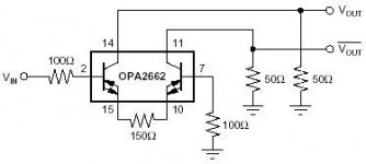

Originally posted by Nelson Pass
I haven't yet run across an example of a monolithic higher power op amp using current feedback on the market, but there is no reason that one would not exist.
I'm not sure there is a market - at least not a large enough market to justify an IC development. Current feedback opamps have generally been designed for leading-edge bandwidth applications (GHz), where parasitics can limit the stability of voltage-feedback opamps. As new voltage-feedback opamps come out on newer processes, without stability problems, they seem to supplant the current-feedback opamps in those applications.
The “current feedback” appellation is confusing; I believe the correct term is “operational transconductance amplifier”
For (low power) monolithic implementation see TI/BB OPA2662 and the app note sboa047.pdf “New Ultra High Speed Circuit Techniques with Analog ICs”
See fig 10 “Single Ended-to-Differential Line Driver” in the 2662 data sheet, add 2 feedback resistors as has long been done in differential output amplifiers and you have the supersymmetry/active X:
trying to attach .jpg:
Indeed you do. Have you previously seen the addition
of symmetric feedback to this circuit, and if so, where?
BTW, the polarity of Vout is inverted from Vin in the
diagram posted.
