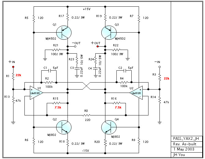

Now I have 30Vpp from 14V rails ( which means OPs rails are 9V ) without oszillation.

jh6you said:The pre, BOSOZ, is set with about 10dB gain while this power amp has approximately 24dB.
I informed that the power amp had 24dB gain. It was a wrong info. The actual gain is 4, i.e. 12dB (with R1 and R3 of 22k).
The latest R1 and R3 are of 22k, and R15 and R16 of 7.5k.
With the lowered R15 and R16 to 7.5k, the measured square waves remains clean until the output voltage swing reaches 34 Vpp. The 7.5k is for an assured boost of AC current necessary for 4 ohm load.
The output power of the amp is 18W for 8 ohm load, based on the clean square wave results. I did not measure the power for 4 ohm load, but I presume as greater than 25W.
JH
Until now, I have put my effort on the matter of loop gain and stability. As a result, the amp works well to my full satisfaction, without giving any trouble.
By the way, I newly introduces R23, R24, C3 and C4. These are not for the amp's stability, but for the cure of the sound of too much apparent treble. The amp has given somewhat overemphasized cymbals and "s" and "ch" sounds in vocals. The new components works for the attenuated bright treble.
I think I have enjoyed the technical experiments and development enough. I will put these aside. It seems to be the time for me to return to the music and movies. (Today, I enjoyed Welcome to Collinwood. I liked it very much. Whhahaha...) O, this however does not mean that I have given up expectation of your helpful tips about sound improvement if you see anything better...

jh6you said:By the way, I newly introduces R23, R24, C3 and C4. These are not for the amp's stability, but for the cure of the sound of too much apparent treble. The amp has given somewhat overemphasized cymbals and "s" and "ch" sounds in vocals. The new components works for the attenuated bright treble.JH
JH,
is the output the right place to make a frequenxy compensation ?😕
I never experienced any frequency response problems like too many highs

As you know well, the use of Zobel network, connected from the amplifier output to earth, is well known in power amplifiers. I use 10 ohms and 0.22uF, which provide the 3dB frequency of 72.4kHz. I could change the capacitor value or entirely remove the network—case by case with respect to speakers and cables.
There is no technical problem. I just do not like "s" and "ch" sound in vocals and so want to cut them off.
JH

JH,
but you could do the same on the amp's input ?
What has "s" or "ch" got to do with frequencies at 70 kHz ?

I think JH is searchin' a more " euphonic " effect listenin his preaferred music , since I am convinced that "s" and "ch" are not eliminable. This effect is caracteristic in the Audio region of the spectre. Do the same at the input.....: 70 Khz is beyond this effect... and do not depend from this kind of filtering .
I admit your comment.
I should have said that Zobel network is mainly to dampen Q of the output circuit (http://www.lcaudio.dk/com/zp2opg.htm). Probably, I should live with the "s" and "ch."
JH

Excessive sibilance in X circuits usually means too much
feedback. I suggest lowering the loop gain, or throwing
some away with resistance to ground at the "-" inputs.
