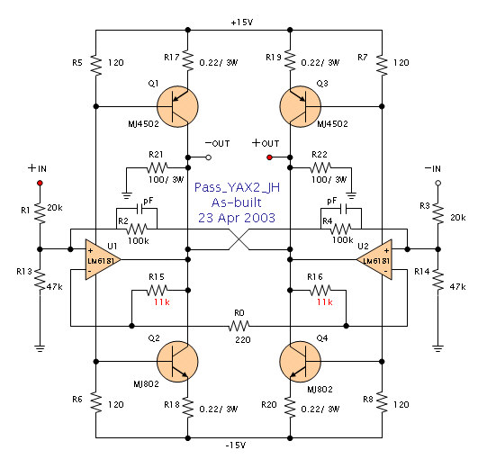

Do you remember?
I informed you that the sound got a bit worse when I increased the input resistor from 10k to 20k. I felt that the sound seemed to be suffering insufficient current supply from the booster. That was why I measured the amount of AC current flowing through the emitter resistor.
At last, I increased the ability of the AC current supply by reducing R15/16 from 22k to 11k. Hmm...the sound got better, without losing the clean square wave forms measured last time.
Now, I feel that the sound comes out more easier.
JH

JH,
Did this change reduce the system gain, iow you now have to increase volume a bit to get the same loudness as before?
At any rate, you realise you throw away about 3dB of gain for nothing with that 20k-47k input attenuator, right?

Yes, I increase the volume a bit. Anyhow, I have no problem with the loudness at all. The pre, BOSOZ, is set with about 10dB gain while this power amp has approximately 24dB on the balanced input mode.
No, with 20k-47k I get better and cleaner square wave measurement results with which I believe that the amp is stable.
JH

The reduction of R15/16 to 11k affects the sound much. I am impressed on it. I want to have further experiment with further reduced R15/16 if it is possible without losing the stable square wave forms. But, at the moment the components around the girly-chips are arranged too compact to do that. Soon I will build one more baby. Then, I will have a chance of the further experiments. I am getting good music, real DIY enjoyment and useful lessons. 🙂

Understand. If you go even lower than 11k, and you start to get into instability country, you may want to parallel the resister with a couple of 10s of pF's.
Jan Didden

Thanks, Jan. I will try it in case.
JH
