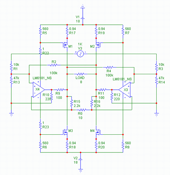

Pulling some initial values out of a hat:Netlist said:Any idea of values of several resistors?
I've been trying to make this circuit work on the sim, without any result. For R5 to R7 I took the classical 100-200ohm values. (With MJ15030/31. But no way to find out what values to put at R19/10/11/12/15/16.
R13/14 47K
R2/4 100K
R9/11 100
R10/12 220
R15/16 2.2K

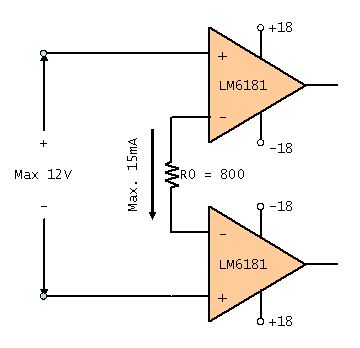

In a current feedback op amp, the +input is equivalent to the Gate/Base of one half of the diff pair, and the -input is equivalent to the Source/Emitter.
So what we have been doing with these CF op amps is simply emulating a diff pair. The value of R0 could be 0, but it must be some value, otherwise the mutually symmetric error sharing cannot occur.
I know, it seems like a lot of trouble when you could just as easily build a discrete diff pair, but I didn't want the gain-clone guys to think they could have all the fun!

Nelson Pass said:
Go back to the original SuperSymmetric circuit, and you see that when it is implemented as a differential pair, the crucial connection is between the Sources/Emitters of the diff pair, and that there is symmetric feedback to the Gate/Base of each.

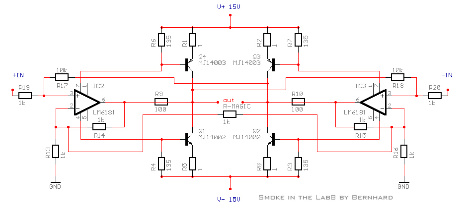

Hi, all
Just to let you know it works!!!
And it goes loud!!!
I managed to make the circuit work rather decently.
But...a warning to you builders. There was "smoke in the lab"!
Be careful when trimming R5/6/7/8.
I just blow my opamps! In the previous design, I could trim plenty with the base resistors without harm to components.
This is not the case with this circuit!
The "Magic" resistor is also a dangerous 'toy'.

Great! I knew we would get it working eventually...
By the way, it was not my intention that you use not use emitter resistors on the bipolar devices. I would ordinarily recommend some large fraction of an ohm, and of course R5-8 should be resistors + potentiometers.
Another point: there will probably not be enough drive from something like a 6181, and for real power you will have to consider darlingtons or Mosfets.
Also: R9-12 values can be lowered to get more drive from a 6181, and this will get you more drive also.

Ok, I swapped the OPs to girly-man-chip, - still works. 🙂
Precautious made the connection of the wires of the magical-1k-resistor to the wires of the inverting inputs - also works, but with more gain. 🙂
But I need the 100ohm resistors on the OP output, if I short them, the PSU shuts down.
It seems, the LM got higher quiescent current as the NE5534 thus bias increases, my heatsinks are warmer...
Leaving out the 100ohm seems to further increase bias - which overloads my PSU.
With a more powerful PSU it should not be a problem. 🙂
Also due to my PSU Problem, bias current is only 0,35A, my 135ohm resistors should be 270ohm.

I use +/- 15V supply, which are lower than the absolue maximum rated supply voltages of +/-18V. Please note that I have posted the sketch about the girly-man chips to remind of the maximum ratings.
By the way, your circuit looks very good!!!
JH
My girly-man-chips stay cold.
The resistors in the powersupply lines of the girly-man-chips (bias setting resistors) will limit power dissipation enough.

This could be a hesitating first attempt of a mosfet version.
R22/23 are only there to measure current in the sim.
/Hugo
