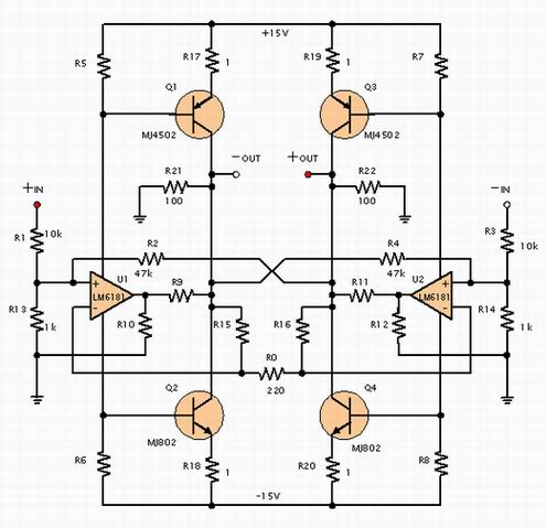

OK, I worked up a probable schematic, which you can find at www.passlabs.com/temp/YAX2.tif in a compressed tiff format.
In this schematic we are using two "current feedback" op amps much in the same manner as we began in this thread, but with current boosters as later described.
R0 is the "magic" resistor which creates the SuperSymmetric connection. R9/R10 and R11/R12 are low impedance voltage dividers so the outputs will swing voltages higher than the op amps output.
R15 and R16 can be used for absolute DC stabilization, as are R13 and R14. The gain should be R2/R1.
R2=R4, R9=R11, R10=R12, and so on.
This circuit has not been tested or simulated, only envisioned.

Until now JH and I were using the inverted input of the opamps.
In your new drawing, the uninverted is used, and R2/5 are tied together, R4/7 not. I assume R4/7 is correct.
Another problem I encountered was the dividing of R0 into two halves and connect the centerpoint to ground to make things work.

grataku said:Nelson,
I think there is a mistake in the schematic...should R2 be connected to R5?
According to my experiments with VFB op amps, it seems that the op amp outputs must be directly associated with their inputs in a way or another.
After all, to go with YAX2 this time, I ordered CFB op amp, LM6181. I expect the delivery in 10 days. Attached below is the circuit of YAX2 of Nelson Pass, with additional emitter resistors and the output-to-ground resistors. This is made mainly for a better communication.
JH

Thanks JH,
Any idea of values of several resistors?
I've been trying to make this circuit work on the sim, without any result.
For R5 to R7 I took the classical 100-200ohm values. (With MJ15030/31.
But no way to find out what values to put at R19/10/11/12/15/16.
Looks like you also have no clue?

JH,
This looks exactly like my design in post 252 except addition of R0 between the two inverting inputs of the OPs. 😉
I believe R9 R10 R12 R12 R13 R14 are not essential for function, but make the circuit more difficult to survey.
Also I wonder if R0 is necessary because ( the
hides in the detail ) the
connection between the two inverting inputs of the OPs is already made by the load.
But I could miss something...
May be Nelson likes to give his statement.
And now - what ?
I could solder in that R0 and plug in that LM6181.
If the circuit does not work anymore with this modification, I will know that was the wrong direction.
But if it still works, how to know wether it is supersymmetric or not, and how to know wether it was supersymmetric or not before ?

The main difference between your and Nelson's circuit indeed is R0 and the way you connect the inverted inputs.
BTW, got some results on the sim.
Can you tell us some more how you found your resistor values?
Or was it also "by accident"? 😉
