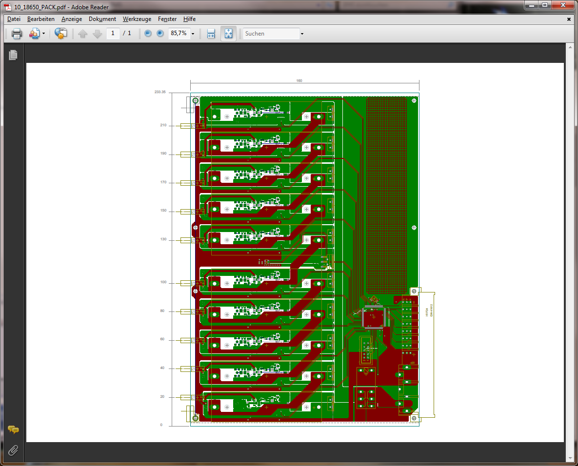

Today I will define the batteries: LiFePO4 (2<Ubatt<3.6V) with BMS (ATMEL Tiny µC) and CC/CV µC based charger.

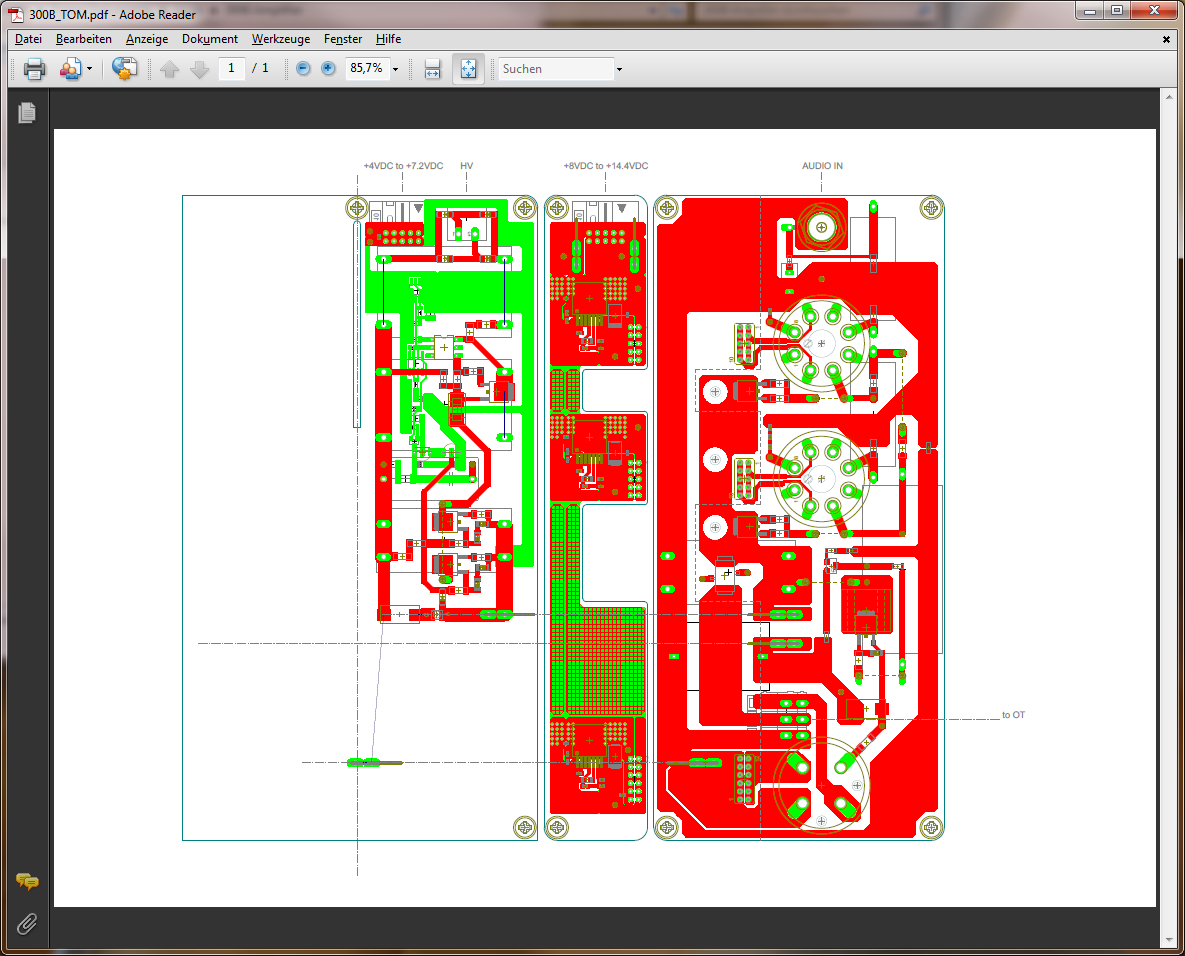

Here the bloc diagram for the mono 300B SE amplifier.
Tom: the heathers needs not more then 3A. The LiFePO4 3.3V@40Ah are garantee for 2000 cycle of charge, and discharge at 0.3C, and are developped in the USA for automotive usage!

I suggest grounding one side of the 300B filament and taking the inter-stage tranny off of ground. Feed -85 (ish) volt to the interstage trafo, thus, biasing the 300B. This would allow you to skip the cathode cap.
If you insist on having the cathode cap, I suggest running it from the cathode to the B+ supply a la Loftin-White as it shortens up the signal path considerably on the primary side of the OPT. You'll get measurably better performance.
Generating the bias tap would be trivial on your flyback trafo.
I don't see a point of battery powering the filaments. You can get very clean power with one of National's LMZ12xxx SimpleSwitchers. Been there, done that, have the T-shirt (and the good results). The thermal mass of the filaments is more than enough to ensure that any minute variation in the output voltage are averaged out.

I am reading a lot of articles, good and bad ones. No preference today. I found a nice design from Elektra, but really objective? Was very interesting before I read the detailled analysis from a experienced developper. It is like monopoly, return to the beginning.
I will draw a new design for the 300B amplifier. I am waiting for comments and I will start this way.
I need a cheap but good design to test the battery powered heather idea. Anyone an idea?

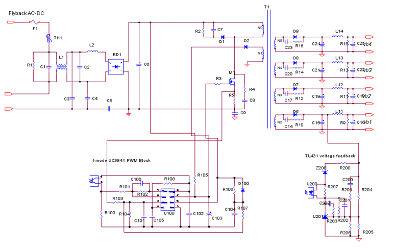

Universal SE SMPS: one possible solution!
A 400W PFC board is available from Fairchild and the transformers and chokes are very easy to built.
The Flyback for the heathers and the bias supply is calculated (for up to 4 driver tubes and up to 2 end tube with LMX regulators, thanks Tom, and up to 211 or 845, badly there is no LMX regulators for that supply current; also the 0 to -300VDC max. 7.5W adjustable bias supply); transformer is a little bit difficult, but with practice; 92% effectiveness.
The half-bridge DC/DC converter needs more attention, then it will deliver up to 1300VDC. Four windings on EE42 core for a pair of 2A3 or 300B, 45, AD1, 211, 1605, 845... 92% effectiveness.

I am very happy in real application (military) with unbreakable LiFePO4 batteries. I will build the Bias voltage supply, the heather supplies with this one. The first sketch on paper is ready and the challenge is only the mangament of the costly battery energy.
... I forgot, the management is doing by a micro...
The LiFePO4 batteries, see at...

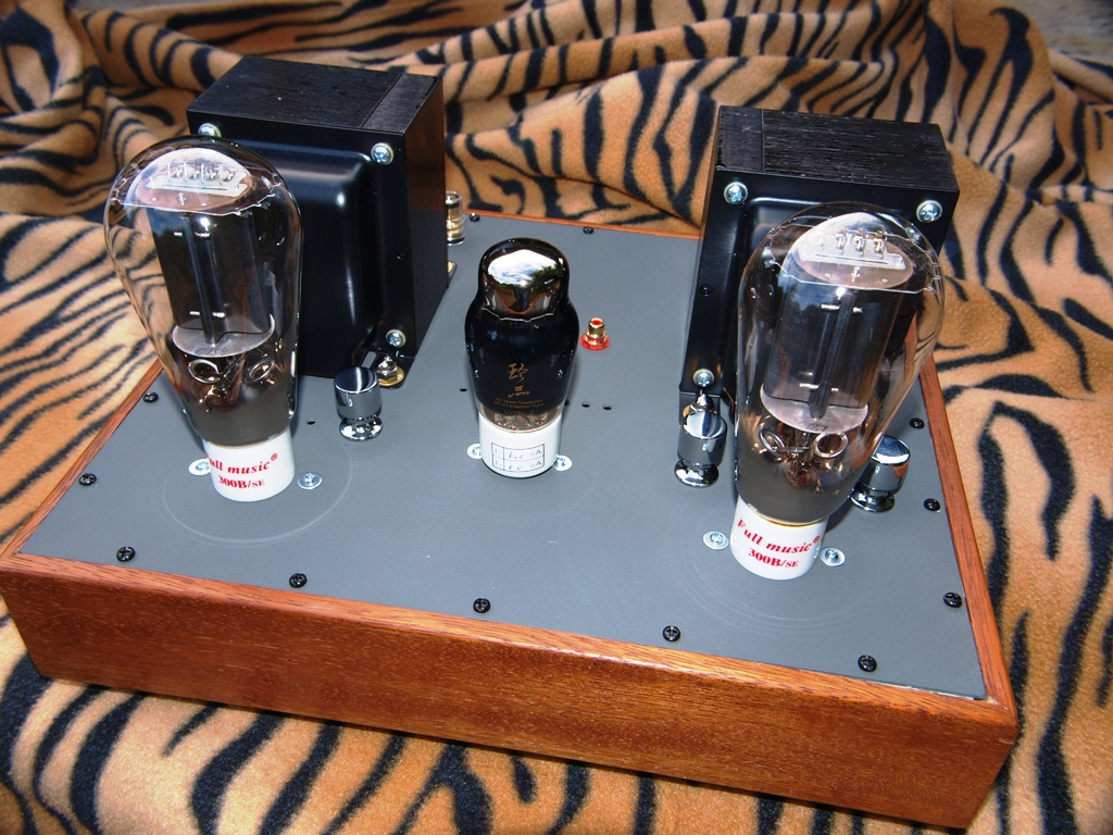

TJ Full Music 300BSE/6SN7 expensive amp
This amp has taken nine months to build. It was design by Suncalc on the diyaudioprojects forum from the ground up based on three criteria I stipulated: 1-two stage 0NF, 2-6SN7 and 300B tubes with tube rectification and 3-Single ended. Most of the main components were selected by the customer I built it for: TJ Full Music 300BSE(RRP $1200), 50 year Treasure 6SN7, Audio Note Silver foil caps, Mundorf M-Tube poly filter caps, silver wire in the audio path. Other components were my selection. The bass is extended, full rich mids and treble bright and extended. Very expensive to build and a long time in the making but really worth it. retro-thermionic
The skills for the High Voltage Supply:
- 6U 19 inch rack,
- 10 to 15 LiFePO4 boards with 10 18650 batteries and µC management,
- 600W PFC SMPS CC/CV charger,
- µC-Mainboard with management and TFT-Touch visualisation.
- and interconnaction backpanel.
Attached, the first printed circuit board for the battery board...
... and the 300B testboards avancement.
- 6U 19 inch rack,
